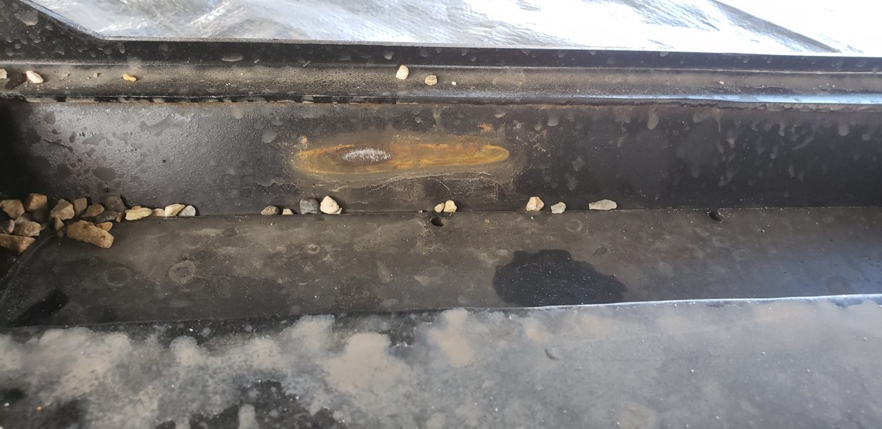

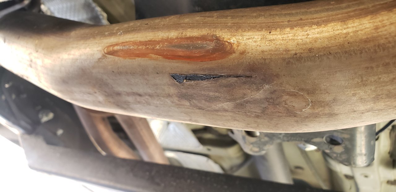

  6. Mar 21, 2021 at 10:00 AM
    #46
    Alberta_Taco
    Alberta_Taco [OP] Well-Known Member
    Sep 14, 2020
    #340734
    86
    Aaron
    2016 Black Taco TRD Sport
    1st Mod: installed Trifecta tri-fold tonneau cover 2nd Mods: removed air foil damper, decals and badges 3rd Mod: installed a Compustar remote starter (its Alberta people) 4th Mod: installed full set skid plates 5th Mod: installed rock rails Spring 2021: roof rack w/ LED bar & CB radio Summer 2021: hybrid bumper, winch & LED bar
    Update...
    Yesterday I went under the truck and removed the 3rd skid plate. As suggested by @CanadaToy the rattling was indeed the exhaust rubbing against the 3rd skid plate. You can see inside the skid plate where the exhaust was rubbing and on the exhaust pipe the paint transfer.
    With the 3rd skid plate removed the rattling has stopped.
    Now onto finding a local muffler shop to assist with the rerouting the exhaust as suggested by @3JOH22A
    Once I get pricing and the exhaust rerouted I will update this thread again.
    Also, I'll be talking to a buddy of mine whose a welder to flatten out the 3rd skid plate for reinstallation once the exhaust has been rerouted.
    I do appreciate everyone's assistance.
    Enjoy your Sunday.
    AB Taco
