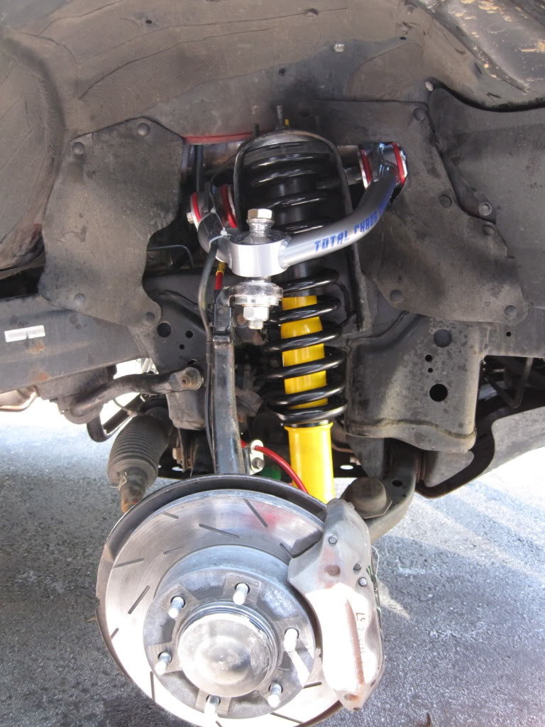

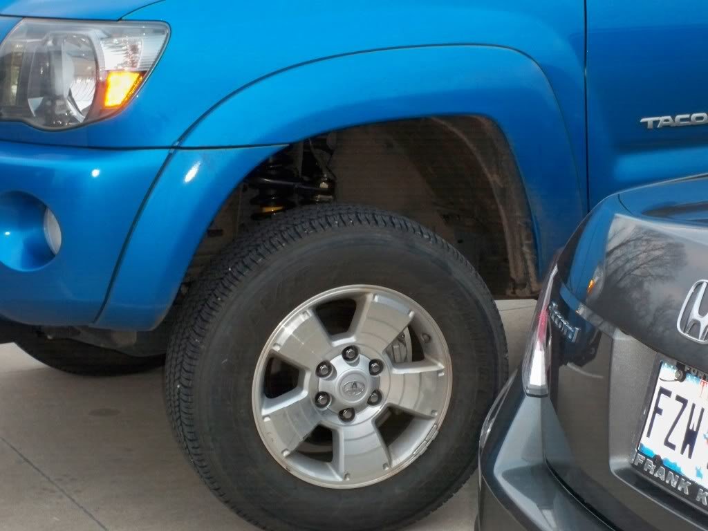

    Do you have any FLEX pics, or more pic of your tire in relation to the UCA? they look so skinny! :D
    ok.. I have the SilverBack's old stuff.. :)

    I will have to see if I can dig some up. The tires are skinny, they are 255/85...so a bit over 33" diameter and about 10.5" wide. There is plenty of clearance between the UCA and the tire (I am running stock UCA)

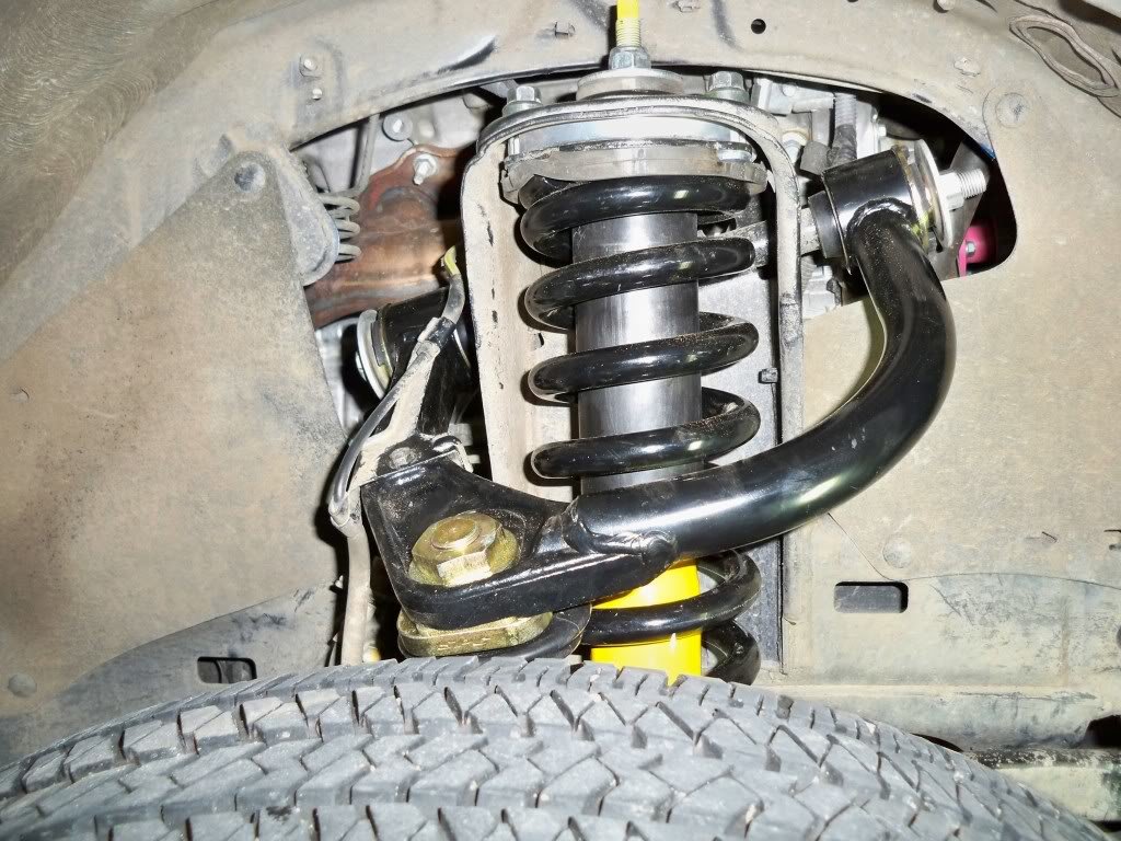

    Does anyone use Spidertrax with their OME lift?? I would like to see some pics of that combination!!

    over 4''?:eek: can I see your cv angle please!

    Trust me, you dont want to see the angle. :( It makes me want to puke whenever I look at them. They came down a little bit after the drive and sitting overnight with the added weight. I know its gonna settle, I just want it to settle NOW
    Edit: Just measured, settled 1/2", sitting at 40" now.
