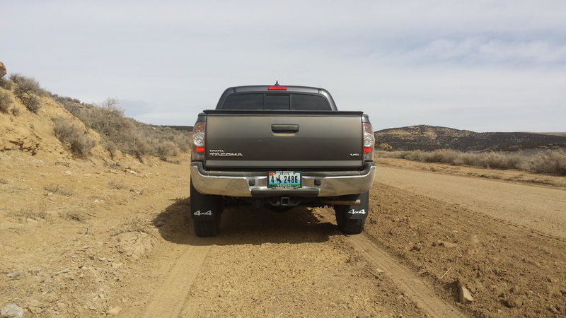

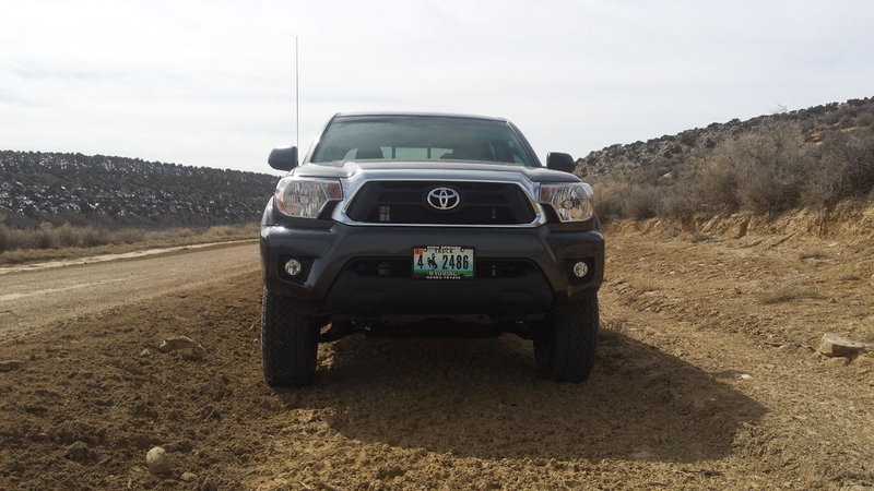

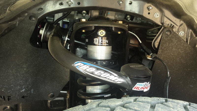

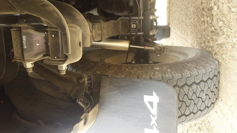

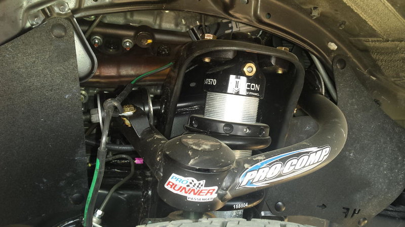

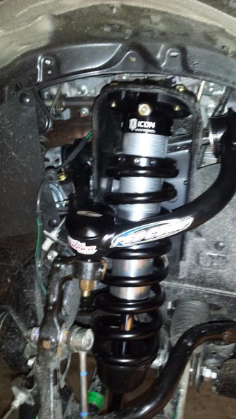

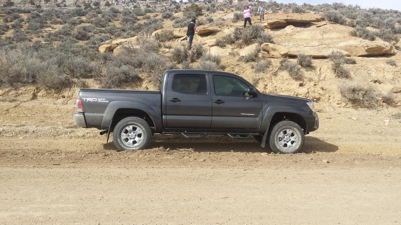

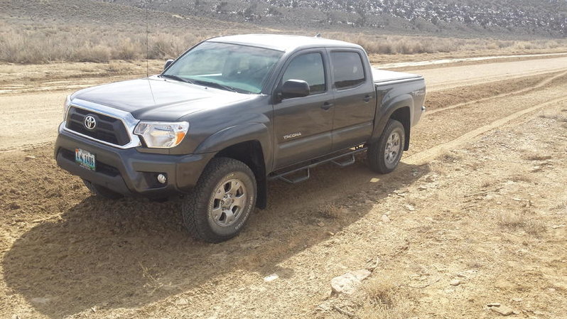

    I finally had a chance to take some pics of my Icon install with procomp uca's. enjoy:D

    Looks good. I have the same setup. Unfortunately, I have to wait until frame recall is done. :(

    Thanks. that sucks I hope my frame holds out.

    Looks great. Uniball cover is a good feature on those arms.

    I haven't seen too much review on the Procomp uca's. Do u like them? How much $$ did they set u back?

    That looks great . How much lift did you get ?

    The covers on the procomp arms were one of main reasons I got them,and the fact they were less than LR. The fronts are 2.5 ext travel icon and I put them in straight out of the box, they gave me 2 3/4" lift. In the rear its the icon 3 leaf aal with the overload removed and icon 2.0 shocks, it gave me exactly 1" of lift. It rides awesome,i hit some pretty rough washboards going about 60mph and it felt like I was going 20.

    Congrats, looks nice! How's the comfort going over bumps at slow speed?

    about the same as stock maybe slightly stiffer, but not much.

    looks nice. I have to replace my bilstein 5100s and I think I'll go ICON. I hit some pretty rough terrain and the 5100s have felt great but are at their ends. Do you think they will do well off road?

    otherwise good lookin setup.

    I have read that capping uniballs traps moisture which would wear them out quicker.

    scrap that sway bar and your G2G
