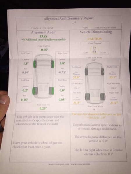

    Hey guys,
    I did a lot of searching over the last few hours and I can't seem to find exactly what I am looking for. So please take it easy on me if this has already been answered.
    I just got done lifting my 2015 TRD O/R. I went with Icon's Stage I with Ext Travel Coilovers and Camburg Ball Joint UCA w/ Moog Ball joints custom fitted. I have them set at what they came from factory and increased the drivers side to accommodate for the taco lean. I am also running 285-70-17 Duratracs.
    I took my truck to my local dealer and they told me that my alignment was within spec without any adjustments needed.. weird right? I went from a leveled with 5100s to the Icons. I figured it would need adjusting. It drives okay, but not straight. Slight wonder to the right.
    So here is my questions:
    What are the best alignment specs for this set up?
    Why do my front tires look like this \ /? (this bothers me a lot)
    I am getting ready to take my truck back to Toyota to have them fix it. So please any help is greatly appreciated.
    :confused::notsure:

    Try to get an alignment print out and post it up. If your tires look like that when looking at it from the front, your camber is off, especially if it's enough to notice. It may drive ok, but you'll wear out the outer shoulder (or inner) of your tires more.

    ^This but you want the pass side caster slightly higher than the driver's side to fight road crown(drift to the right)

    DPC08,
    Thank you for your quick reply and advise. Yeah my local Toyota Dealership is garbage . This is what they provided me with, not even a full print out.

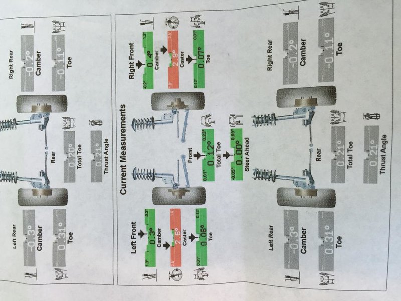

  17. Dec 27, 2014 at 6:49 PM
    #17
    UrbanWarrior
    UrbanWarrior [OP] Well-Known Member
    Aug 24, 2012
    #85414
    186
    Hey guys thanks for all your help. I finally got my alignment done today. It drives well. I still feel like my tires look a bit this way \ / but that might just be me. Here is my final alignment specs. Let me know what you guys think? Guy at the shop what's a bit surprise with me requesting the specs I got here.
  18. Dec 27, 2014 at 8:56 PM
    #18
    JRFugitt
    JRFugitt Well-Known Member
    Oct 11, 2012
    #88749
    556
    Justin
    Texas
    '13 PreRunner V6
    Looks good, camber a little in but nice and even. Just keep your tires rotated like every 3000 miles or so.
