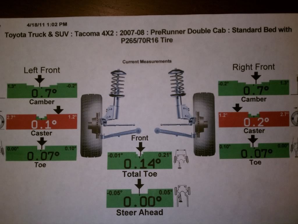

    Good or no?

    They must be terrible.

    You're in the red.ie:under 1.2*
    2.5 front lift...Castor imo,should be at least 2.0*

    caster is way out

    casters not going to do anything to the tires but
    it may pull to one side

    agreed.Front end float at highway speeds..yes?:)

    Yep, caster is too low. I've got the same problem since I went to 2.5" on the 5100s. I'm going to put new UCAs on in a few months. For now it's just a little twitchy on the interstate at high speed.

    X2 Mine tends to wonder around on the freeway. Cant wait to get UCA's

    that amount of caster shouldn't cause any pulls, only gonna wear when you are turning...I plan on doing my own alignment on my truck when I lift it,
