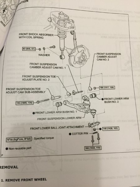

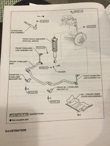

    Here are the front end torque specs.

    Oh so the 3rd gens are 139 ft lbs for the LCA bolts... The 2nd gens are only 100 ft lbs. Good info.
