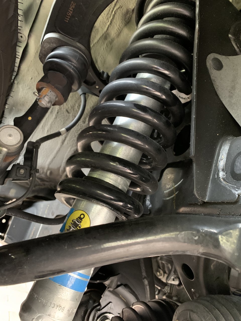

    Update- took the truck to toyota because lets face it. Im chasing a raccoon with a small hammer tapping shit and i cant find him. So the mechanic said it was the skid plate. Which after a quick test drive he realized he was wrong. Anyways i need to find a better skid plate. Because having the shiny diff drop showing is also annoying me. Heres my conclusion- the ome 885’s with adj bilstein 5100’s, when set at the same heighth or close setting, the noise im getting is the coil itself being released from being loaded and the bilstein shock is then supporting the truck when i turn or accelerate fast from a stop. Anytime the front left or right is raised the pressure on the coil is reduced and the coil is twisting itself. After all. The adj bilsteins are able to be placed on stock coil overs which is why i think the ome 885 is too much when combined with a adj bilstein 5100. So i am going to try a complete toytec with the aluma coil overs pre made. And see if that helps. If it doesnt than fuck it. Its just a truck.

    Are you using the 885s with the 5100s lifted? You're only supposed to use them at the stock setting with the aftermarket coils.

    Yep. 5100’s with ome 885’s.

    Yes, but are the coil buckets at the very bottom setting?

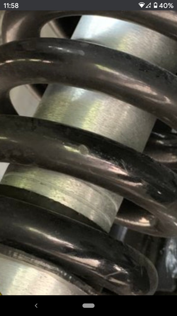

    That paint chip on the second loop of the coil looks like your sway bar is hitting the coil. Do you have sway bar spacers or is your sway bar all stock? I had to get spacers for mine.
  15. Jan 17, 2020 at 12:01 PM
    #35
    blacktoyotatacoma
    blacktoyotatacoma [OP] Well-Known Member
    May 23, 2013
    #104754
    86
    Florida
    2018 quicksand dcsb tacoma sr5
    I have a sway bar relocate kit yes
    Ccrames2018 likes this.

    I did 5100’s all around, ome 885’s. Rear has an AAL, sway bar relocate, CB drop, cmc for the 285’s and spc adj uca’s. Sounds like i need to ditch the oke 885’s. Find some better coils.
