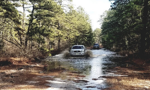

    Thanks for the advice everyone. Sorry Brian, the only picture I have is not that crazy and I made it my profile picture.
    and one of the cranberry mounds we played around

    wait that didn't post the truck... try #2
