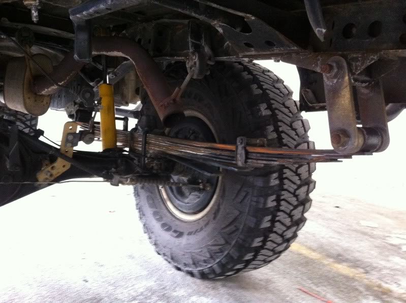

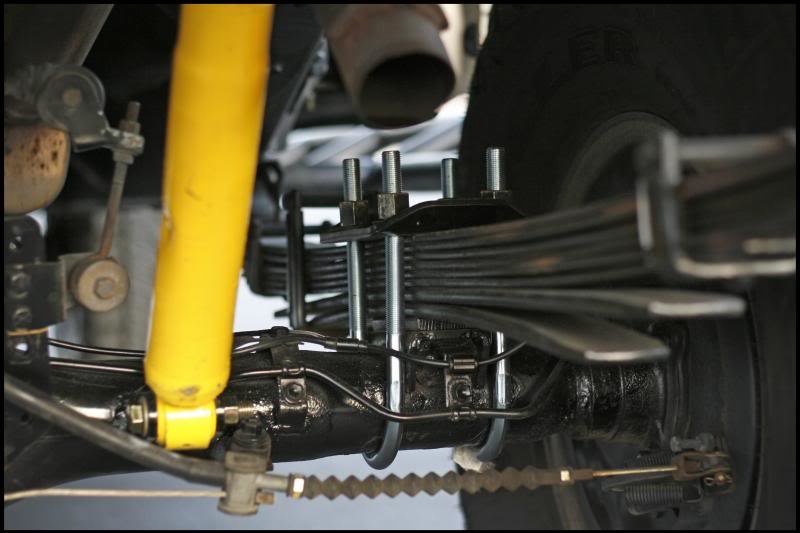

    Dakars are designed to be pretty flat. They can also appear to have a bit of a "wave" like you describe because they are NOT a constant arc, but have a flat section in the middle where the ubolts go. This flat section allows for the springs to seat properly on the spring perch and so the ubolts don't have to pull against the arch of the spring to get the spring to seat.
    Here's a photo of my Dakars (with the extra D6XL add a leaf) on my truck. These are ~3 years old. I also have 1.5" longer shackles
    Another one from this winter before the ubolt flip.

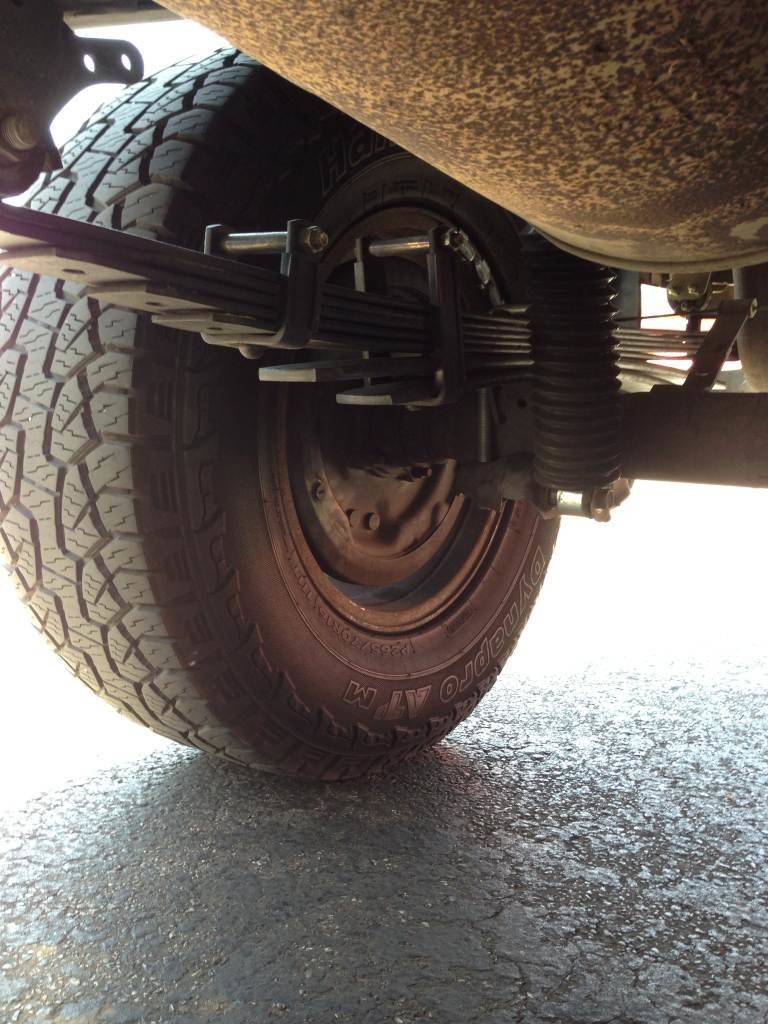

    I guess I should have posted pics of my own...
  4. Jun 19, 2013 at 11:22 AM
    Box Rocket
    Box Rocket Well-Known Member
    Mar 1, 2010
    #32389
    7,126
    Adam
    Syracuse, Utah
    1995 FZJ80 Land Cruiser
    3xLocked, lifted, well used
    Looks normal to me. Do you have a topper or any other extra weight in the back?

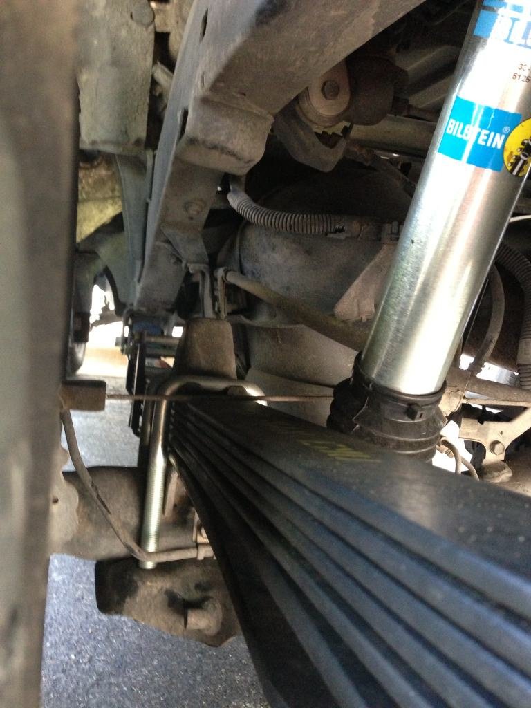

    Here's a pic of the passenger side
  6. Jun 19, 2013 at 11:34 AM
    Mainmoe02
    Mainmoe02 [OP] Well-Known Member
    Apr 28, 2013
    #103047
    2,057
    Moe
    Austin, Texas
    01 Gold tacoma SR5 TRD
    3" lift EIBACH coils w/ 5100's front, OME/ Dakar leaf springs w/ toytec adjustable shackles at 1.5" and 5125's out back. 33x10.5x15 KM2's Relentless DIY steel bumper.
    Awesome, yeah after I saw yours to compare I felt better. No I don't have anything else in the back. It's just the weight of the truck. Did you ever have an issue with Rear Driver Side Lean? I have about a .5" difference from the rear driver.
    Thanks Adam!

    After seeing the second pic I'm convinced your springs are fine. I do have a slight driver side lean

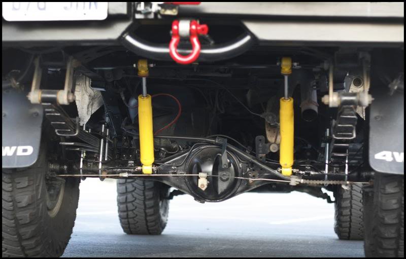

    which one is the D6XL? Thanks
  13. Jun 20, 2013 at 12:03 AM
    License2Ill
    License2Ill Shitiful
    May 20, 2012
    #79174
    2,113
    Ian
    It's a dry heat thou, AZ
    2004 SC'd 5VZ DC 5spd 4x4 TRD.GOV
    Bailing wire & Duct tape
    Third one down from the top.
    Btw, All the pics in this thread look like my dakars also.
