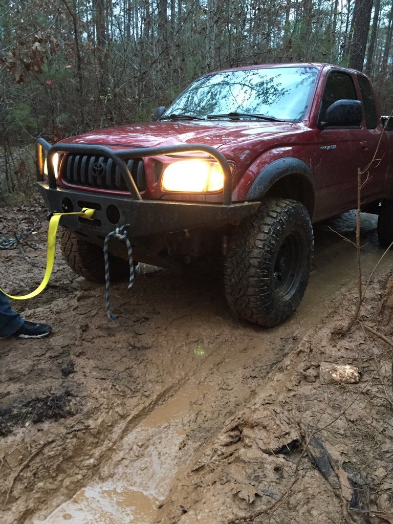

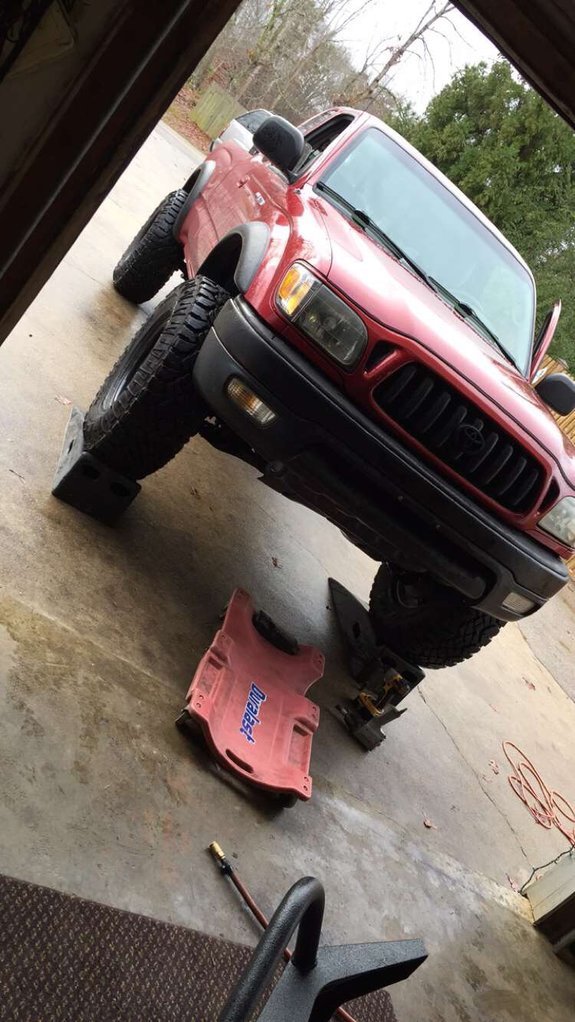

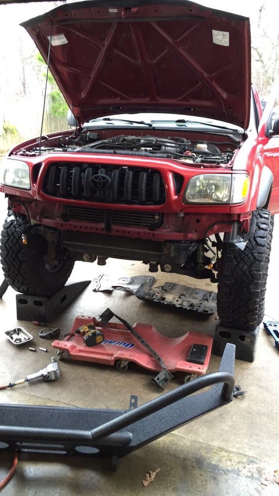

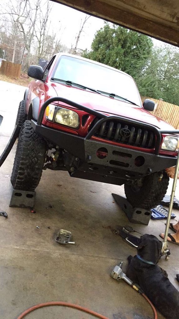

    FINALLY got my relentless front bumper and skid in! After some initial confusion about how to install it, we got it mounted up. Bolted right on, fit amazingly well. Looks nasty! 9fbaa0d5285a88242ec2d0b693da1364_0eeb655fbac3a06b8504cb57044b5ca792ed7dcc.jpg231344817f2f626f109ffbf6076234fb_b10ef9e6d18e07f9e0601998ca38137c1f414c0a.jpg1adbc8e85059dbda6d9d76ce80e6d933_f58d4691aca5252f16fac19b6a6581f867deede1.jpg8d0a64ab2b2931cb573beef647d326b8_00d002e29ef6283dea446eee6c6cafb9b60663b2.jpg

    Really really really bad idea to snatch from that spot. Buy a d-ring and use the reinforced recovery points. Even a cheap ass shittybuilt d-ring is a better idea than snatching from 3/16" flat plate

    Yep I found that out! Pulled my buddy right out but it bent the bumper just slightly haha... Gonna use the mounted recover points after that.
