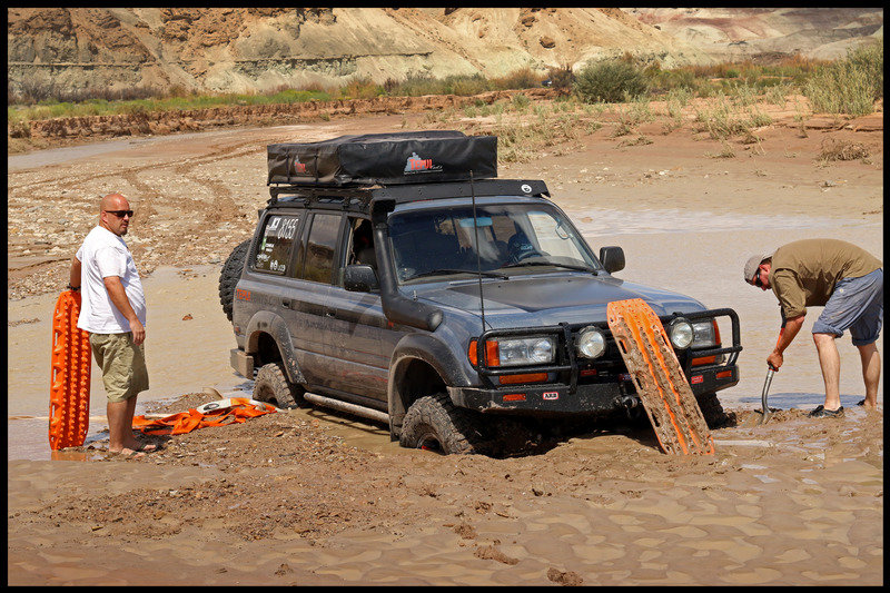

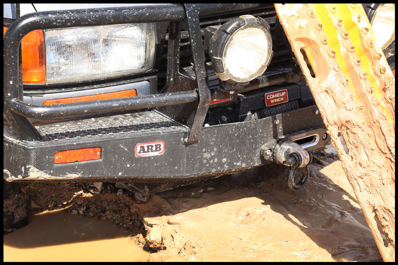

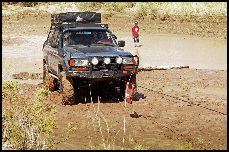

    I've used a hilift on the trails more times than I can even remember now. Sometimes it has been the only thing that got us out of the situation. Every truck that leaves the pavement should have one in the truck all the time.
    My most recent time was over Labor Day weekend a couple weeks ago. I buried my Cruiser up to the frame in a soft riverbed of silt and gravel. We tried to snatch the truck out with a strap and another truck and it wouldn't move it even a centimeter. We couldn't get the other truck to the bank in front of my truck to use as a winch anchor so we spent some time digging and finally a truck drove up the river bank in front of us and we could use him as a winch anchor. But before we could do that we needed to break the suction. We used the hilift to lift the front of the truck up out of the mud. We used a big log as a base so the jack didn't sink in the mud. We got the tires up out of the mud enough that we could slide a set of maxtrax under the tires to help get the truck back up onto the surface when we winched it instead of just continuing to plow through deep mud. Worked perfectly.
    not stuck yet.
    stuck
    still stuckIMG_1505_zpswsgt7vzd_d0487d75dd9e17dcdc05ca45866584e5dfcc65d8.jpg
    front end jacked up and maxtrax under the tires, ready to winch
    not stuck

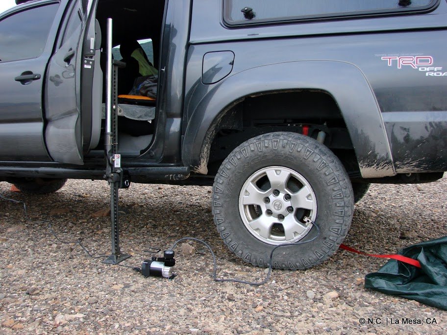

    The Hi-Lift off-road jack is an amazing tool. I use mine frequently for regular vehicle maintenance.
    Last time I used in dirt was in freezing temps in Death Valley.
    I thought I'd lost the bead on tire.
    Strapped the axle to the frame, and jacked it up.
    Put air into it, tried but couldn't find holes.
    Found the holes later in the day, and plugged both in the freezing winds at Chloride Cliffs.
    DSC01948_815dd923d631645f651f4abd2e9aef8f06fceb83.jpg DSC01994_6fc2ca697523866565385afcdcffcbcb915f6f33.jpg
    It's so hard to work in the cold! Everything is so much more difficult! Hands turn blue, tire plugs are all stiff! Had to be thawed using heater vents.
