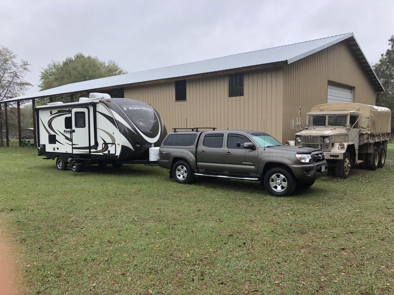

    2014 Keystone Bullet Premier 19FBPR, Dry 4800, Loadout about 5100. Fastway E2 Weight and Sway hitch (Amazing), Brake controller. Front Axle weight good, rear axle good, Tow weight good, GCVW good, payload pushing it a bit over since I added the leer camper a year ago. Been pulling this set up now for about 5 years, does well put like others said, keep plenty of distance and not over 65. And for the next question no, the deuce and a half is not mine (batteries not included sold separately) this belonged to the harvest host that we were staying with. IMG-2188.jpg

    Very similar to my setup. Nice

    how are you liking the interior and storage space? I much prefer these over a used airstream or scamp.

    Absolutely love the Bullet, perfect for just my wife and I. The slide makes such a HUGE difference, even with it only being 19'. Lots of storage space in the front storage area, can easily fit my honda 2000 in there. Did the soft start mod to my ac so that only one honda is needed instead of two in parallel. Also modded the gas cap with a fitting so that I can pull from a 5 gallon gas can and run much longer than normal.

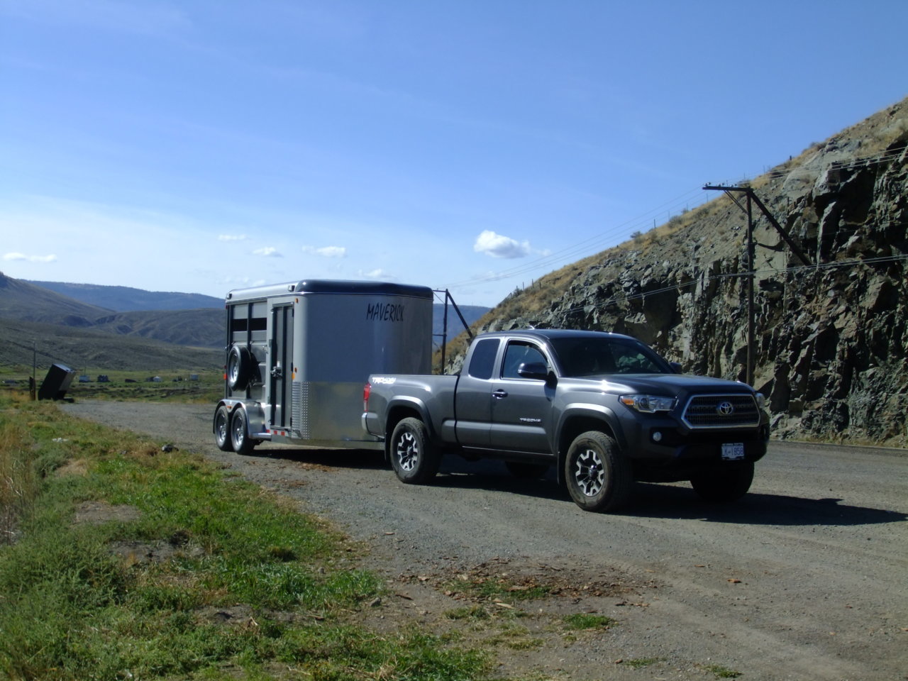

    went for the blackout package this time
    horse/stock trailer at Savona, BC. DSCF3695.jpg
