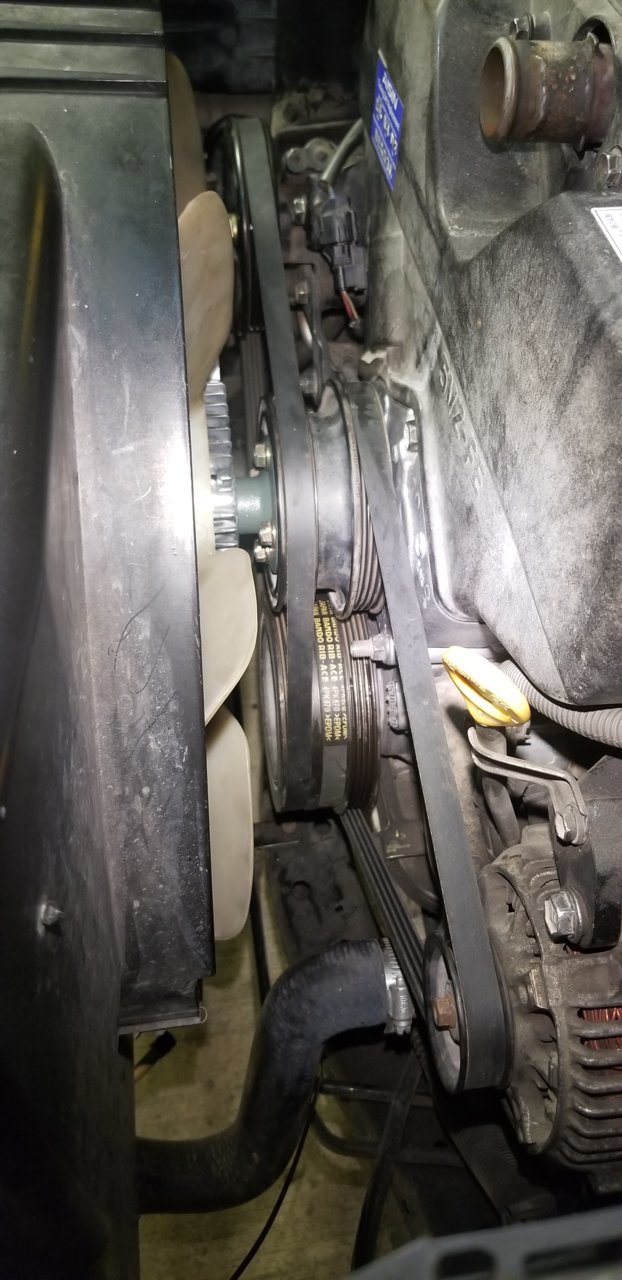

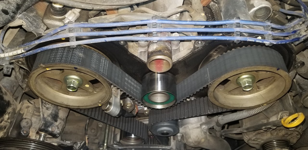

    I noticed a noise back in July and at first it sounded like an engine knock. I searched and the threads I came across said it could be the water pump or fan pulley bracket. One thread mentioned the timing being off but I think I wouldve noticed something right away.
    This past weekend I changed out the fan bracket and Fan clutch. The reason I ignored the wp suggestion is because I did the TB kit (full OEM/AISIN) 9k miles ago in March. I'm still hearing the noise:confused:
    What are the chances that it is the wp?
    You can see in the photos how close I am to the water pump, only to put everything back and still hear the same noise :annoyed:
    I've got some videos of the noise before and after. What's good to use to be able to post videos?
    Thanks.

    take the serpentine belts off, start it and listen for the noise, if still there, take it down to the what you see in the first picture and start it and listen.

    You could help isolate by removing a belt and see what changes. See or hear the difference between belts being disconnected.

    You can run the engine without any of the accessory belts - maybe taking one off at a time and seeing if you notice a difference.

    Remove belts and run.

    What was stated above. Remove one belt at a time and you can pinpoint if it’s a driven accessory issue. If all belts are off and it still makes it? Then your looking for an issue in the timing belt area.

    I got an opportunity on Monday to take each belt off and listen. After all belts were off I narrowed the noise down to being behind the TB cover. At that point the engine was at operating temp so I could not remove the upper hose in order to take off the TB cover without making a hot mess.
    Next time I will remove all belts and TB cover, put the upper hose and belts back on and run it with out the TB cover to see which pulley wheel is the culprit.

    So I changed the fan bracket and fan clutch and still heard the noise afterwards. I have narrowed it down to being behind the tb cover after removing all belts and loosening the tb cover which allowed the noise to amplify. I will investigate further with the tb cover off and have the truck run. Stay tuned
    When this is all said and done, it will boil down to whether or not it's adamant I replace the said issue (bearing, etc.) In fear of it failing before the next scheduled interval or let it be and hope it lasts. Yea I'm sure I can get a replacement from Amazon with no problems but the thought of doing the labor twice sucks. The only good part is I'll be able to do the job alot quicker than before :cool:
