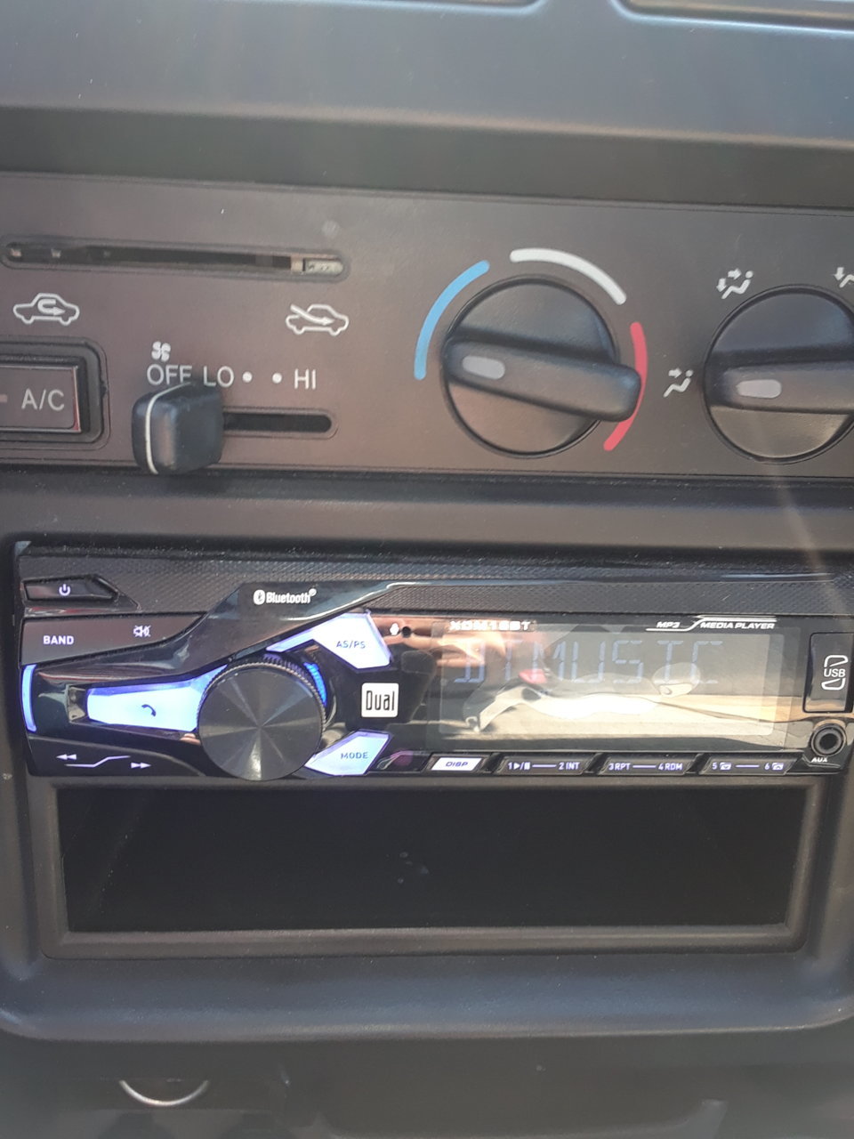

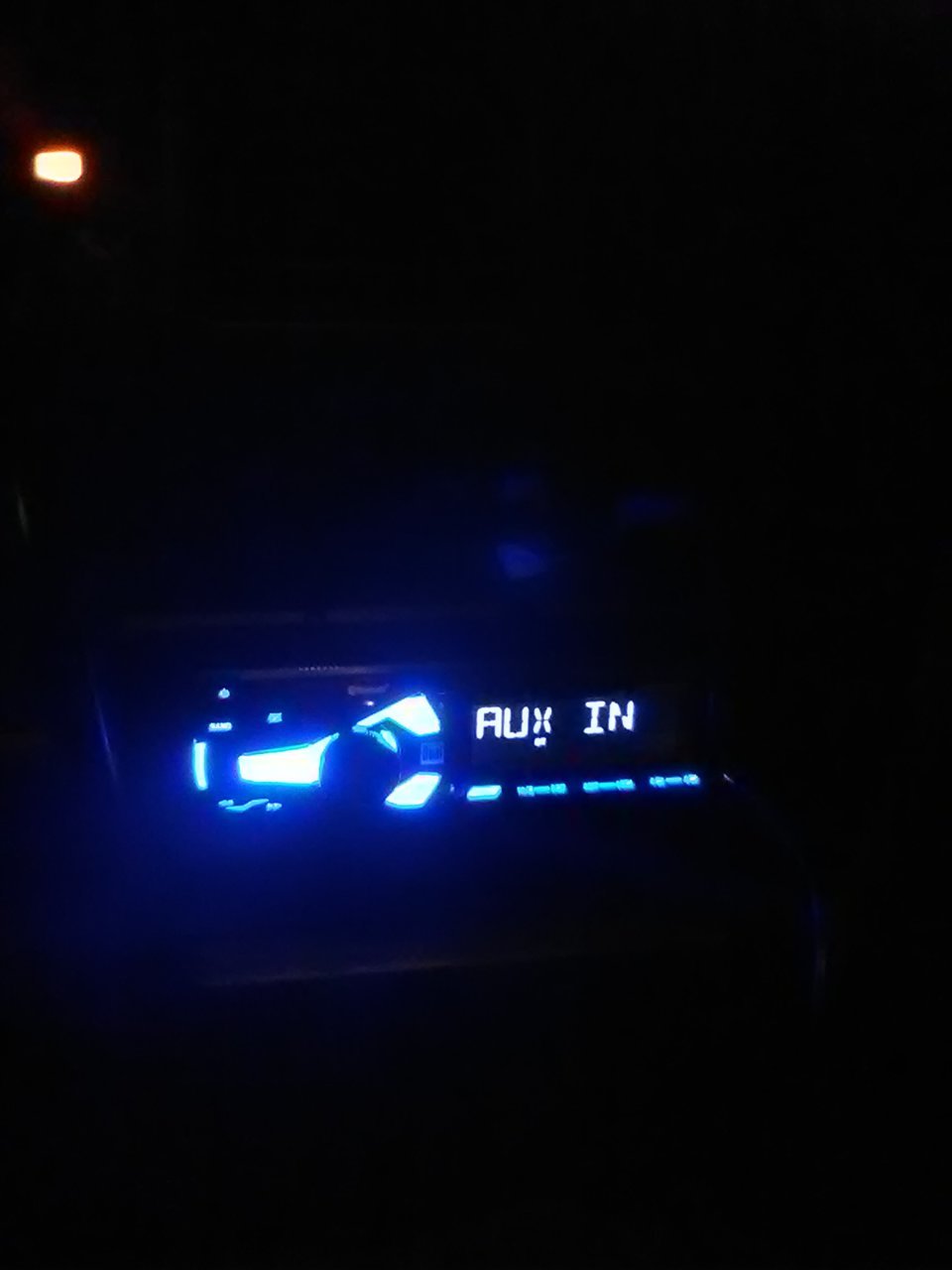

    Dual Bluetooth Media player... because: cheap.
    It was only $20...plays my spotify... and I can talk to people on it.
    My speakers are aftermarket as well... however the first owner had it done in the early 2000's so I don't know what they are exactly. They sound really good though.

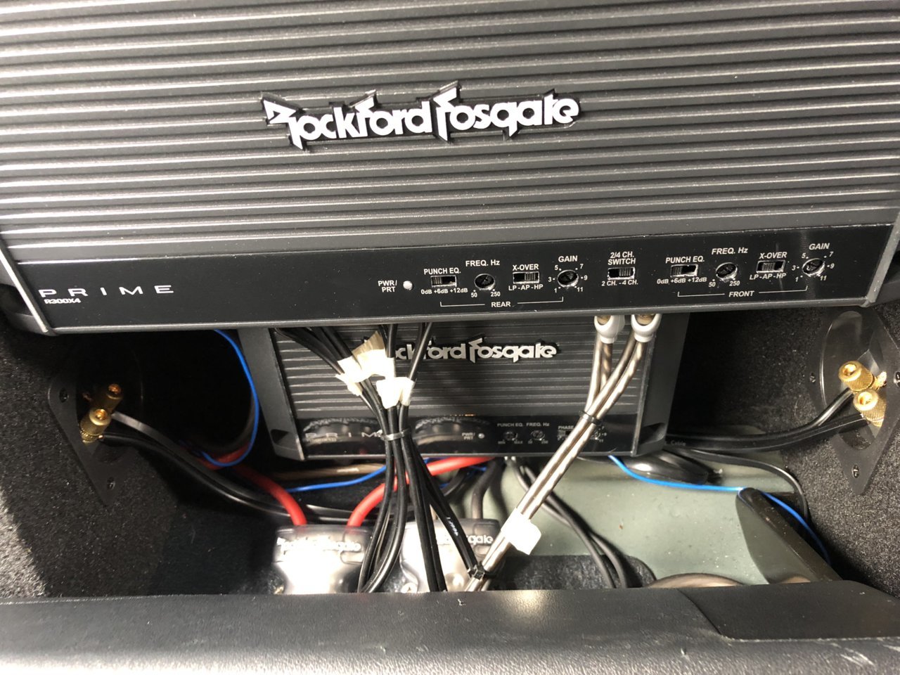

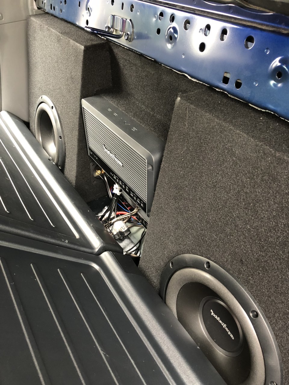

    DCLB - Pabst Metallic
    OME 885, Billstein 5100, Deaver 2" AAL, ARE CX Cap, Go Rhino Dominator steps
    Kenwood HU, Sosche dash kit
    Rockford Fosgate Punch Components in front doors
    Rockford Fosgate Prime in rear doors
    300w Fosgate amp for the doors
    2x Rockford Fosgate 10” subs
    500w Rockford Fosgate for the subs
    Maestro iDatalink for gauges
    Bass control knob in center console.
    Ballistic sound deadener - floor pan, doors and back wall
    Skull crushing......
    Pokémon wasn’t part of the upgrade. Good luck token from my kids.

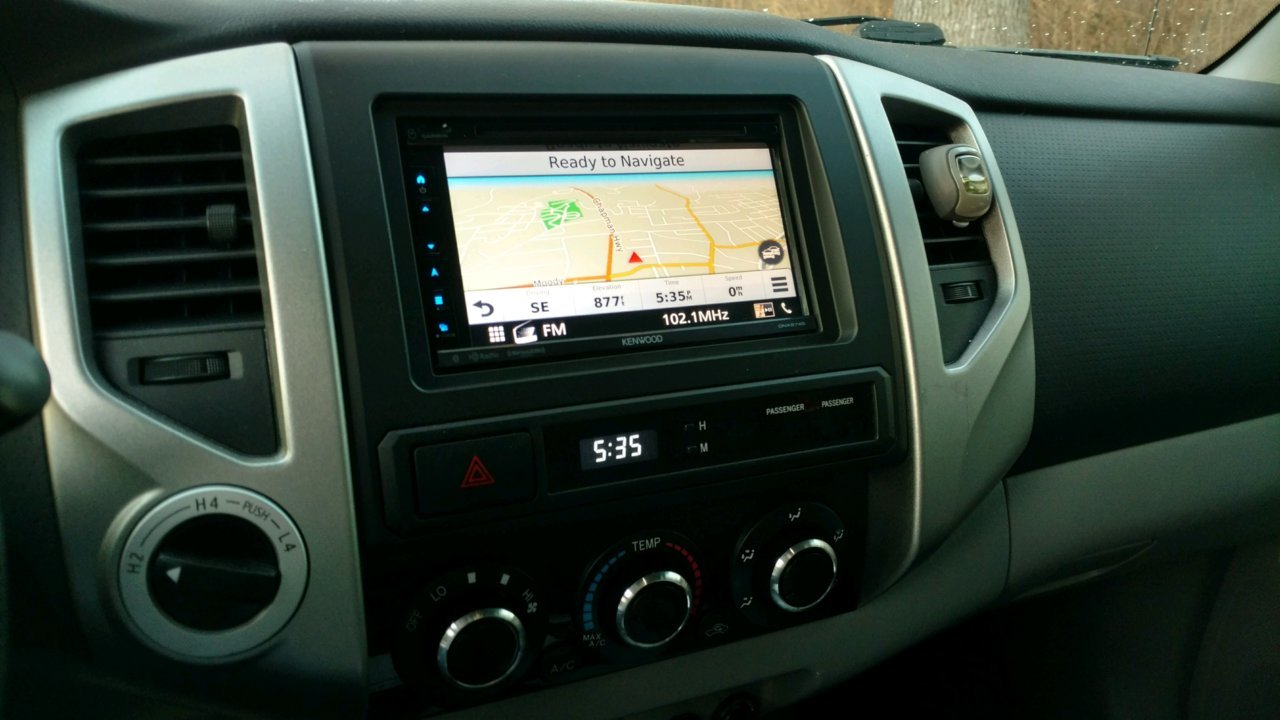

    A few mods here and there and counting....
    Upgraded from pioneer avic z130bt to kenwood dnx 875s. Couldn't be more happier. Love the new features (apple carplay, front camera) Touchscreen is capacitive so response is ultra fast.

    That looks niiice... might get something like that for the Civic. How much did that set you back?!

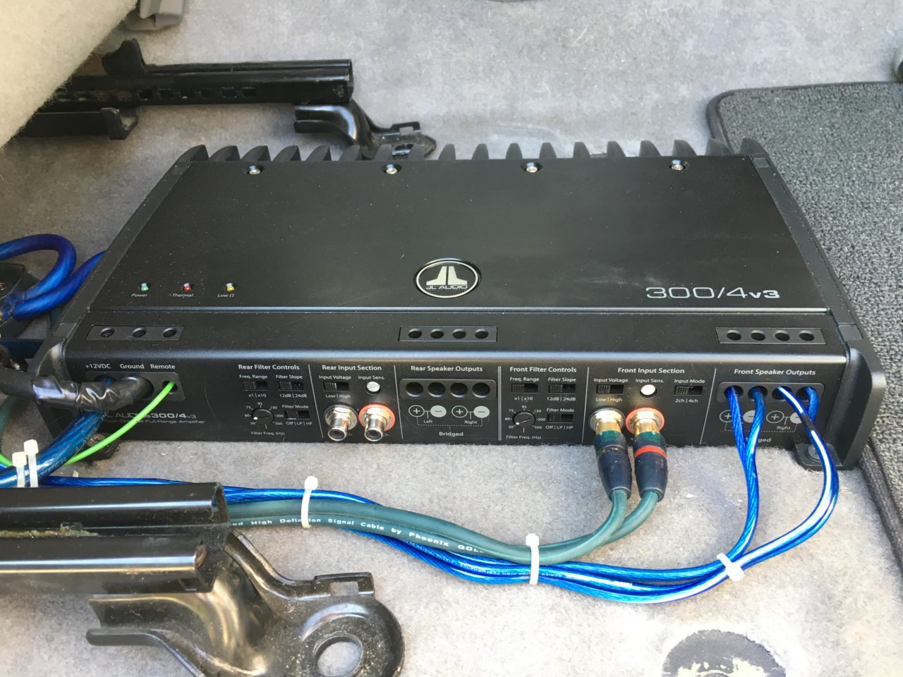

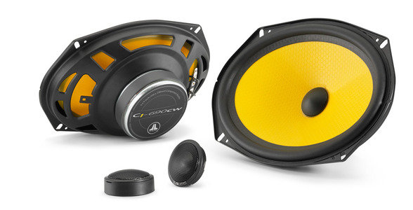

    My 1989 Alpine 3552 multi channel amp finally started showing its age so I replaced it with a JL Audio 300/4V3 Slash 75x4. Now thinking of installing some 6x9s in boxes for the Access Cab to take advantage of the back channels. I like the 24 db crossover. It cleans up my front component speakers nicely! Here's a pic when I installed it last month. The sound is as least as clean as the Alpine was in its prime. (Also have a 500 watt mono Alpine feeding a 10" MTX sub behind the driver's seat.)

    If you have a sub I wouldn't worry about the 6x9's in a box. Putting vocal speakers behind you ruins sound staging. I'd take that JL 4 channel amp and bridge it into a 2channel amp, run that to the front speakers. As long as the signal is clean they'll take it. More power to the fronts.

    I used to run my Alpine 3554 multichannel bridged to 150x2 and it was a bit much for the 20-year-old Infinity Beta 6 components. That amp developed problems so I swapped in the 3552 and bridged it to 85x2 and that seemed a better match. (Both amps were left over from previous installs.)
    I talked with two different car audio shops and both cautioned against running the JL at 150x2. They thought it was too much power for those speakers.
    My old 2002 Tacoma extra cab had factory rear speakers that I had running off the deck and it seemed like a nice rear fill.
    I want to add some much needed mid bass, as currently I have good mids and high frequency and good low bass but little to no mid bass.
    Just this past weekend I had a local shop run a set of RCA interconnects off the rear output of my 11 band Alpine EQ so I can fade the output to the rear speakers. (I’m sure my Dachshunds could care less about rear sound and would appreciate the speakers faded out!!)

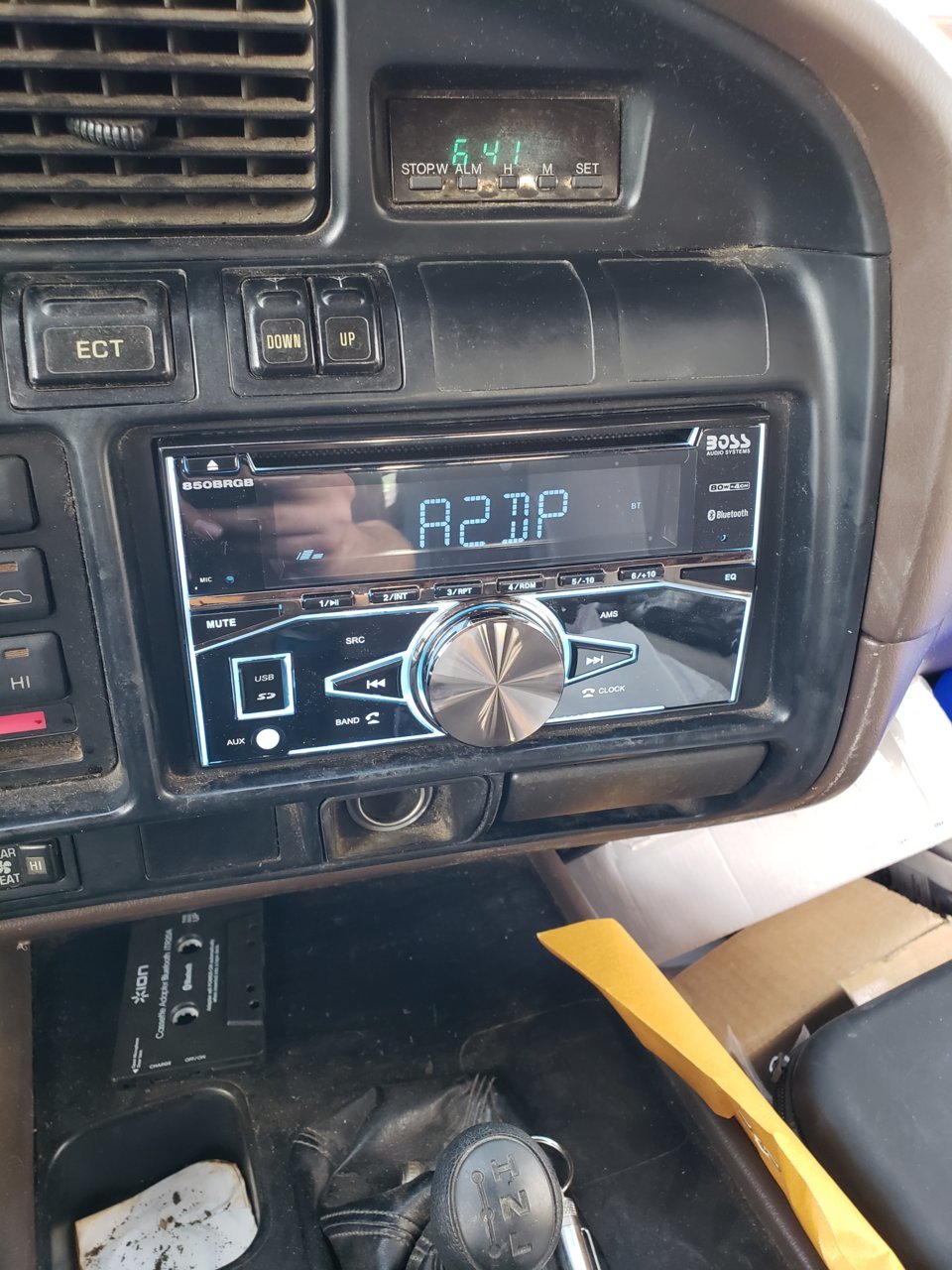

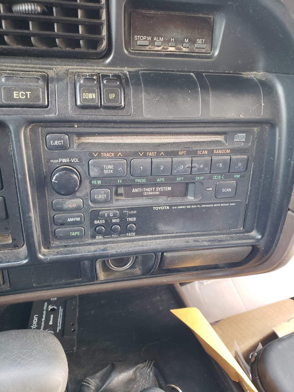

    Did this today. Very basic but better than nothing.20180525_174609.jpg 20180525_184024.jpg
