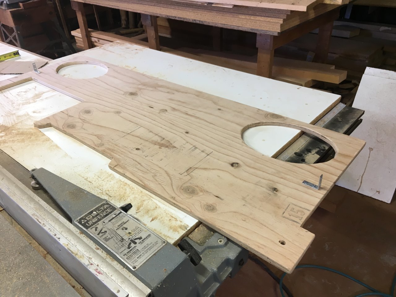

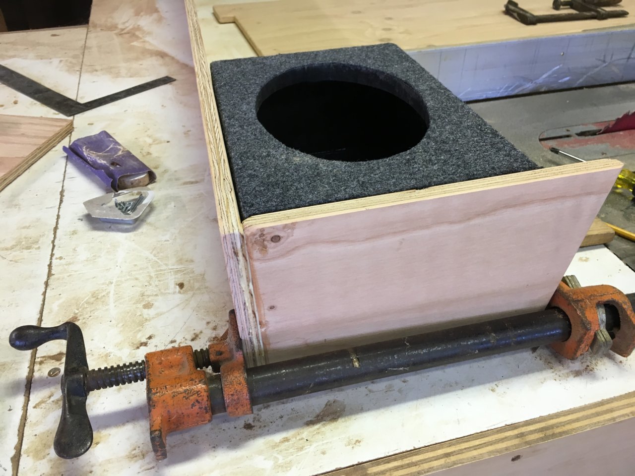

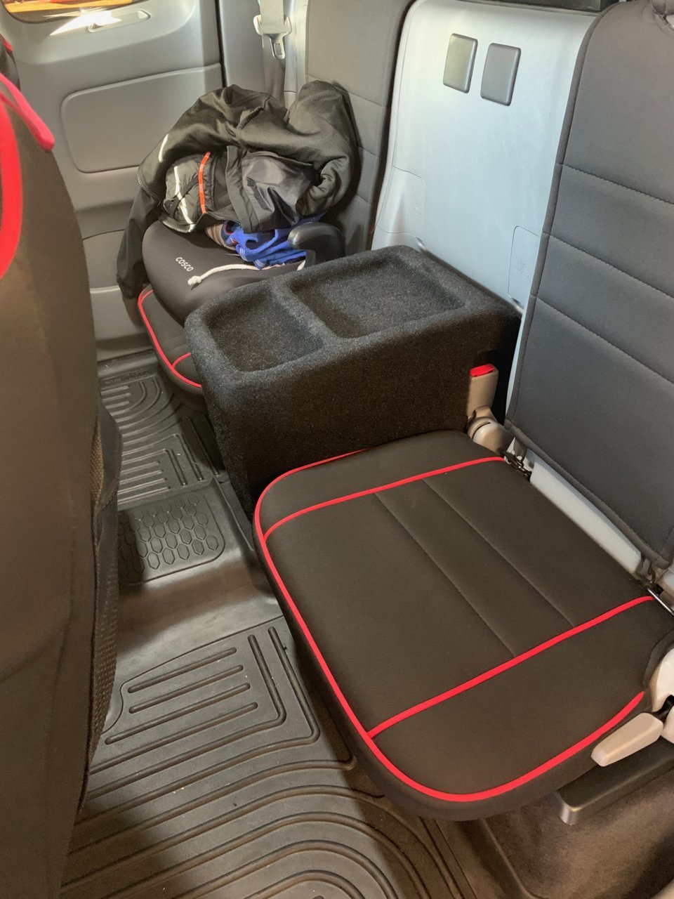

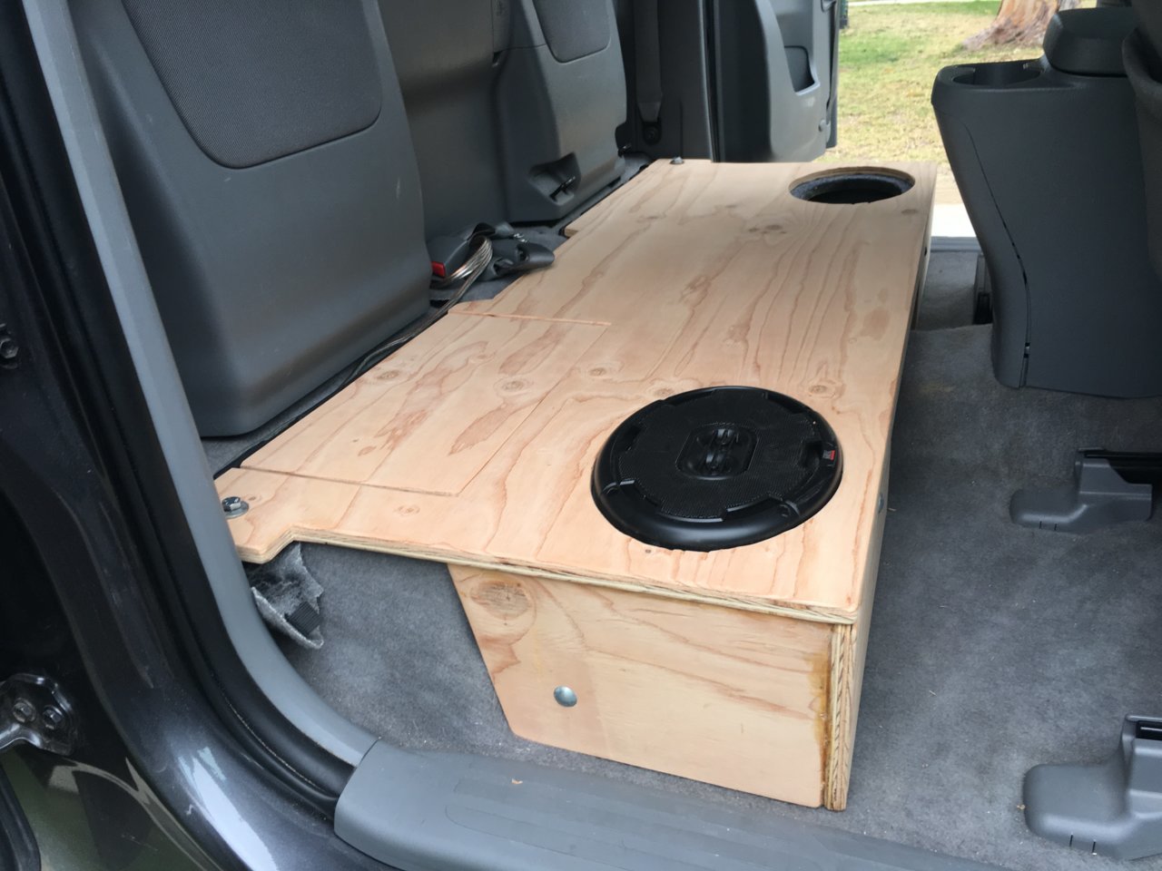

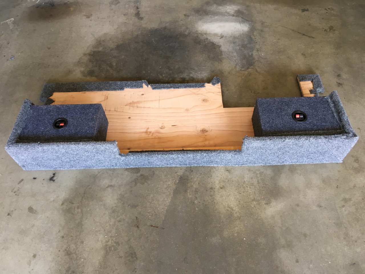

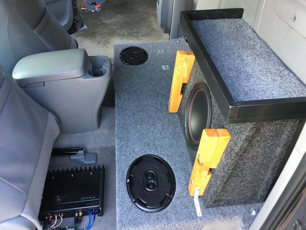

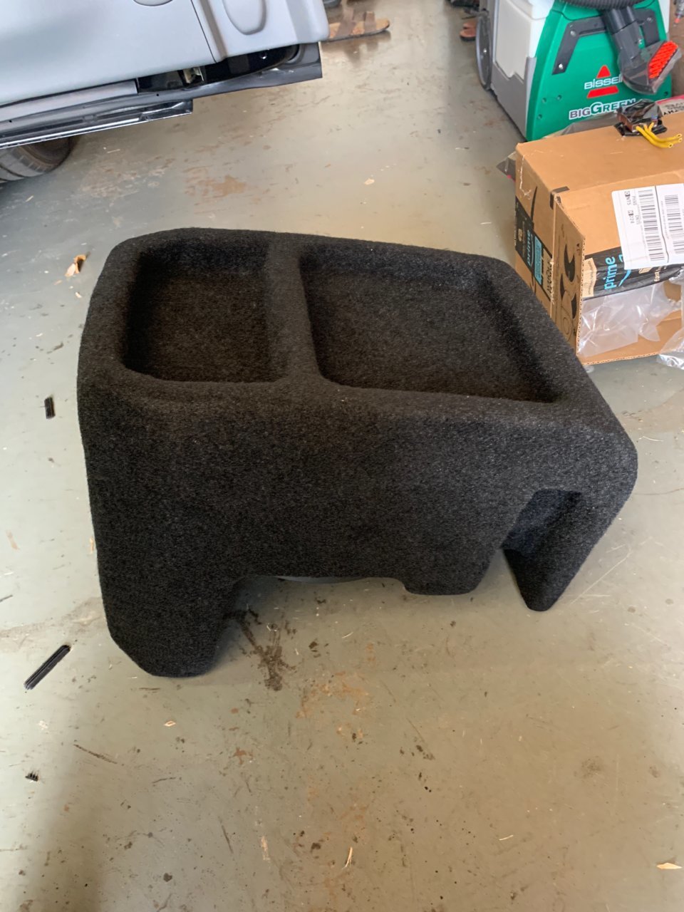

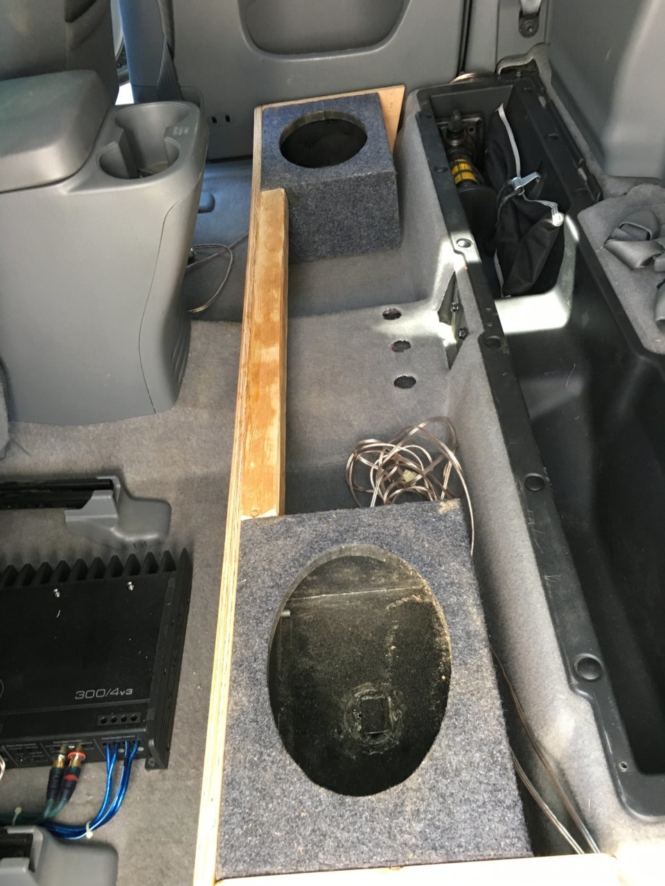

    Hey all,
    Well,

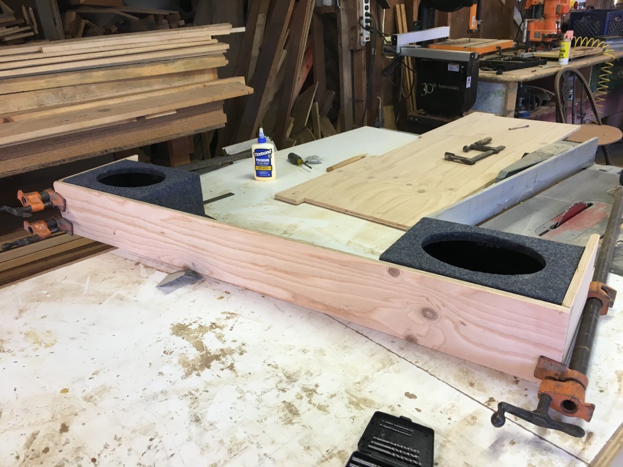

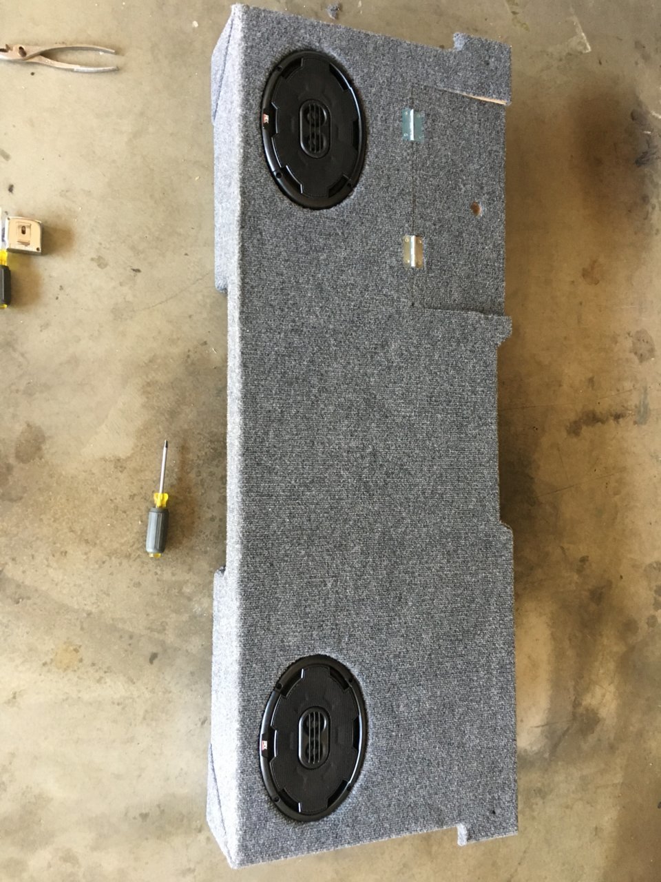

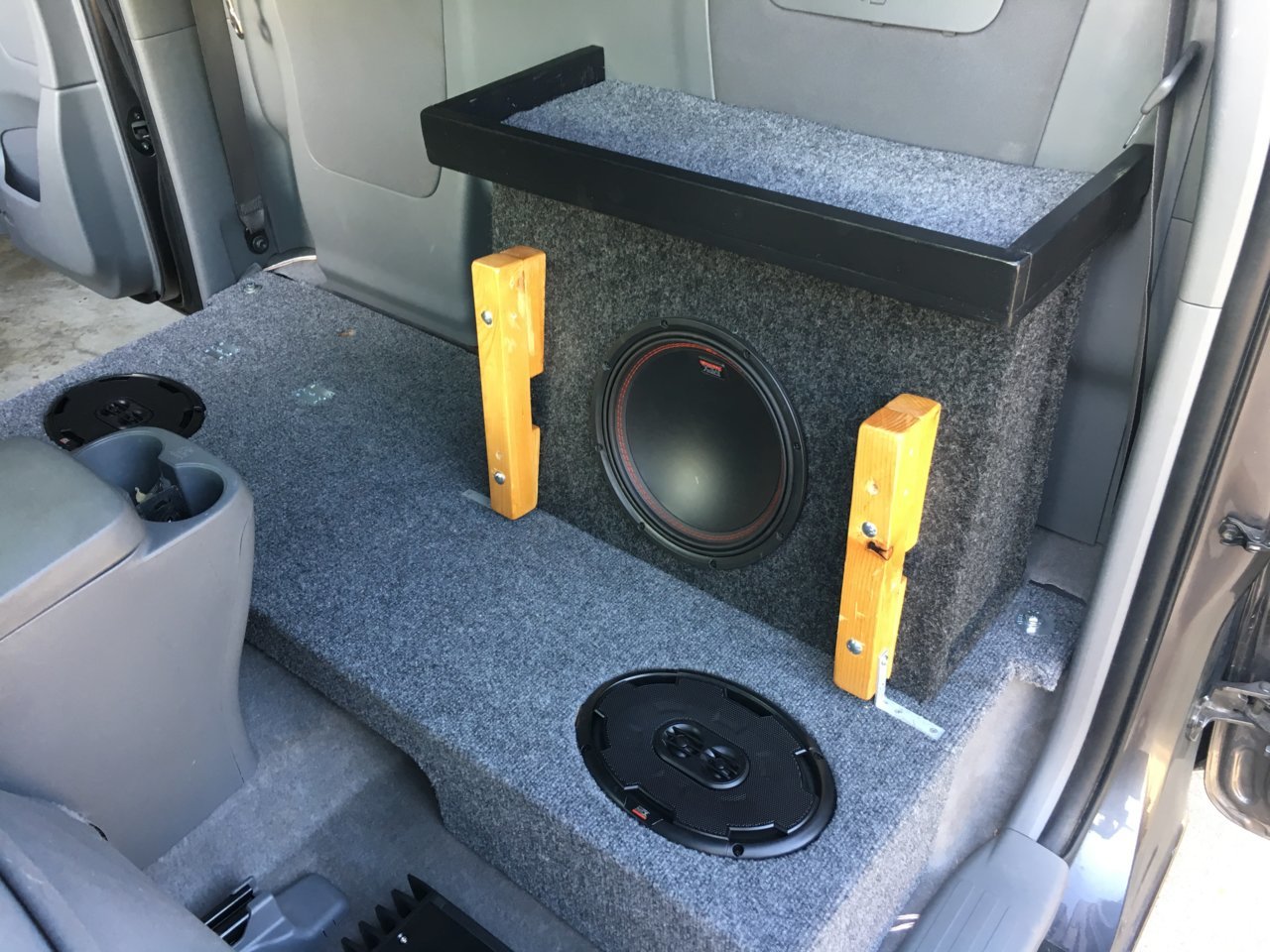

    After months of thinking and drawing pictures of what I wanted, I finally designed and built my platform for the rear of my 2011 Tacoma Access Cab. I posted this to the 'Dog Platform' thread, because that is where I got the idea, but I thought that since I added speakers it might be a good idea to post the construction pics here too incase someone could use some ideas for their own project.
    I pulled out the useless jump seats and was able to get some longer bolts and utilize two of the factory jump seat mounts to anchor my platform to. The bolts are M8-1.25 and are about 3/4" longer than the factory ones. It worked well to utilize those mounts, as the platform is well anchored and does not move around.
    I used 5/8" plywood from Home Depot for the construction. I built the platform in my grandfather's old cabinet shop and it was nice to have the proper tools for the job.
    I incorporated two MTX 6x9 speakers in sealed boxes that now run off the back (formally unused) channels of my JL Audio 75x4 amplifier.
    I bolted the boxes to the front and side panels of the platform with carriage bolts and also used some wood glue to make sure the boxes were tight against the plywood. I used two corner brackets below the boxes to help secure the basic framework before the top was installed. The boxes are 5.5 inches deep and the front and side walls of the platform are 6 inches, so there is a nice space underneath for the wires to plug into the push connectors at the rear of each speaker box.
    I cut an access hatch for the Toyota jack and tools on the passenger side and kept the plywood solid on the driver's side where the subwoofer sits.
    I used 3M Super 90 spray adhesive plus a staple gun to secure the carpet to the plywood. I found out that I'm a better carpenter than a carpet layer! Fortunately the flaws are only noticeable on the back side, so they will never be seen.
    All in all this project took three full days; about 24 total hours of work. I think it came out pretty well.
    I built a small shelf over the subwoofer with some of the leftover material and used 2.5" corner brackets to hold it to the back of the sub box. Maybe someday this would be a good place to incorporate an Audio Control EQS parametric EQ, which is something that I've had my eye on for a while.
    The 6x9s sound really nice and flesh out the system well. I had to adjust the gains on the amp a bit because rear fill should never call attention to itself over and above the front sound stage, but should just round out the sound to make a nice blend. They do that well. The problem I had before was that there was a 'hole-in-the-middle effect' because the mids and tweeters are up front and the sub is in the back. Now there is a nice mix of sound throughout the truck.
    I crossed the 6x9s over at 75k with a 12db slope, using the onboard crossover on the JL Audio four channel amp. I did notice that the sub sounds tighter now that it is sitting on a plywood platform. I haven't done any critical listening since installing the carpet this weekend, but it did sound better with the bare plywood. Hopefully it will sound as good with the carpet overlay. (The carpet looks blue in some pics but it is in fact 'Home Depot Sky Grey'. I think sometimes the iPhone camera gets fooled on color.
    Here are some pics of the project:IMG_0624.jpgIMG_0626.jpgIMG_0630.jpgIMG_0631.jpgIMG_0632.jpgIMG_0637-1.jpgIMG_0651.jpgIMG_0656.jpgIMG_0666.jpgIMG_0667.jpg

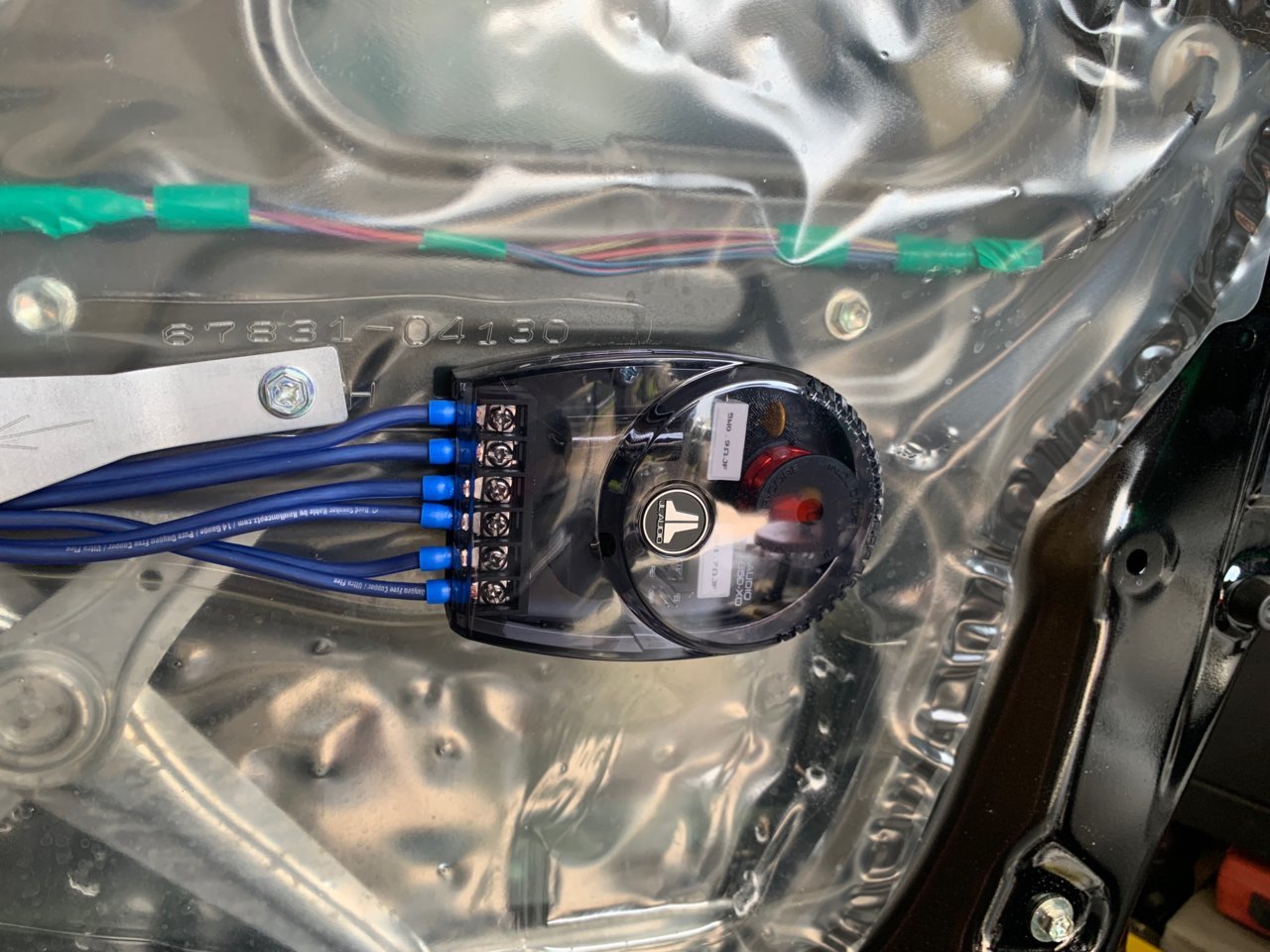

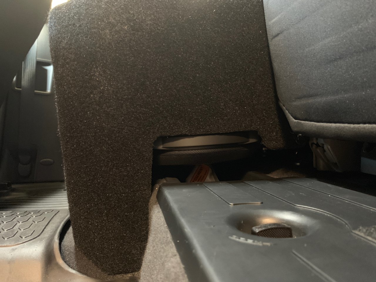

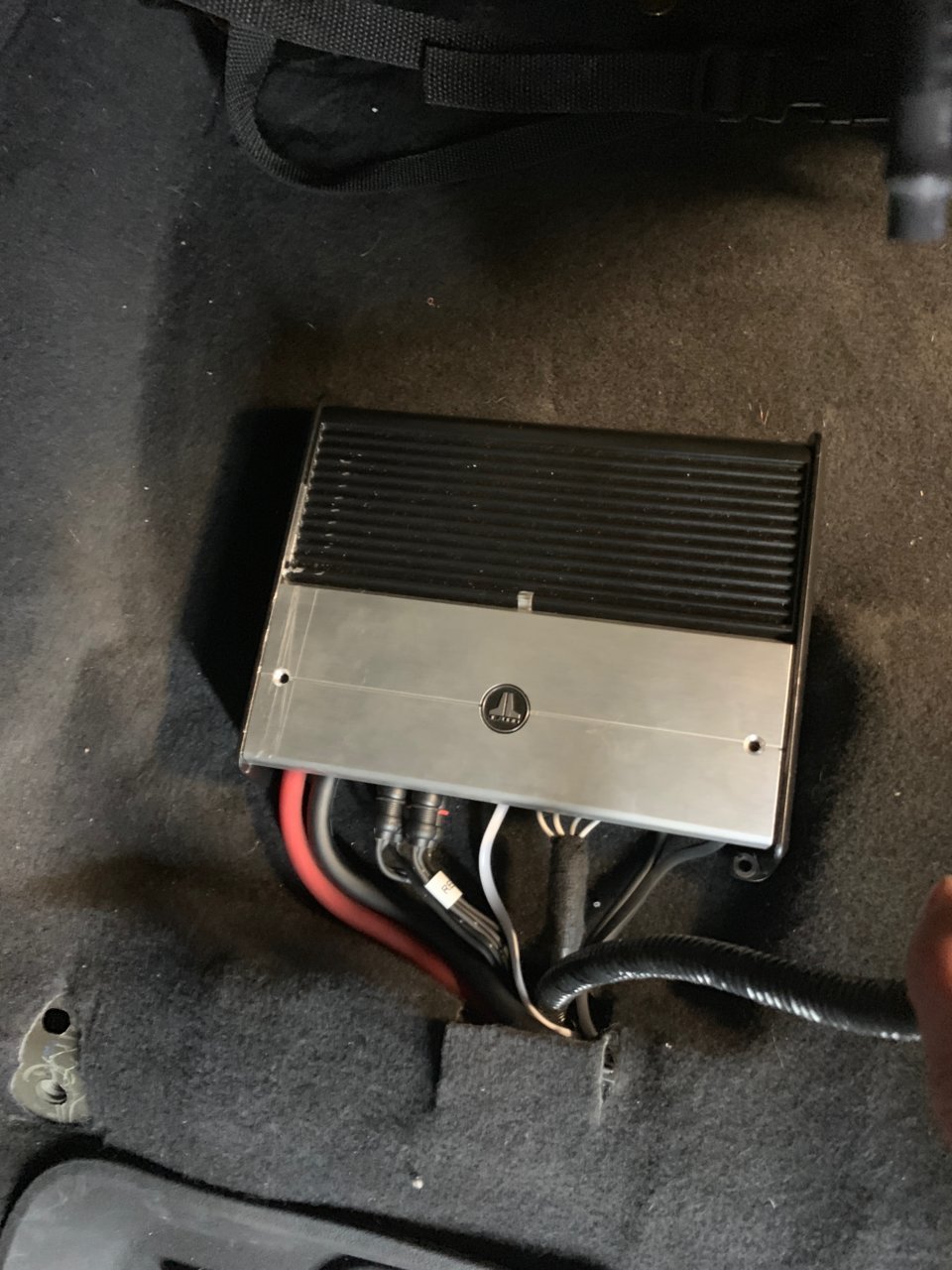

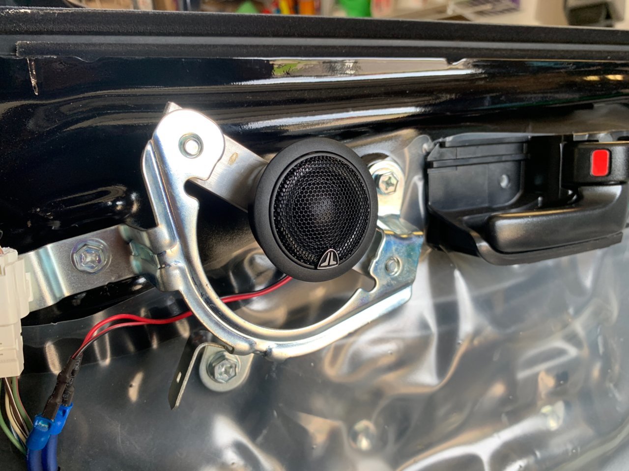

    Installed some jl stuff recently
    Jl 6.5 c2 components
    Jl 500/3 amp
    Jl 2016 access cab stealth box, this fit perfectly in my 2015 access cab.
    Still using the stock head unit, possibly looking to get a w8400nex.
    IMG_2669.jpg IMG_2670.jpg IMG_2678.jpg IMG_2680.jpg IMG_2682.jpg IMG_2711.jpg IMG_2712.jpg IMG_2713.jpg IMG_2715.jpg IMG_2716.jpg

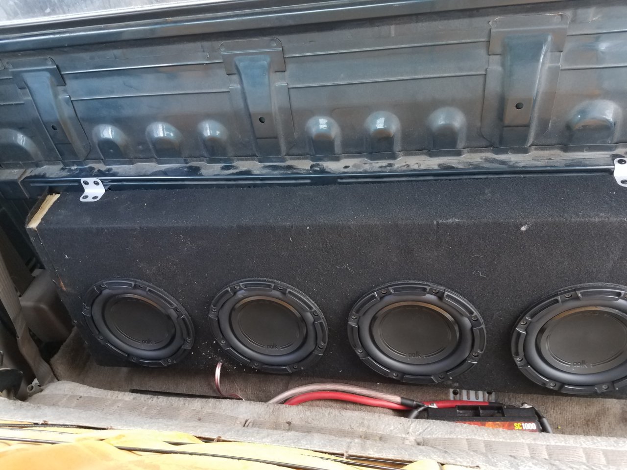

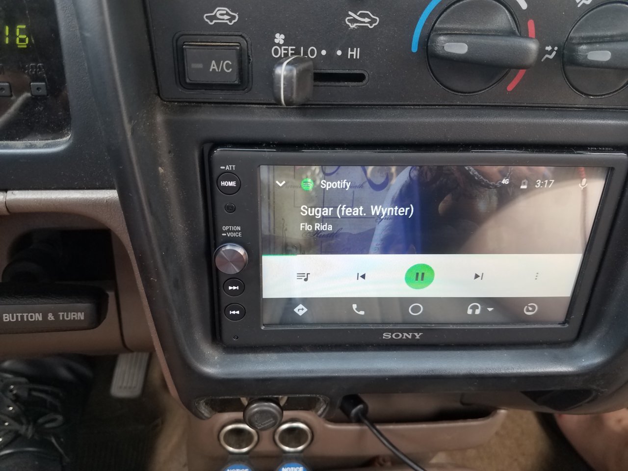

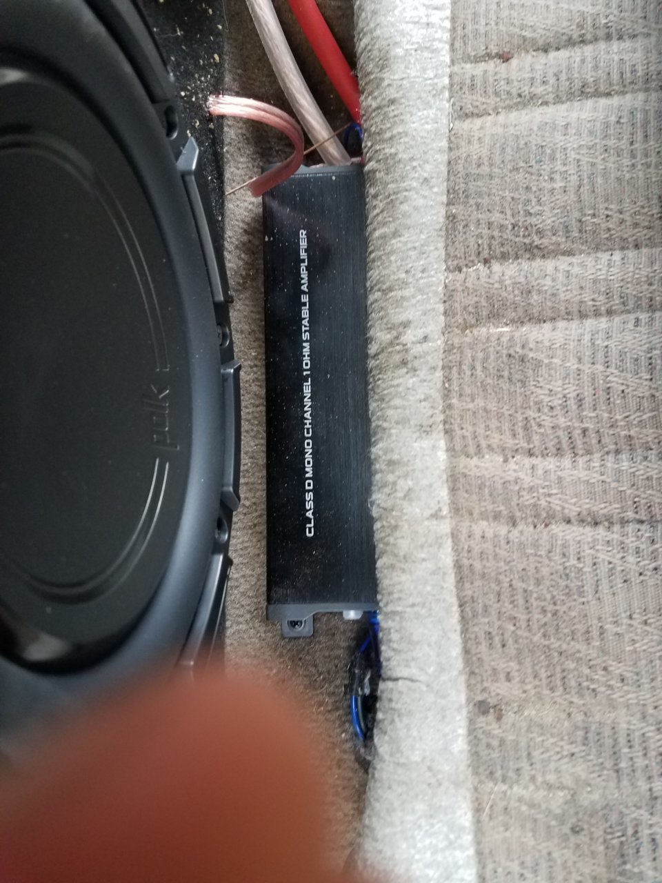

    Just gave Hank some boom.
    4 Polk Audio 8" subs with an Orion amp.
    Also upgraded the deck to a Sony xav-ax100
    Looks and sounds spectacular.

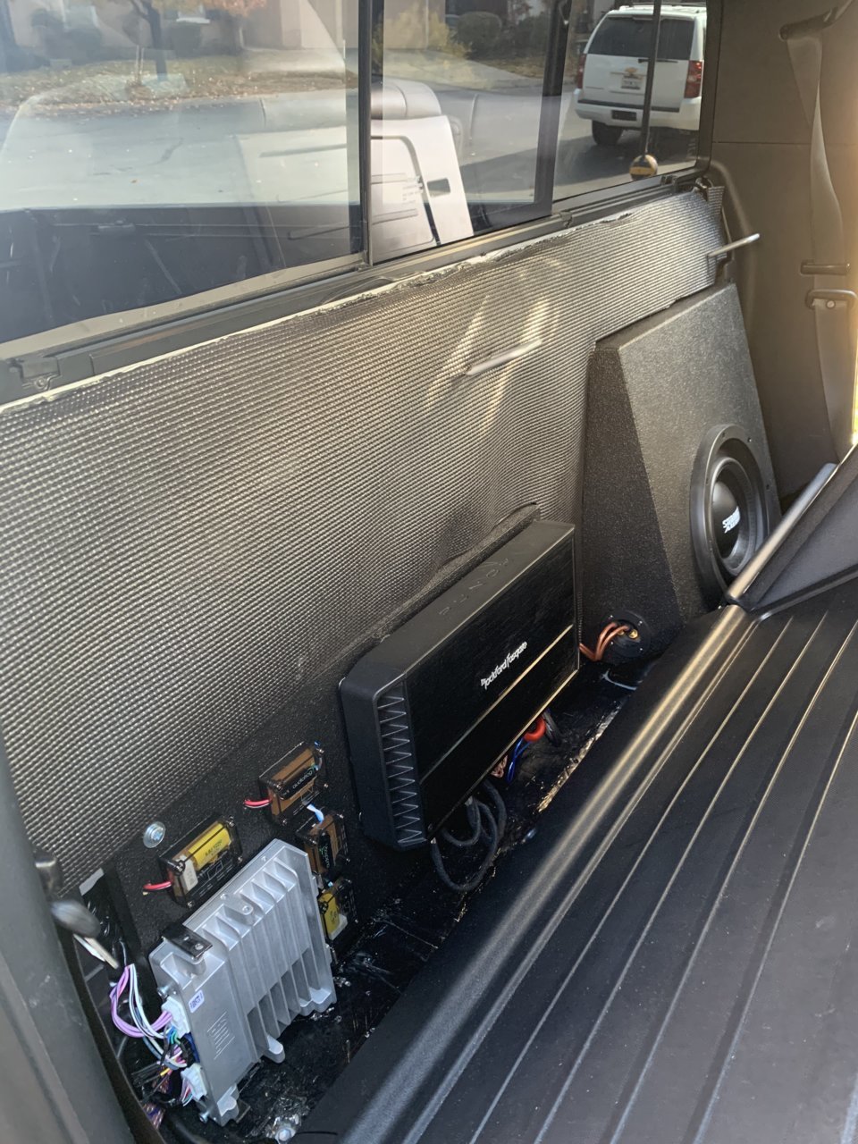

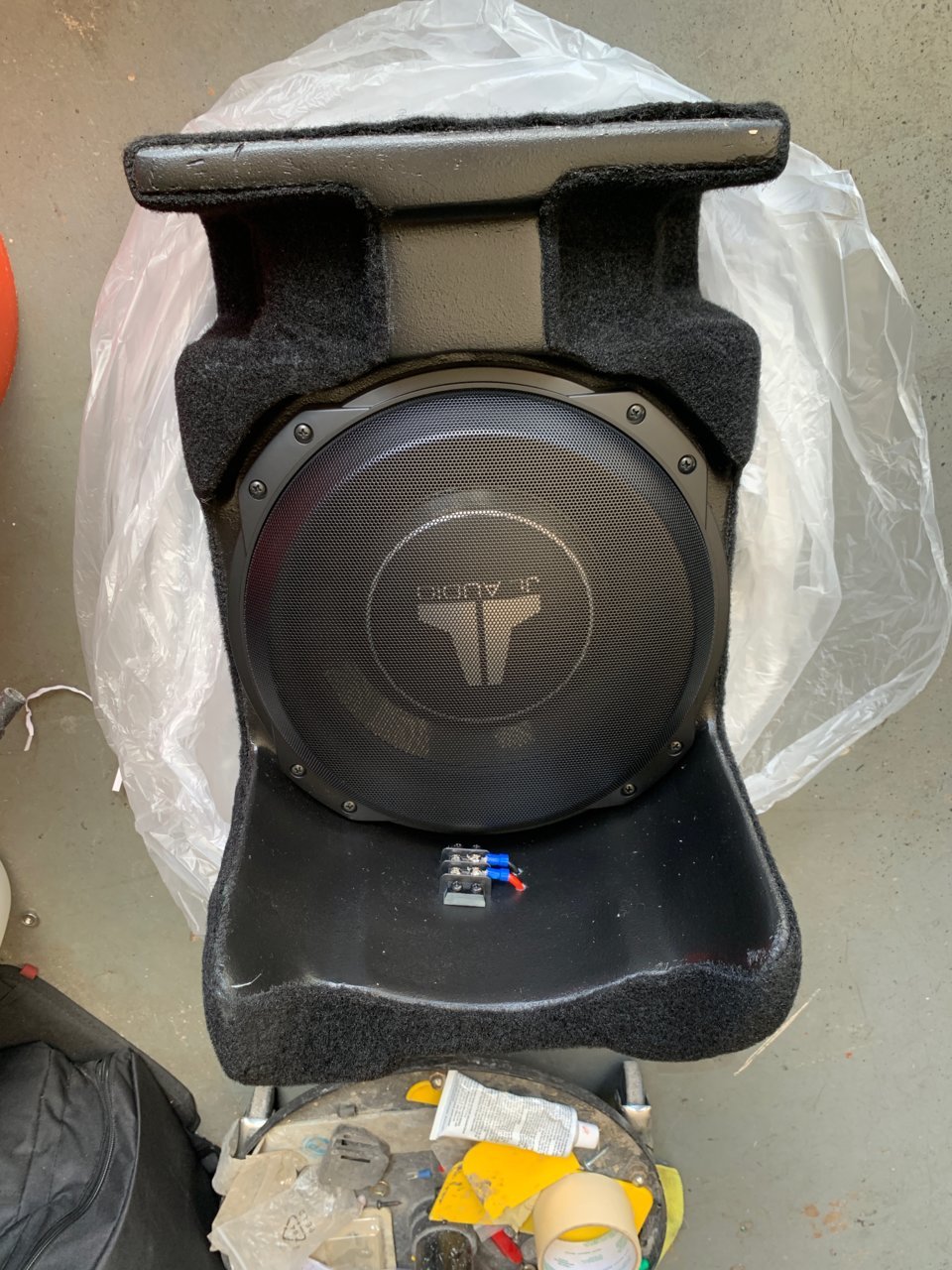

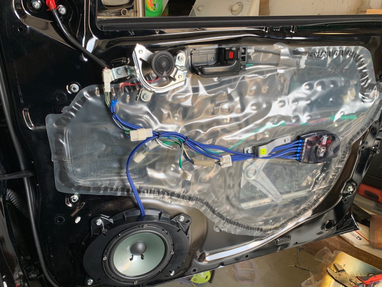

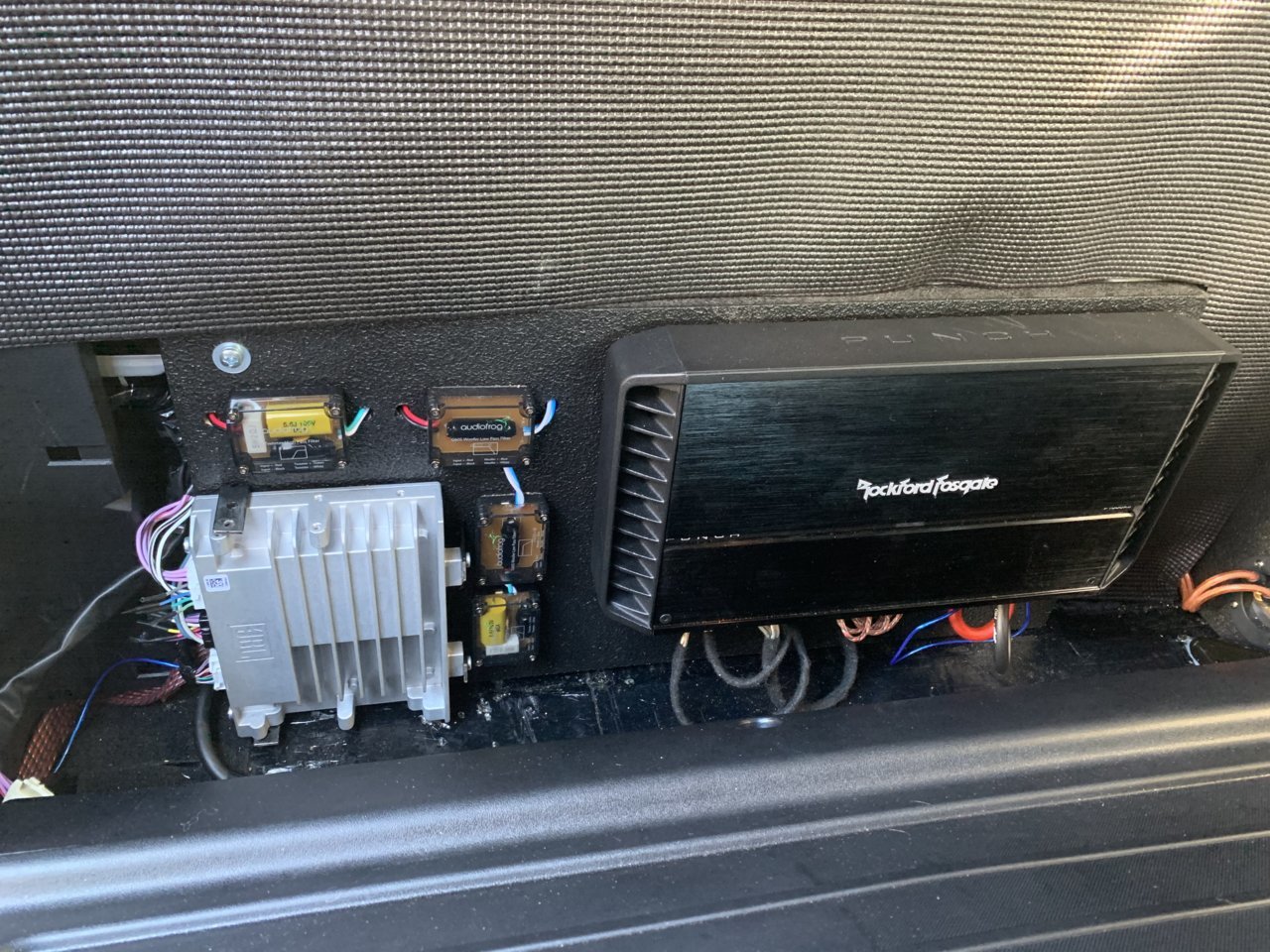

    75E375D8-2571-42F6-BAB0-CCEA806F6571.jpg E0EF25ED-44AC-4423-9A77-482774DA4BCF.jpg BE7E564A-5D0F-45C2-9003-3F770547E5F6.jpg 8D3B9C37-B514-491C-8BF0-C507B68EF9E0.jpg 6FCA402F-67D7-4768-A8D7-4844F215E5BF.jpg Well just wrapped up the install on 2018 Tacoma sport with jbl system:
    audiofrog g60s components up front and tweets
    jl c1 650 for rear fill
    all speakers powered at 75w x 4
    sundown sd3-10 dual 2 ohm wired to 1 ohm at 500 watts
    Box and speaker adapters from Marv
    coated with duratex rubberized coating
    p1000x5 Rockford Fosgate amp
    Noico 80 mil sound deadening on rear wall and inside of outer shell and inside walls as well on the doors
    speaker rings
    Amp rack I made
    Be gentle, let me know what you guys think. I haven’t done car audio install in 20+ years.

    Very nice!! I like the amp rack. Very clean install.

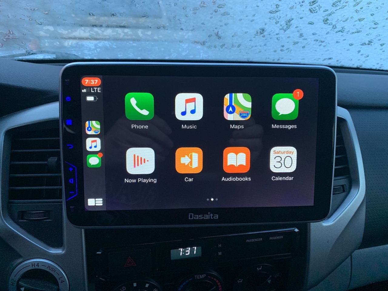

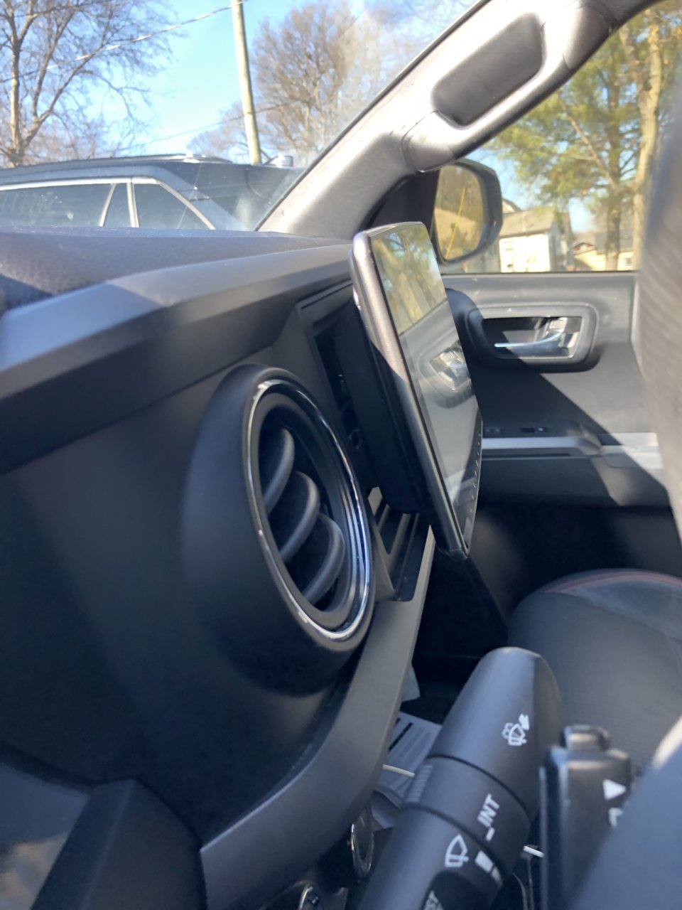

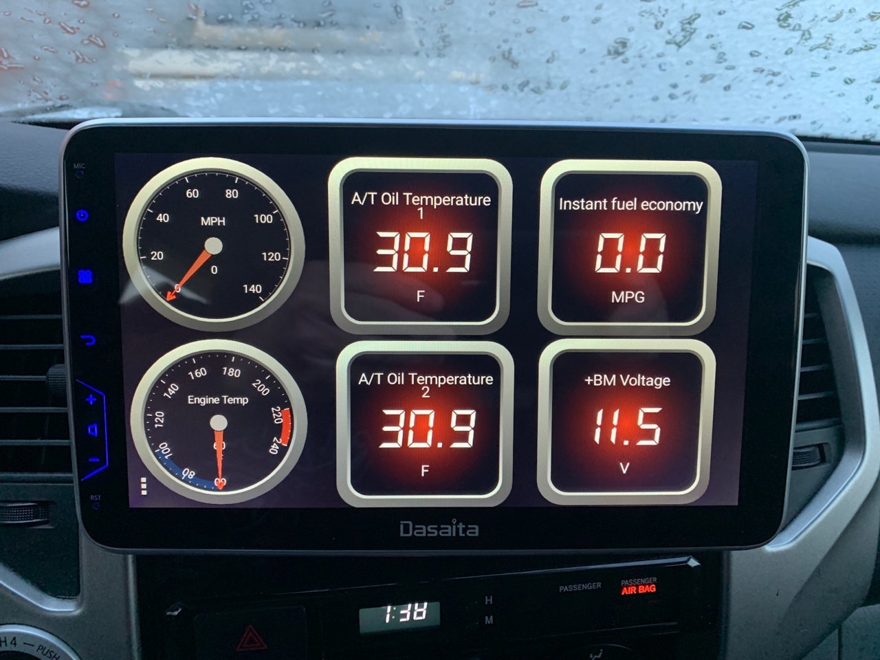

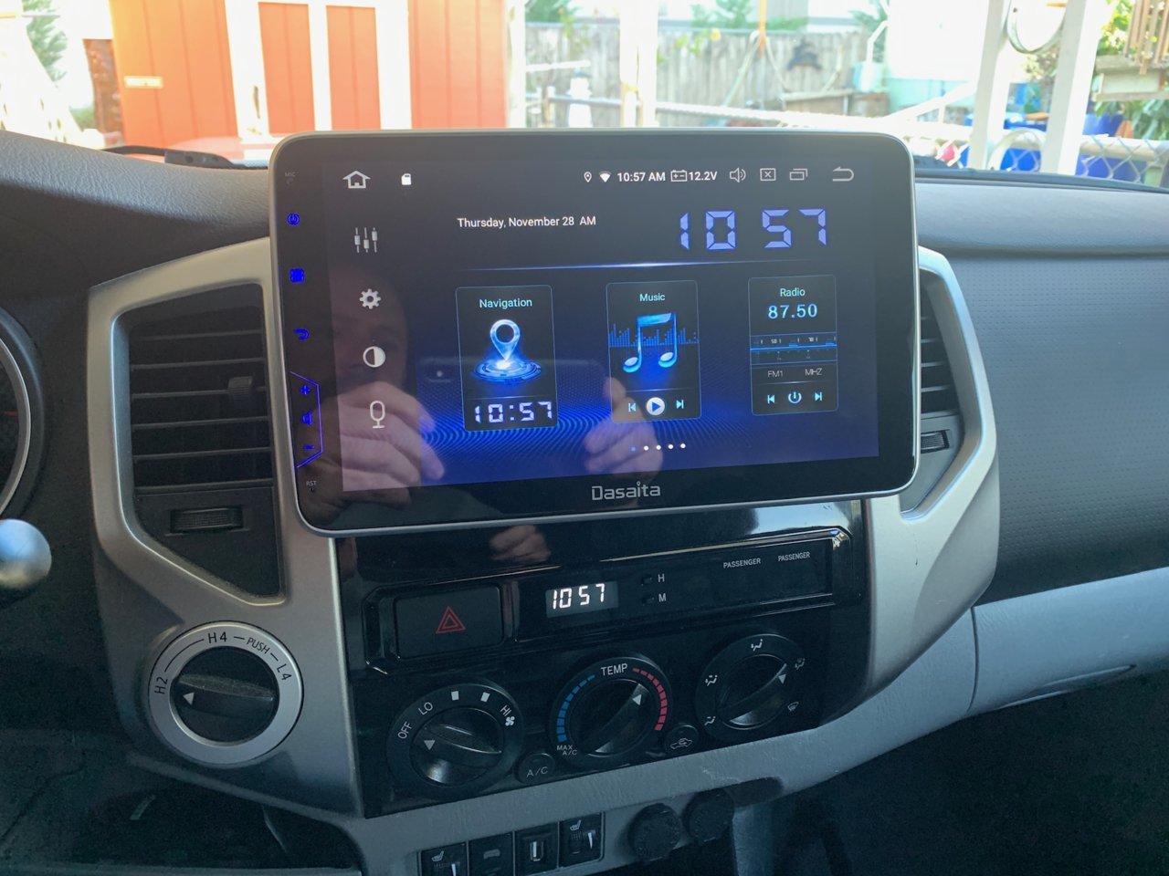

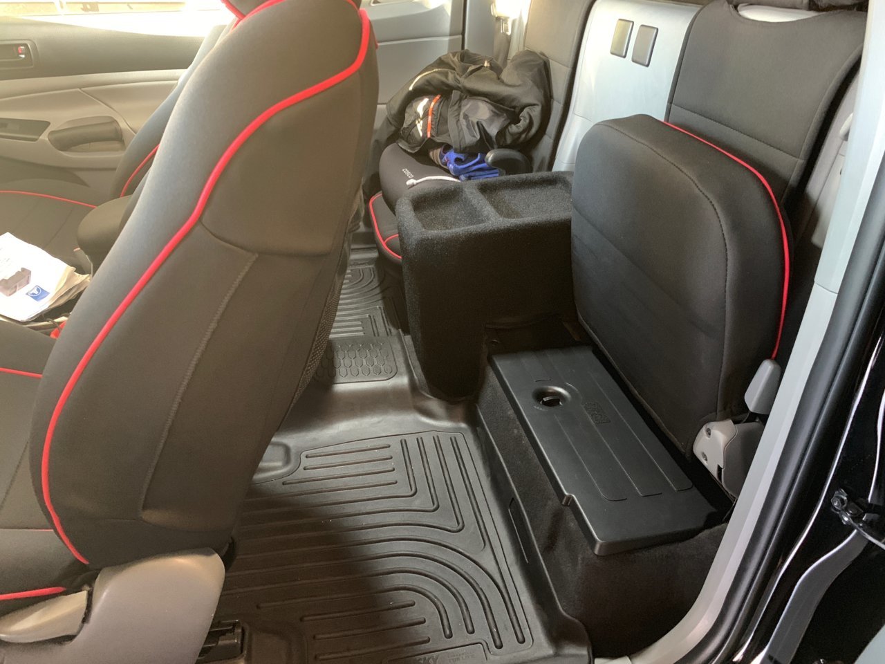

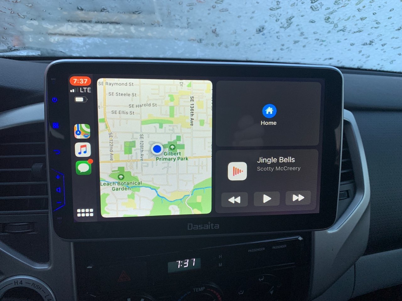

    I also had that Alpine ilx-f309 ordered until I saw it did not come with built in navigation. I know you can get places with google maps and waze and such but I wanted it for when I don't have a signal on my phone. I went with this https://www.amazon.com/Dasaita-Rota...xpY2tSZWRpcmVjdCZkb05vdExvZ0NsaWNrPXRydWU&th=
    I get everything I wanted in the Alpine and then some. It also comes with wireless carplay built into it although they don’t advertise it. I am able to run dual bluetooth functions on it at the same time like wireless carplay and OBD Fusion together. It has a similar look but seems to have a lot more functionality to it.
    40C3E338-896A-4577-8FE9-036BFBC3D0F9.jpg 40C3E338-896A-4577-8FE9-036BFBC3D0F9.jpg 06927EC2-693D-4522-9056-FC374D8201EC.jpg 44768467-5743-4709-98D5-1973F47AD3F1.jpg FF2840A0-A17A-4638-97A7-2702FDD8182D.jpg

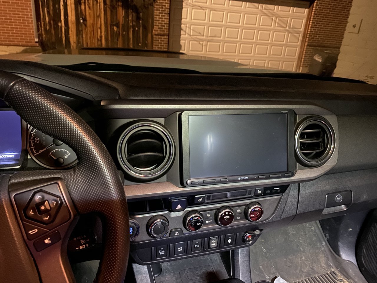

    Just did a test fit of the new Sony 9" AVX-AX8000... fits perfectly and was able to get it flush against the dash so it doesn't stick out like the Alpine Halo9.
    Still have to get it straightened out a bit and complete the wiring, will post some photos once done tomorrow. Will require some custom work to mount flush like this against the dash trim bezel... if you want it sticking out more- no custom work would be required.
    Will update here:

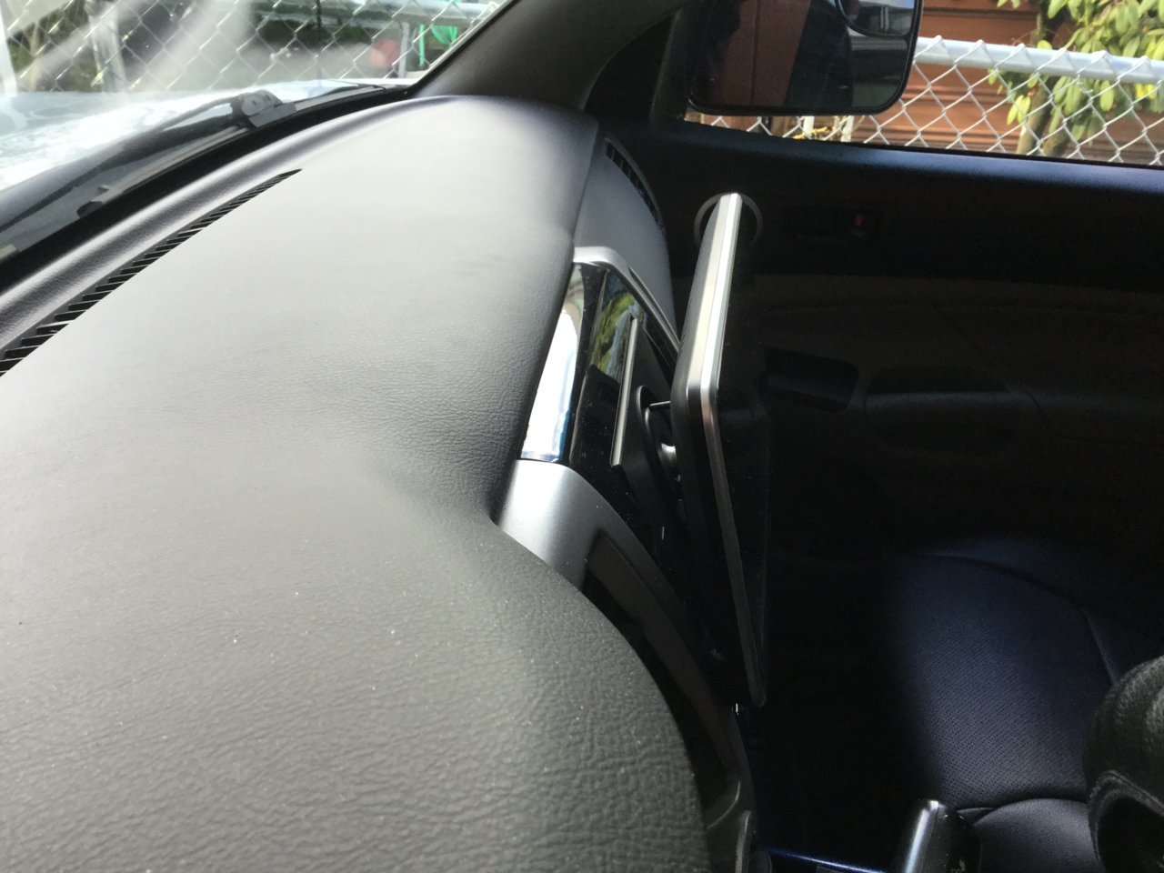

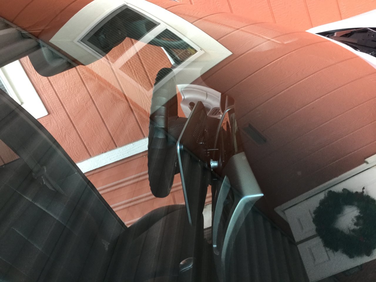

    Corvette homelink FRONT: 5100 Blinstein set at 0 Procomp 3" leveling kit Allpro UCA’s. REAR: Icon Multi Rate RXT Leaf Pack 5100 Blinstein. 17x9 kMC wheels 0 BS 285/70 17 Wildpeak A/T4W C range Amp research steps. and a bunch of TSB's
    Do you have a picture from the side? Also, does it work with IPhone?

    Given the way my driveway is with my carport these are the best I can get you from the sides right now. Yes this works flawlessly with Iphone, I have the iphone xs max with latest updates and 0 issues. The head unit is almost the same as alpines halo just a lot less with a lot more options.
    Thank you for the pics
