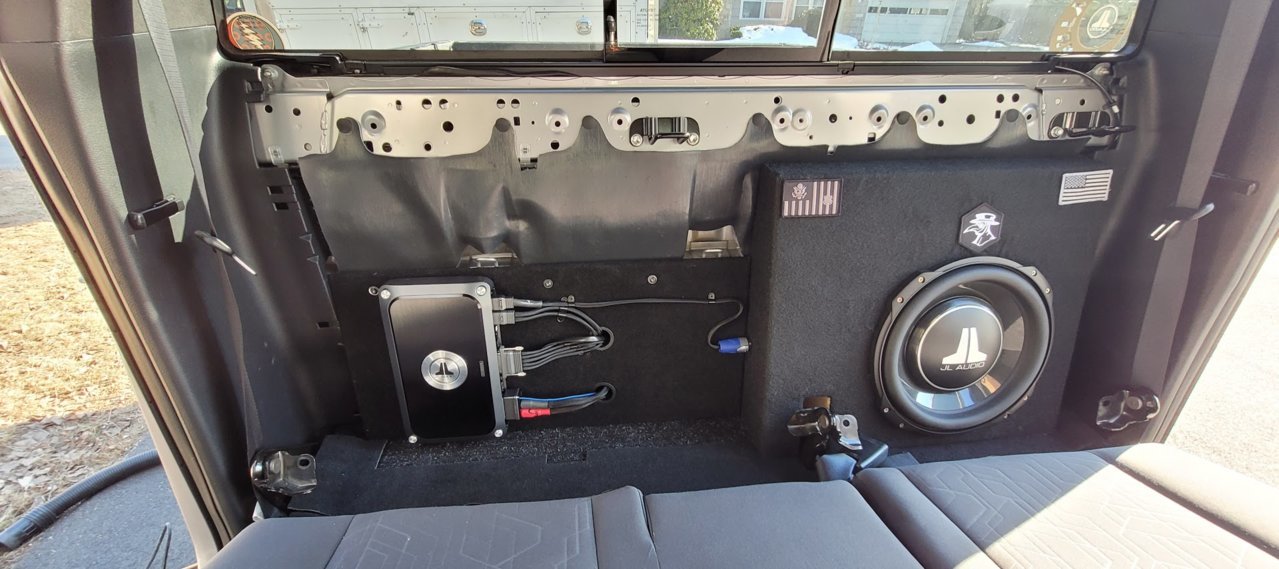

    2020 TRD 8" non-JBL, Could have done a cleaner install but I was physically exhausted and just wanted to get it done with. Boo Boo'd and drilled 2 xtra holes in the rear passenger seat back bin "left side" but no one can see that with the sub box in place. I was to burnt out to take apart the back seat storage bin plastics, drilled holes with bin in place and finally on the 3rd hole I drilled the "bottom" of the bin and with a wire I was able too fish my sub wires thru. Learned a lot from TW members and from my mistakes. Kicker Key amplifiers and JL entry line(C1) front 6x9 components, rear 6-1/2"(?) and Stealthbox(very snug fit)
    tt add an amp harness w/splice in for input to subwoofer amp, amp rack under passenger seat. I installed front(1-1/4")/back(1-3/8") seat jackers to clear the passenger under seat bar. A 1" back spacer did not have enough clearance between the under seat bar/amp. You might ask me if a 1-1/8" or 1-1/4" would have clearance but let me tell you... Man, I had a HELL of a time getting the seat lined up to reinstall the 4 bolts(being a Newbie at this). You have to line up the seat and rack, it was slipping sliding, off center, yada yada yada
    I was contemplating the OEM+ Ref. with dedicated amp. In the end I decided to go with a 10" subwoofer. I believe a subwoofer adjuster knob is a must have, installed as OEMDaniel showed how in Jesse Rizo yt transferring the system from his '18 to '20.

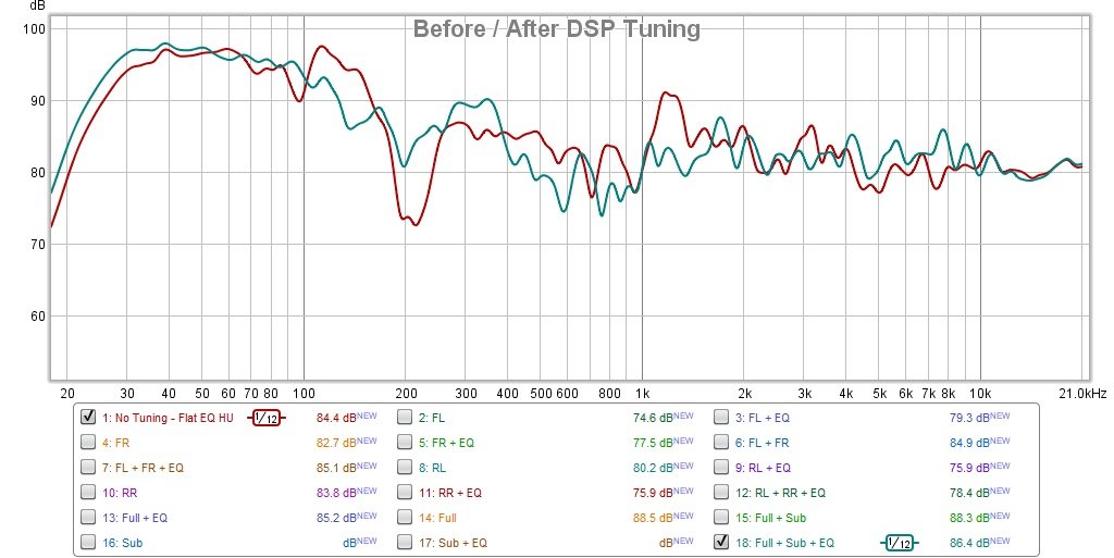

    So I went ahead and installed a Dayton DSP 408. Took my time rewiring and installing it, and spent a few hours this morning tuning it up.
    Spent a good deal of time getting my L and R channels to match and was pretty happy with the initial results.
    Finally put some music on, and just listening at normal levels my sub cut out.
    After poking around it seems a Voice Coil went out on the sub!!!
    Unsure why it happened. Really scratching my head on this one as I never touched the amp settings and if anything I cut signal to it, and might have skipped through like 3-4 tracks then nothing. Kinda pissed.
    ill have to see what NVX will do..
    I used leftover MDF and simply screwed through the carpet into it; worked like a charm.
    Here my Fronts and Rears L/R
    you can see how insane it was before:
    and a full sweep -- I need to work on the transition between 200 and 800Hz; but overall much better

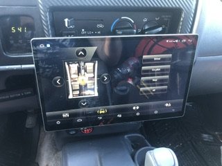

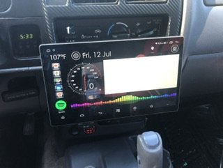

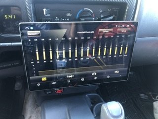

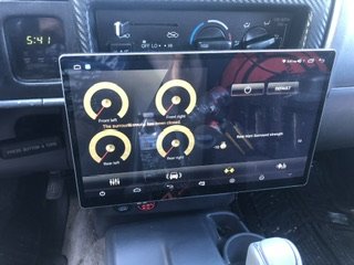

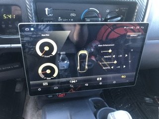

    IMG_0893.jpg Joying 11.6” Android 11 based double din. WiFi, Bluetooth, all the bells and whistles, I can even put a SIM card in it and I have a mobile network all the time everywhere I go which allows me to make my truck a hot spot too. It was about $600, prett new and cool when I got it so it was worth it to me despite the quirks and hiccups here and there. Joying’s customer Service has wen more than helpful though. IMG_0892.jpg
    Oh yeah, the thing has an insanely adjustable EQ if you’re into that sort of thing dialing in your system I recommend it. DolbySorroundSound for watching movies. Pretty sweet.

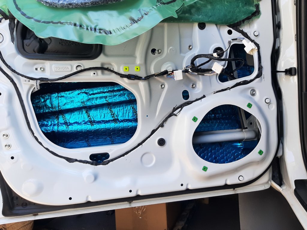

    Upgraded my dash speakers to these sweet little mid tweets. Wider range then my buddy's ds18 bullet screamers..
    quite happy with the sound from them and I am picky.
    Also insulated doors and replaced the garbage that was in there..
