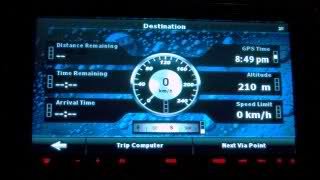

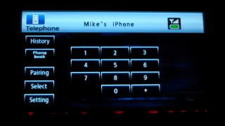

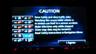

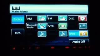

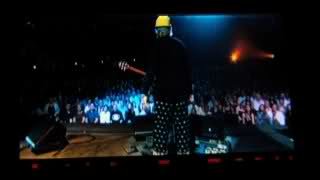

    Here's my Eclipse AVN726E.. Great Unit, Bluetooth, USB, DVD, Backup display, VTR ....
    Pretty nice display, and easy to hook up when we have forum members like Lindwoodm and Hendooman, Thanks guys!

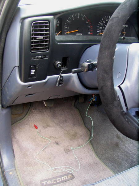

    I've got the same head unit. It's very nice. Not planning on doing the sirius module myself, but it looks like you still need a sirius receiver.
    http://www.pioneerelectronics.com/P...eo/Accessories/DigitalRadio/Satellite/CD-SB10
    Also, the gps is Tele Atlas, not a Garmin. Map updates are supposed to be available this summer.
    I haven't totally finished the install yet. Still need to drill the plastic blank for the mic mount, and connect the parking break wire. I snaked the usb with the provided extension into the glovebox. It is accessible that way. I'm using a pen drive there atm for mp3 playback. The gps antenna is mounted inside the dash, behind the passenger side airbag. It's magnetic and attached to a pipe there with no difficulty. It works fine through the dash.
    I'm planning on getting the hd radio module later, though mounting that might be a bit tricky. I would prefer to mount it behind the dash, but it may end up in the glove box.
    I'm going to be replacing the carpet soon, and I'll be putting some sound dampening in at the same time. Speakers are stock for the moment, but those will be getting replaced when I disassemble the doors to do more sound dampening, and to reupholster the side panels.
    After I installed it, I noticed the sound balance was a little off. The default equalizer is set to powerful. Played around with it a bit and got the best results so far with it set to vocal, and bass boost set to +1. I'm not going to spend a huge amount of time tweaking this until I've got the sound dampening completely done, and the new speakers installed. As one will alter the acoustics and the other will change the speaker characteristics.
    I'm still debating an amp+sub, since I'm after audio clarity not so much volume or powerful bass.

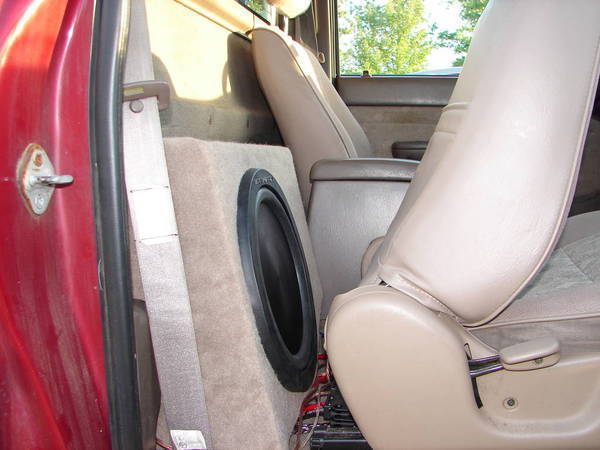

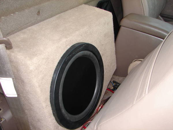

    Found a camera so here are some pics!!! This thing is amazing!! It will play everything you throw at it with clarity and detail while at the same time it if you crank it up it will blow you away.

    what is that and what type of power are/can you run to it? RMS of course

    Its the new Stereo Integrity SI Bm MkIII. Its a shallow mount 12'' 450wrms look a few pages back to see the amp that I am using. Its a TREO amp if I remember right its 1000wrms at 1ohm, 500+wrms at 2ohm.

    ^^So are these the second batch that is shipping now?!?!?!^^^

    No I got in on the first round just took forever to get a box since Im not very good at building stuff.:eek:
