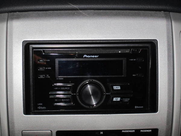

    I got mine off Amazon marketplace. I paid $260 for it. Pioneer states that it is a $700 msrp though.

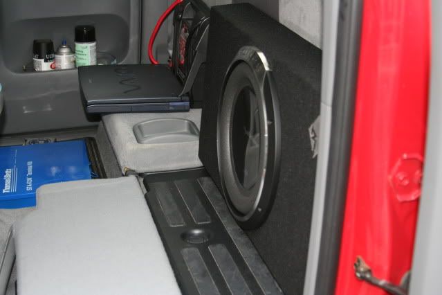

    Super cherry n some champion stuff on the side
    -is that sub a "slim" design? i have an AC too n need a smaller box.

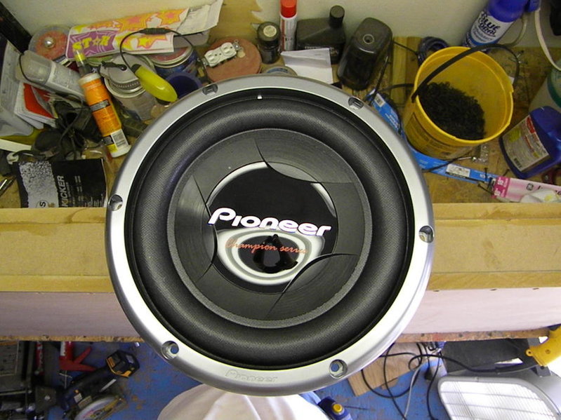

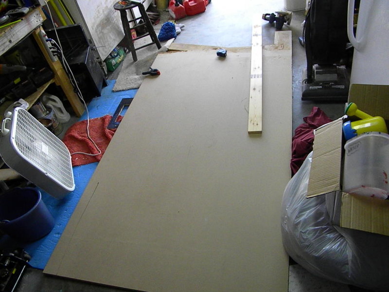

    my new 10's should be here tomorrow so i will be starting my new box today. will post pics of the progress later on tonight.

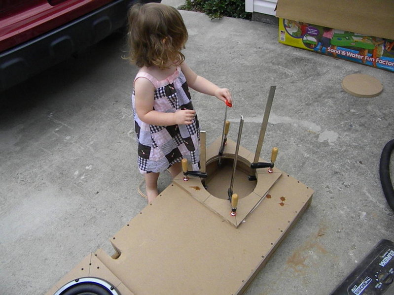

    sure. I'm building a single enclosure for 2 10's. the overall external dimensions are 43wx18.5hx7(bottom depth)x4(top depth).

    if my calculations are correct it should equal out to approx. .75-.80 ft3 of airspace per sub. i also have it split internally to 2 chambers.

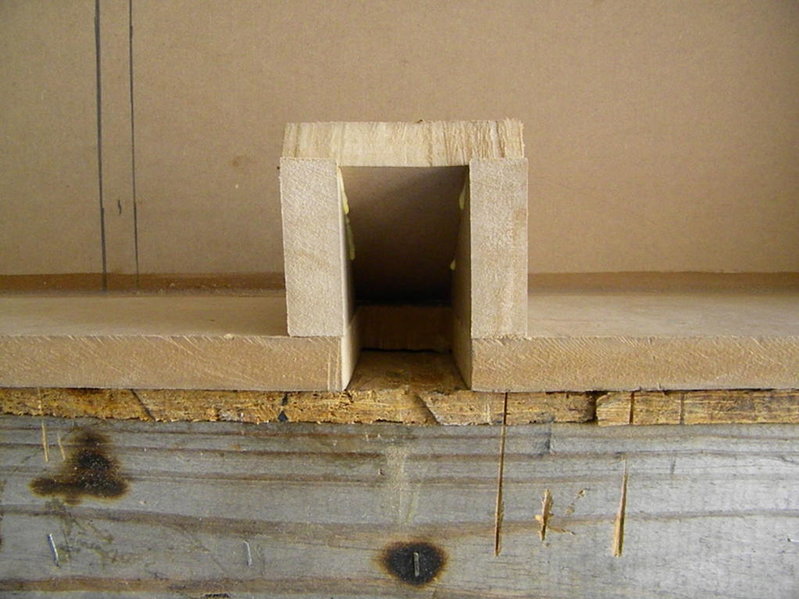

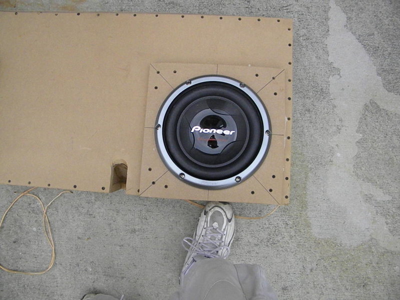

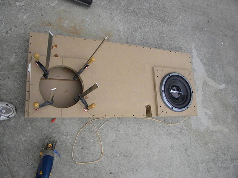

    this is where im at so far.

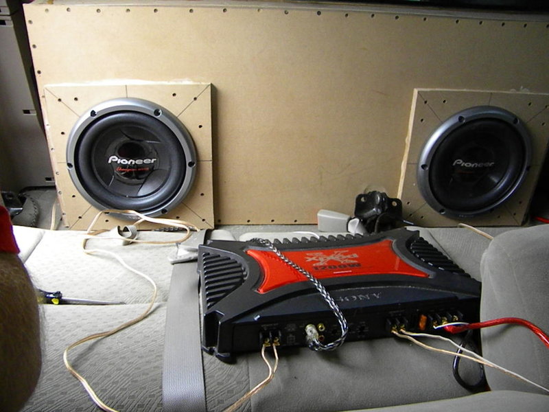

    last set. dear lord it hits like a mofo!!!!!!

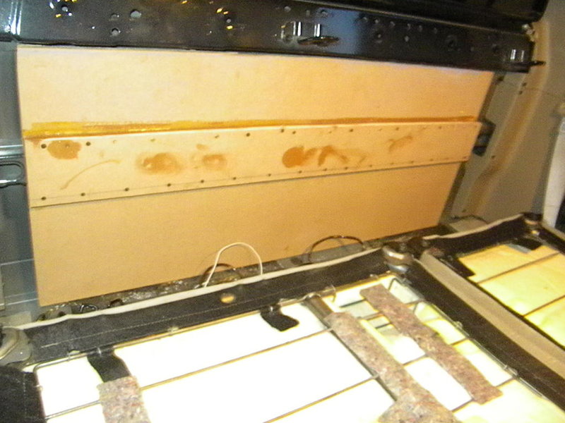

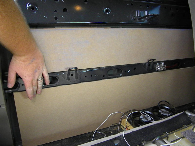

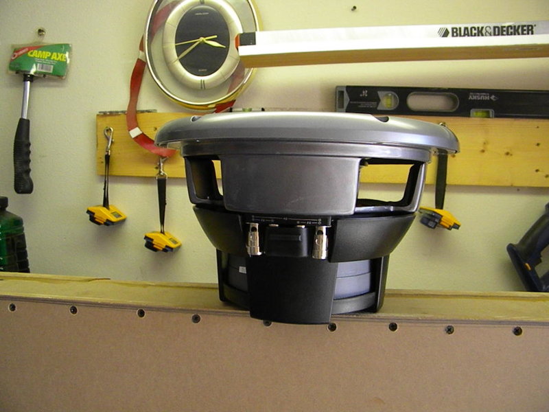

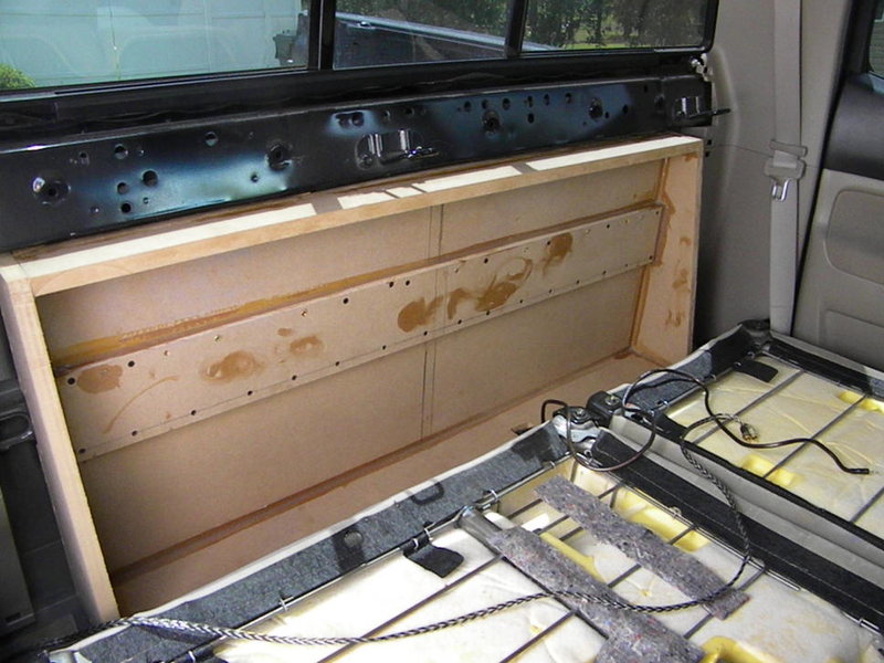

    I saw a comment about DD fit so I figured I'd post a good picture of how mine fit.
    Here's a look at the dual 10" sub cabinet I made to fit behind the rear seat in my double cab. I've had the seat back installed so I know it does fit.

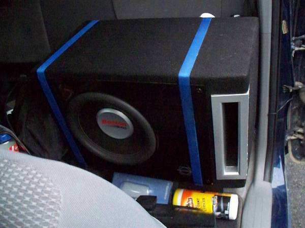

    Write up on how you did the clock lights blue is NEEDED!!!!!!!!!!!!
    black harzad/ac vents come in the base models. this question has been asked and answered so many times.
    heres mine.
    kenwood ddx 512
    boston acoustics g5
    kenwood eXcelon KAC-X10D Amp drivers under seat
    pioneer 6x9's up front and 6.5's in back
