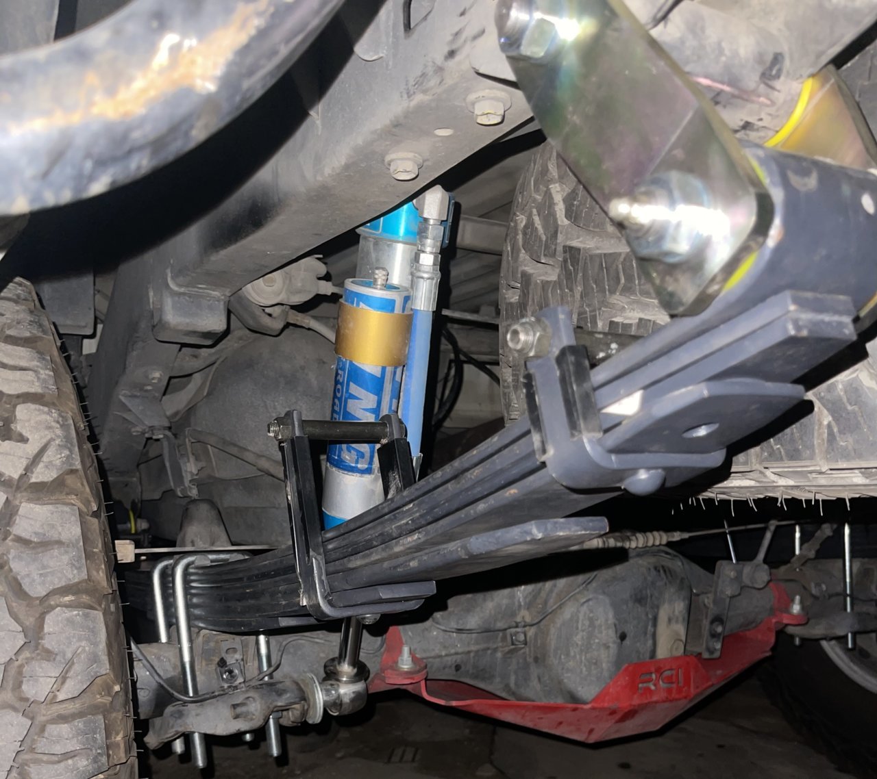

    i was thinking about giving it time but its BOUNCY asf im not joking. I’m planning to remove the 3rd leaf from the top. Its very uncomftorable. I have the 300lbs high roof shell, rear steel wrap around bumper, rear diff armor and 200lbs in the bed thats always ther. But youre saying give it time…..idk if i can do that lol. How bout if i put a lot of weight in the back like logs and drive it like that for a week the take it all off? Will it re settle back up and ride like crap. Idk this is killing me.

    was yours bouncy out the gate? After you removed all that weight how does it ride?

    @YotaGangYotaGang you've only had them a day. I can assure you mine was bouncy too. Time will help. It took mine a good week with weight and some light wheeling to help flex/bend/settle them more into place. I had the same worries you do now.
    Edit:yes they were bouncy at the get go. I still have the weight. Giving it another month.

    aww fuck i dont know if i can justify carrying that much more weight for months lol I was supposed to go traveling this month. I can put 500extra lbs in the rear for a week and take it to a place where I can flex her out, but after thT if it still rides jumpy ill remove a leaf , thx

    My ride is okay now after taking off the aal and the 3rd leaf from the bottom. rides like a dream

    @YotaGangYotaGang tbh i might be doing the same. Tried taking the weight out and it's still bouncy. Feels like a pogo stick.

    remove the whole leafpack from the truck, use a c clamp and slowly let off and the leafs come out, was easy

    Any chance a shock is too short? I managed to get one shock too short and that was pretty awful, zero droop.

    @0xDEADBEEF I'm wondering that too but i thought driver and passenger side were different lengths? I read that somewhere and actually switched my shocks around because i had a hard time putting them in initially. Once i switched them over it was easy. They're 5100s for a 0-2.5 in lift i think? IIRC

    5100s ought to be fine, that’s what I moved to.
