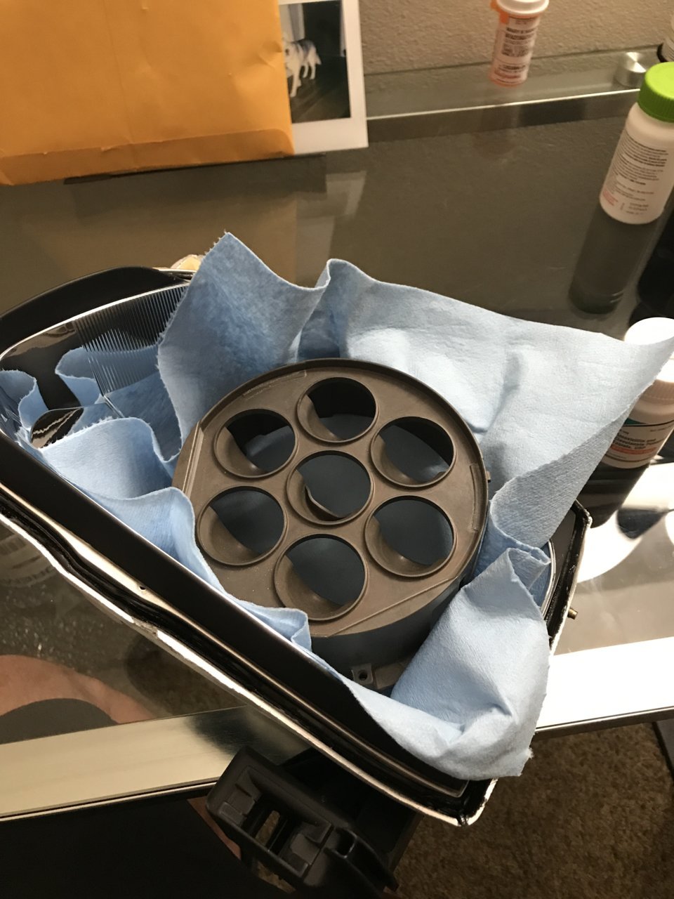

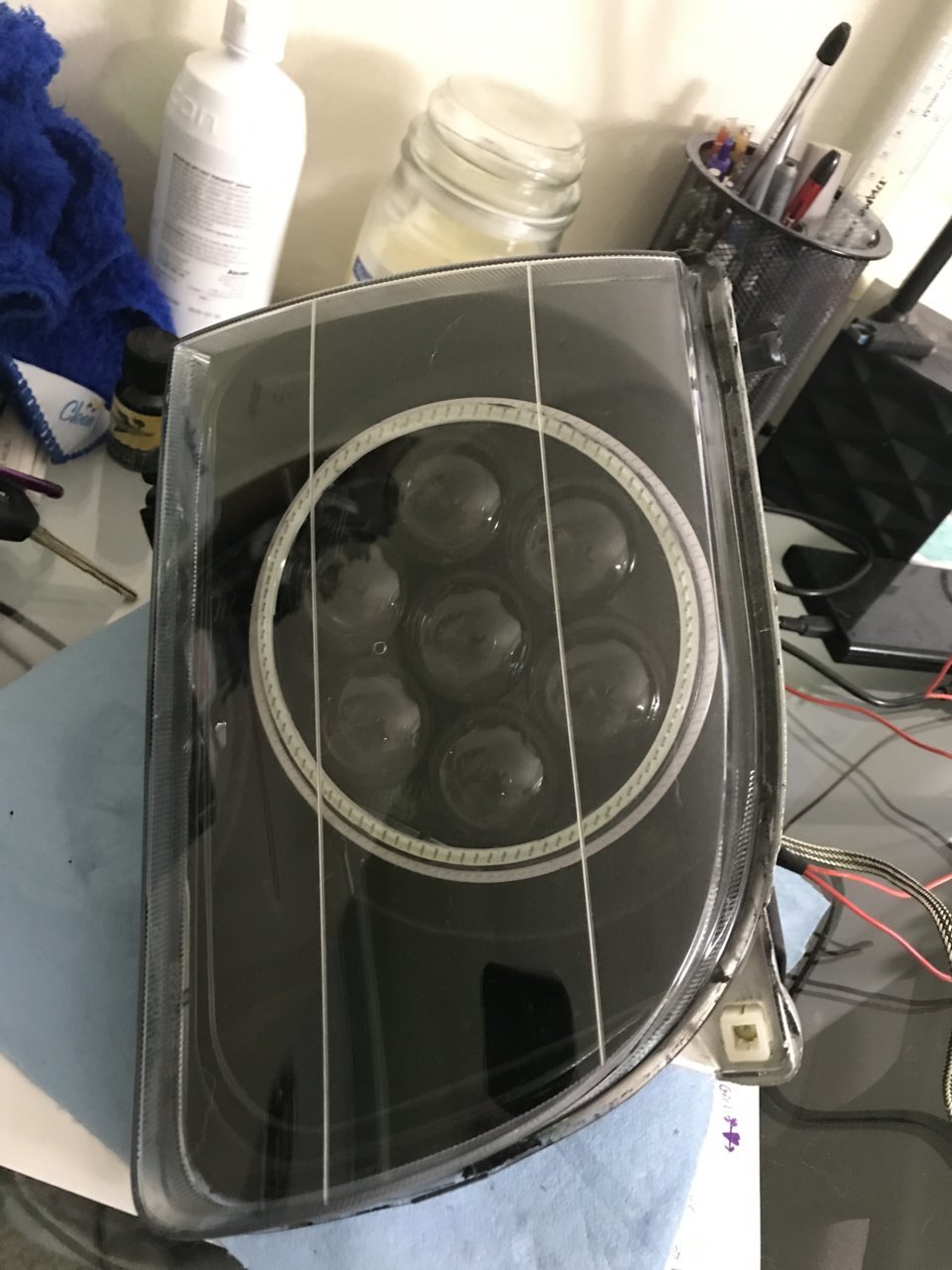

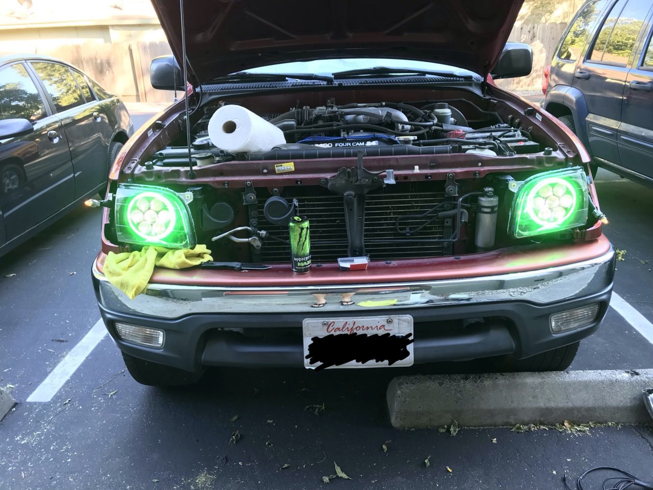

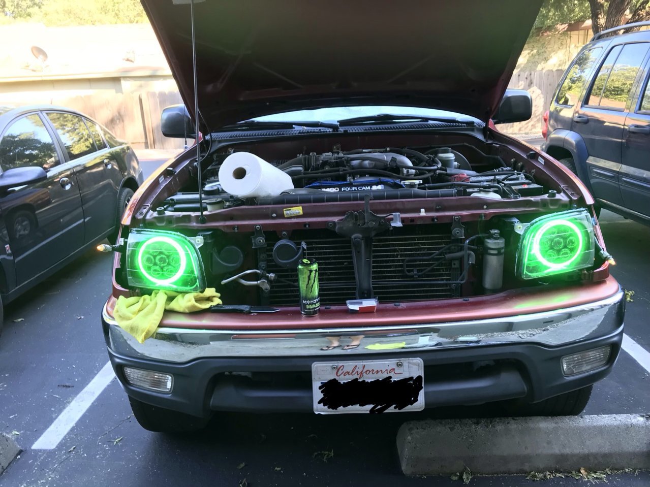

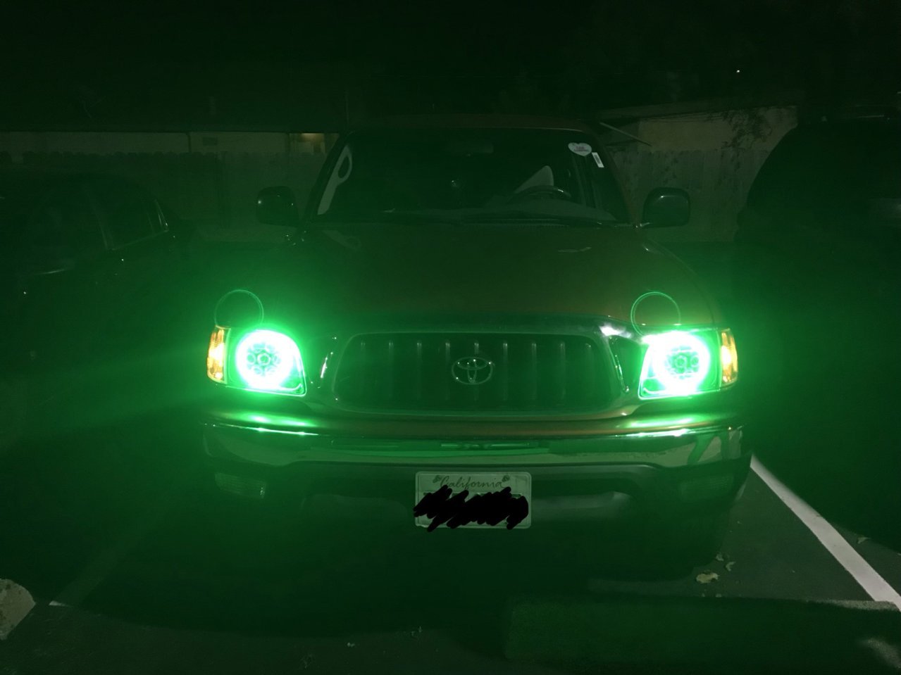

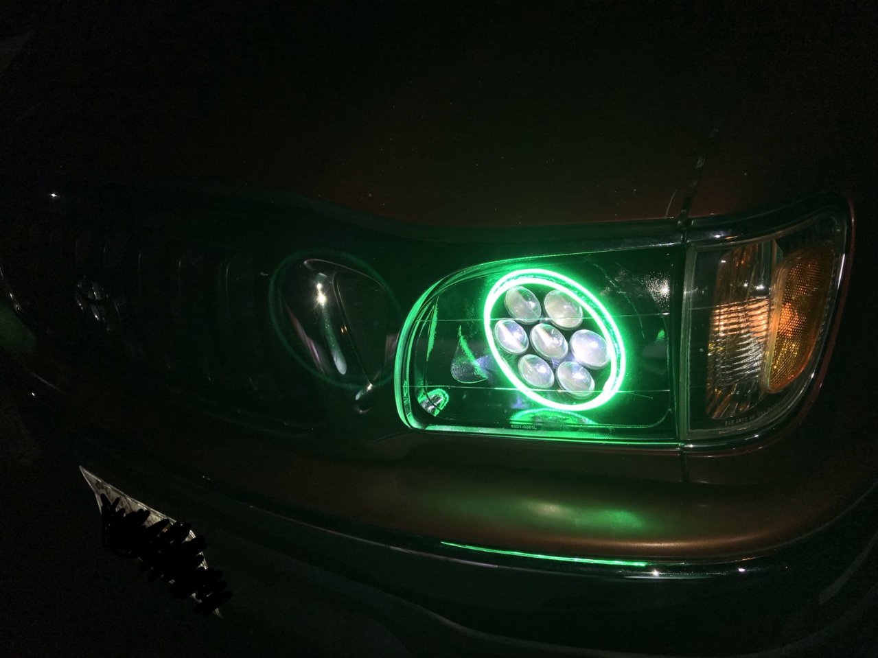

    This is what I just finished up.

    look sick!! whats the output look like? never seen those projectors on a 1st gen tacoma before

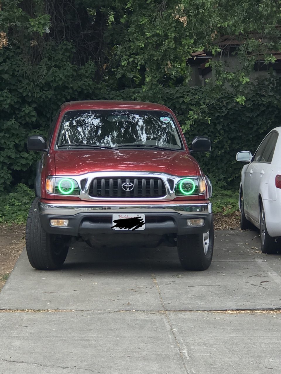

    Really good! They turned out fantastic actually. Crisp clear line right where it’s supposed to be. I keep forgetting to take a beam pattern pic but I’ll try and grab one to upload tonight. I was surprised they turned out so well. I also am running a 35w 6000k LED for my low beam so that helps.

    What parts did you order and where from? I have not seen anything like these LED retrofits before.

    They are low beam only

    Hopefully that means you like them @JasonLee. I ordered infinity Q45 7 lens projector’s off eBay. Also I grabbed some 140mm Chip-on-Board green LED’s off superbrightleds.com. Finally I topped it off with 2 part epoxy, epoxy clay, and JB weld along with primer, paint and clear coat all from the Home Depot. Also I had a small bottle of touch-up paint from a previous project that happened to be the same color or too close to tell. (Both are glossy black)

    Yes they are. There’s some bi-xenon Hids but I wanted to stay LED’s for a while to keep temps down. Have some more retrofits in the works to get those high beams back

    Hey, I didn’t use any of the mini’s. I actually used some stock projector 7 lens’s off of an infinity Q45. The bulbs are however D2S LED 35W 6000k
    Link for reference:
    https://www.ebay.com/ulk/itm/183110977660
    Required lots of cutting and epoxy to basically rebuild the Tacoma headlights around the Infinity projectors.

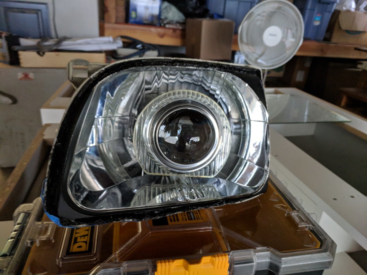

    #243946
    29
    2003 Extracab 4X4

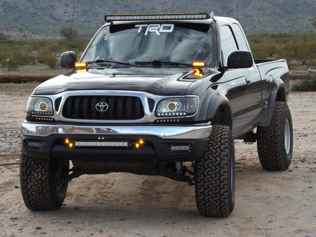

    IMG_20180310_164558.jpg IMG_20180312_193400.jpg 20190720_124251.jpg This is my junk yard budget build on my 03. I initially had some modified e46 projectors on there with clear lenses from a non hid BMW, which had a beautiful cutoff, but I wanted high beams. So I opted for the morano since they have a relatively small footprint for bi-xenons. Everything is from pick-a-part, with the exception of the clear lenses and harness from retrofitsource. Altogether costs was <$125.

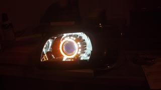

    Engine Performance upgrades: Supercharged (Magnuson) FIC/6 Champion Radiator Toyota Corolla thermostat 168° JBA Headers JBA cat back exhaust Upgraded fuel pump Volant Cold Air Intake With custom plexiglass cover TransGo Transmission A340F Valve Body upgrade B&M Transmission cooler Methanol Injection 2 inch pulley Future Plans Supra Injectors Light weight crankshaft pulley Leather seats Off-road upgrades 3” rough country lift 33x12.5” Dick Cepeks Other upgrades: JL Audio 12W6 Sub in custom box JL Audio C5 Mids and tweets all the way around Sound dampened whole cab Transmission temp sensor Gen Tex rear view mirror (temp and compass) Blue instrument panel, a/c control panel lights, shifter, ashtray, glove box. Blacked out badges Blackout bumpers and grill MariMoto Projectors with demon eyes LED Taillights Second generation leather steering wheel with audio controls Custom leather wrapped automatic transmission shifter 3rd gen 4 Runner key ring light (blue) 3rd gen 4 Runner hood scoop
    Are these D2S with Apollo shrouds and 2 halos 100mm and 80mm?
    what am I missing?
    1997tacomav6 likes this.
