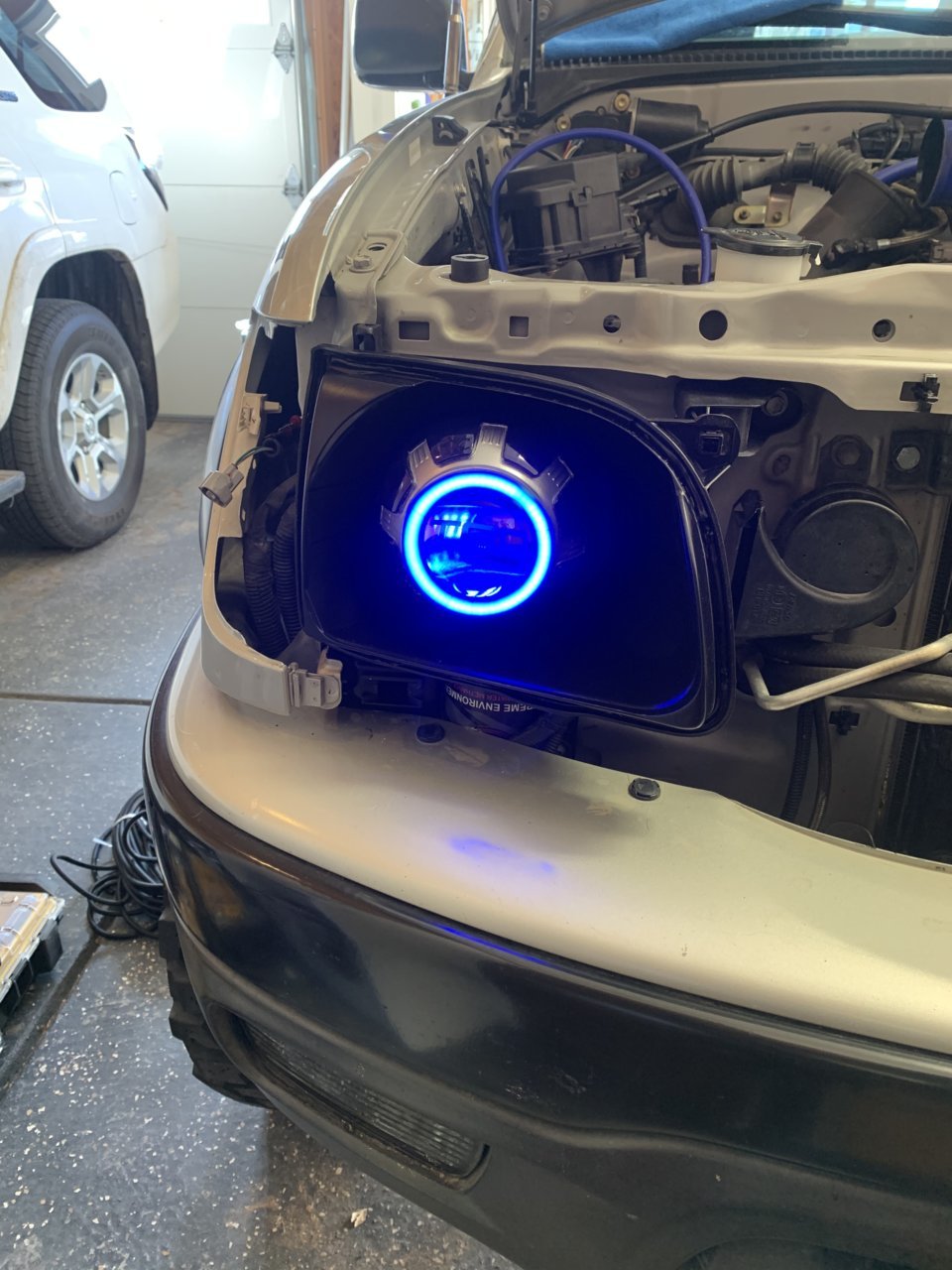

    Well I made it work. I cannibalized the smaller washer to make up for the difference in thickness. Got them aimed and sealed back up but haven’t finished mounting them back on the truck yet. The hoop on my bumper makes it just about impossible to remove/install the grill without scratching the hell out of the headlights. I’ll tackle that tomorrow.
    All in all the MH1 8.0 is wayyyy better than whatever generation I had before. I think they were the 4.0. Overall better build quality and the new bulb holders are fantastic. One hotspot is off to the left a tiny bit but I think I can deal with that. If not I’ll pull the bulb and shim it a bit. I do kind of wish I went with a bigger shroud this go around but I do enjoy the simplicity of not having to cut anything to fit.

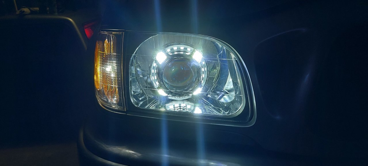

    So,
    I noticed that the Demon eyes have an 12v interrupter on the driver that shuts off the demon eyes when the hid projector bulbs turn on.
    Question: Anyone do this with halos? Looks like the halo have a switch for the turn singles but no Interrupter?
    I suppose I could keep running the halo while the projector is running
    Just wondering what most people do

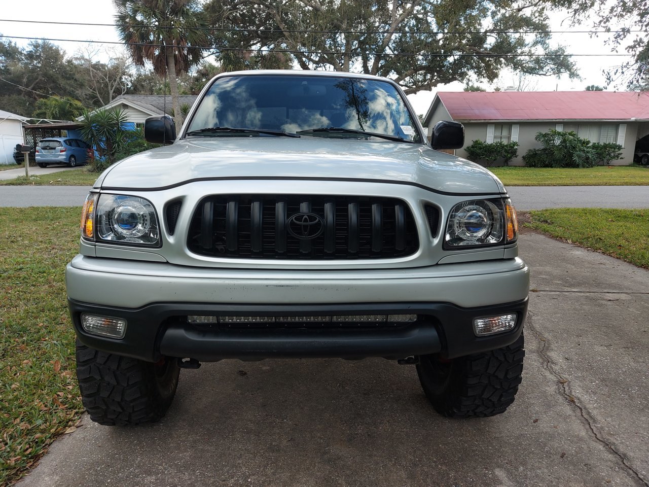

    Finished these up this week. They are great.20201229_162433.jpg 20201230_192447.jpg 20201229_162422.jpg 20201229_162406.jpg

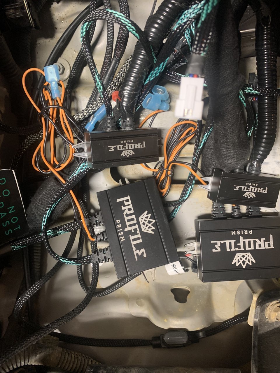

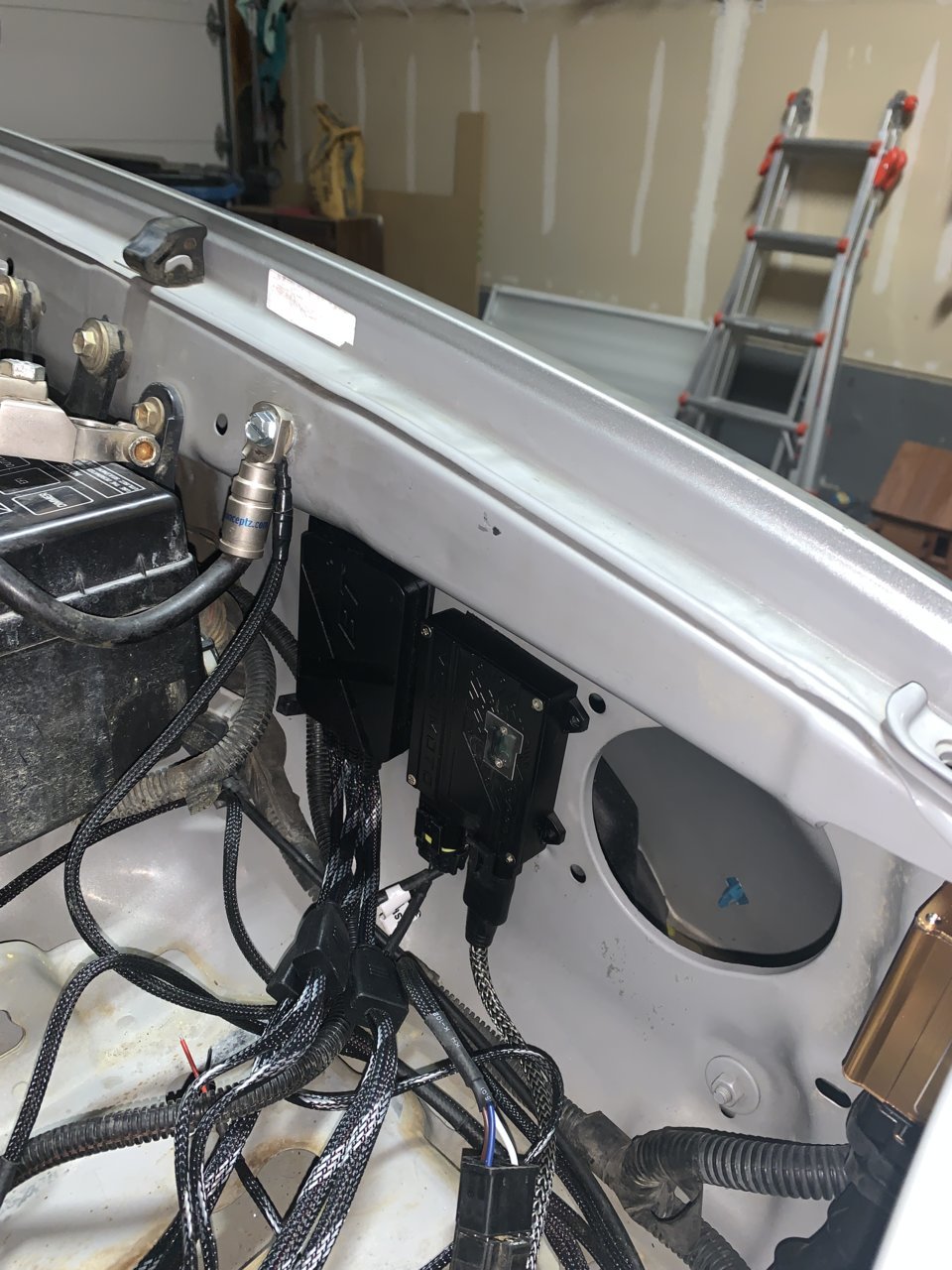

    Show me where the hell Y’all mounted ALL these damn drivers! Looking for CLEAN suggestions
    Here,s where I mounted my Ballast and BT controller (Driver side)
    1997tacomav6 likes this.

    I mounted some on the metal next to where the ground is attached.
    Rldanie[QUOTED] likes this.

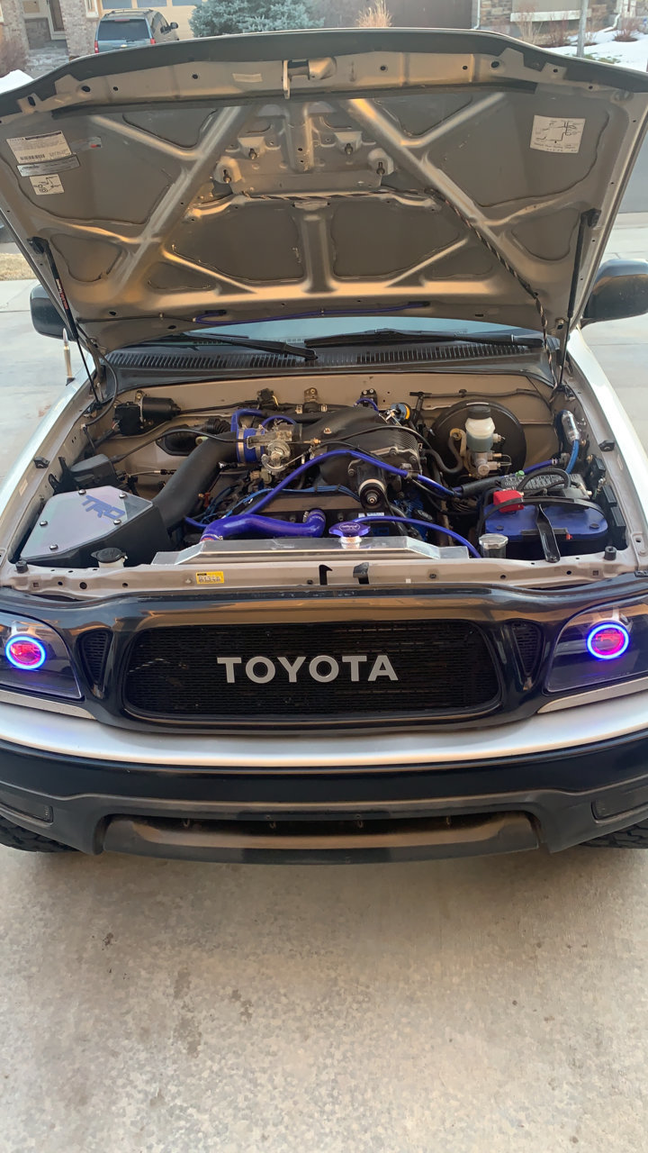

  16. Jan 16, 2021 at 6:45 PM

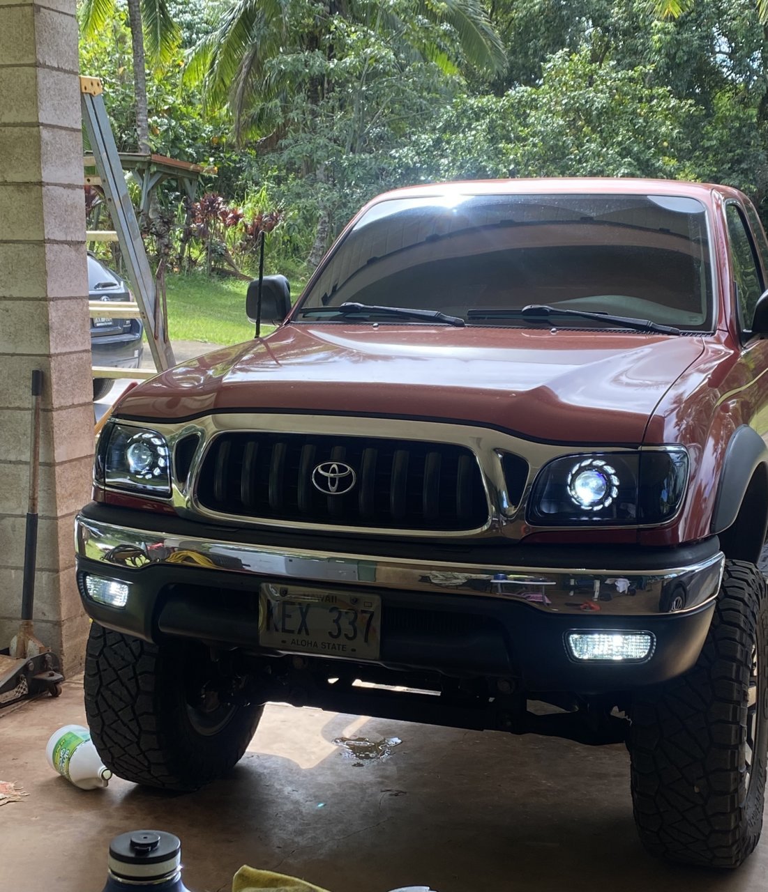

    Small little lighting upgrade....
    Morimoto d2s 5.0s
    Morimoto panamera 2.0 LED shrouds
    CBI gen 2 bulbs
    OEM hella gen 3 ballasts boosted to 43 watts
    3D printed fog light brackets
    Diode dynamics "pro" ss3 pods in fog pattern
