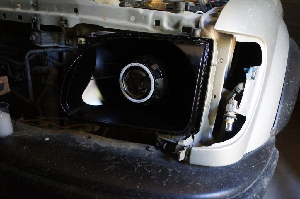

    That my retro i did :D
    Apollo 3.0 shroud. Only required a bit of trimming to fit over the projector.

    Of course, now that you point that out, I see it. No wonder it looks good. Your's is one of the cleanest setups I've seen on a 1st gen.
    So its a blacked reflector and shroud with a single while halo behind the shroud?

    Yup thats it!

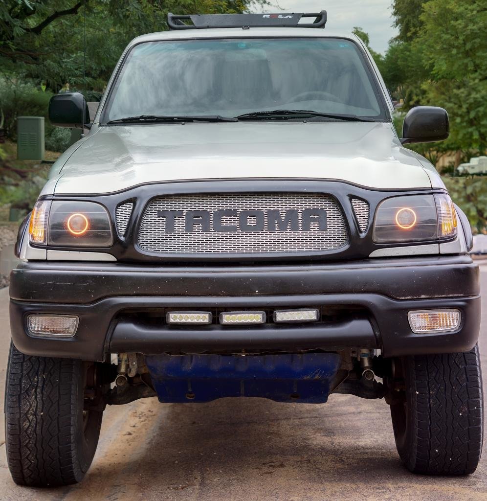

    This is just a crappy cell pic but this is just halos on. I did not focus on the halos, just the bumper though I can get some better ones tomorrow.

    Maybe almost bright enough to be DRLs?

    Ehhh.. Yeah, but its not SUPER bright during daytime.
    I thought about running the halos as DRL's. But thought it would be easier to wire it to the parking lights (which it was).
    If I were to do it again, I would wire is so that when the truck turned on, the halos would turn on. Then, when I wanted the HID's on, the halos would turn off. I've heard that the when the HID's are on it emits a lot of heat, if the halos are on with the HID is causes premature wear on the halos and COULD cause some to burn out. Not exactly 100% sure on that though but i think its what TRS recommends.

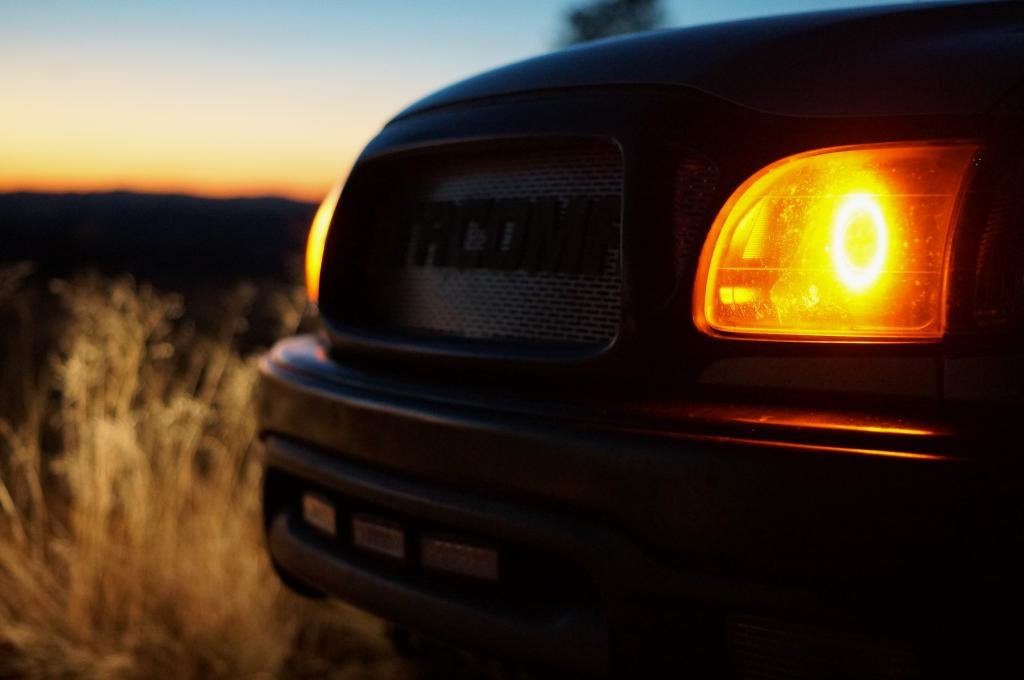

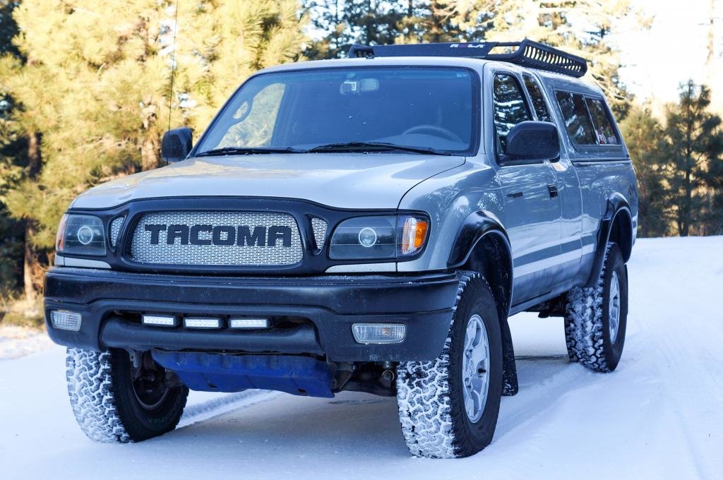

    TRS Morimoto Mini Stage 3 Kit
    Mini Gatling Gun Shrouds/Housing-painted gloss black
    35W 4300k Bulbs
    70mm Morimoto XB Amber Angel Eyes- Independent switch/Daytime use only 90% of the time.
