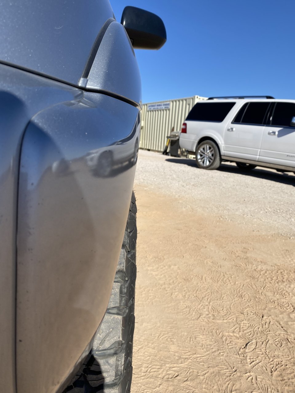

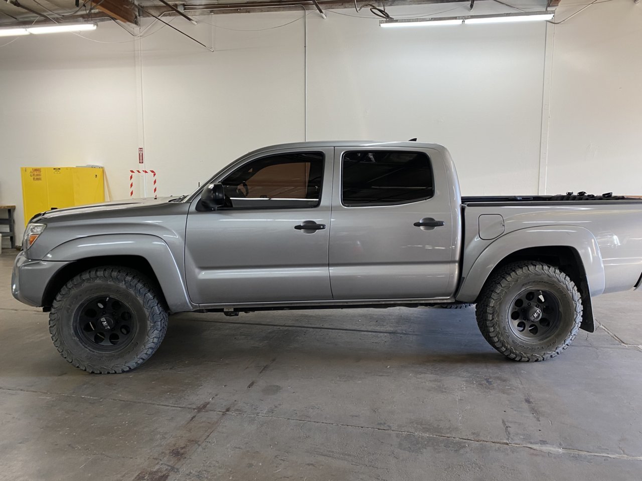

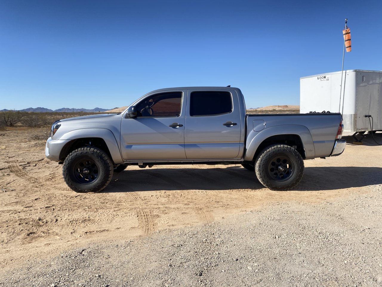

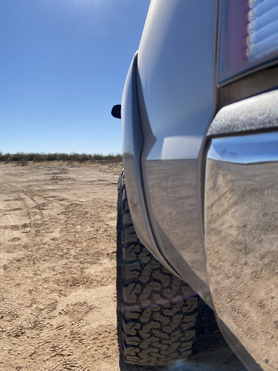

    My suspension was completely roached. Leafs were flat and shocks were beyond blown.
    I researched for about 3 months before pulling the trigger on parts.
    Mickey Thompson classic iii with KO2 LT.
    FOX 2.5 CO
    Camburg ball joint UCAs
    FOX 2.0 rear LSC adjustable
    Deaver j66 10 leaf
    Before
    19.5 DF
    20.5 PF
    21.5 Rear
    After
    23 front
    22.5 rear
    Everything clears. Nothing rubs.
