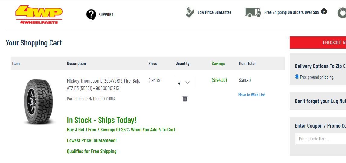

    I don't know where you were looking, but they are not sold out as of this morning....

    That’s weird.. that exact model and size was sold out yesterday

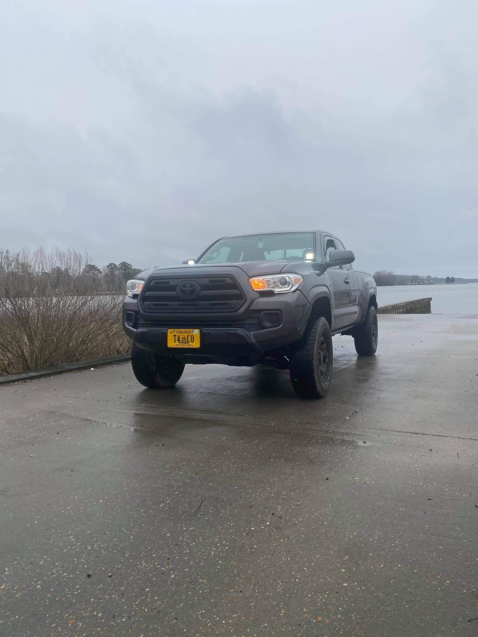

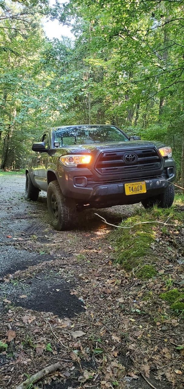

    2 inch RC level 265/75r16’s (1.5in RC spacers)
    265/75r16’s on stock wheels with 2 inch level and 1.5 inch wheel spacers. I have full range, it clears cab mounts and bumper by about an inch on flat ground full lock. I’m going 285/75r16s next with a -12mm offset wheel next.
    I ran them without the level and spacers and still no rub, except for where my bumper sags and it was only in reverse full lock . It broke when i was getting pulled out a hole the second week I got the truck lol. The other side cleared fine.

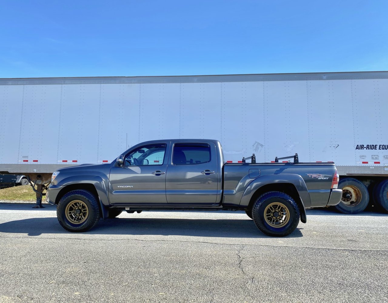

    Nice wheels! Care to share wheel and tire info? Thnx!

    Thanks. They’re Enkei RPT1’s. The tires are Wildpeaks.

    Woohooo! Had Wildpeaks on my last truck and really liked them, great in the snow and good road manners :thumbsup:

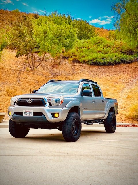

    2014 w/ 16x8 et 0
    265/75/16 Falken Wildpeak
    2" wheel spacer
    3" Toytec lift
    I rub on the cab mount in reverse at full lock - no rubbing otherwise

    What offset were these rims?

    Offset on rims?

    Rim offset? Any lift? I’m looking to do same
