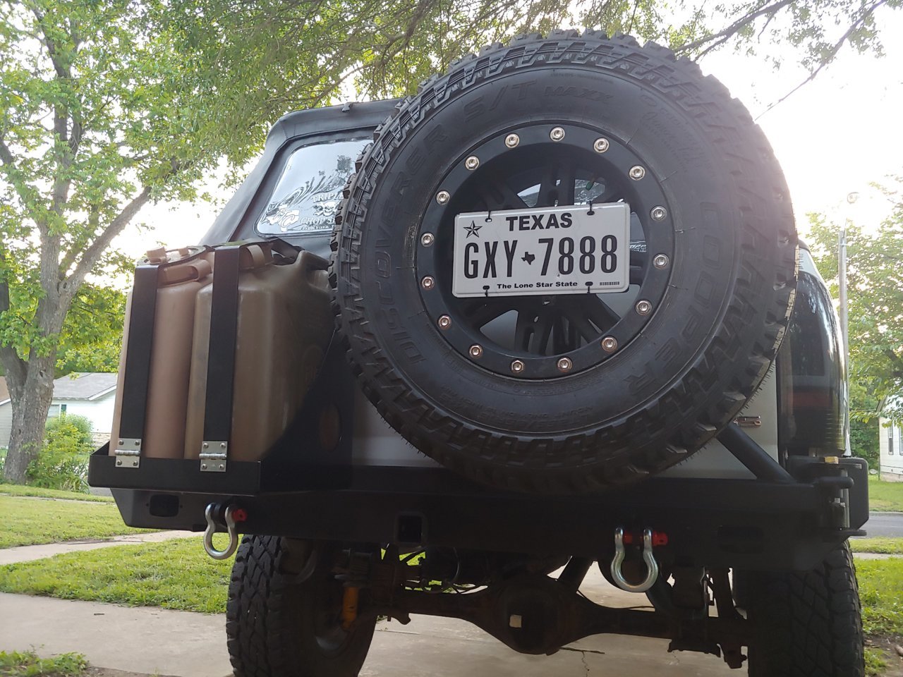

    Which Fuelpax is pictured in the first image?

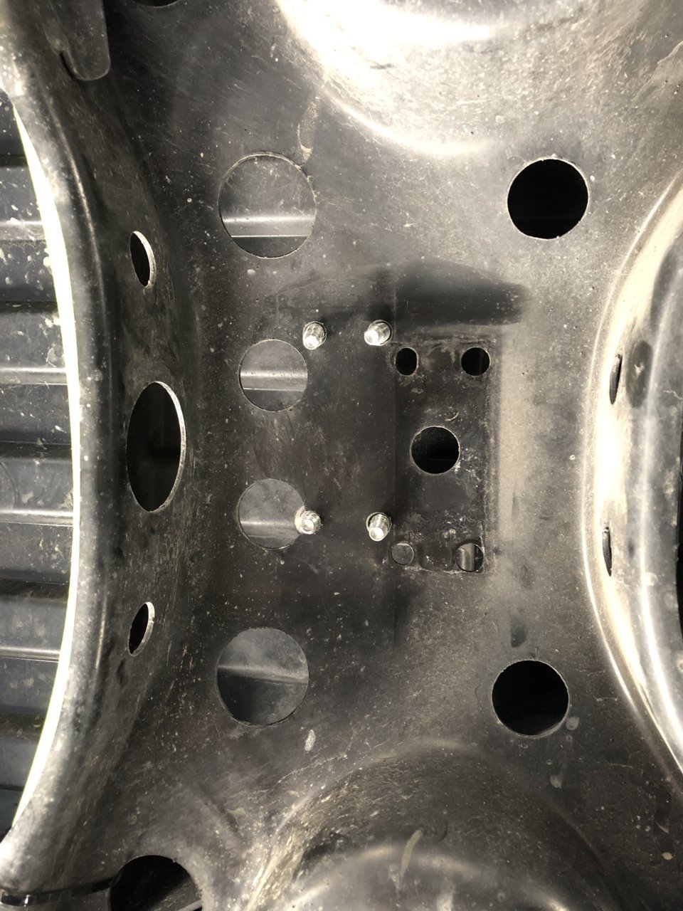

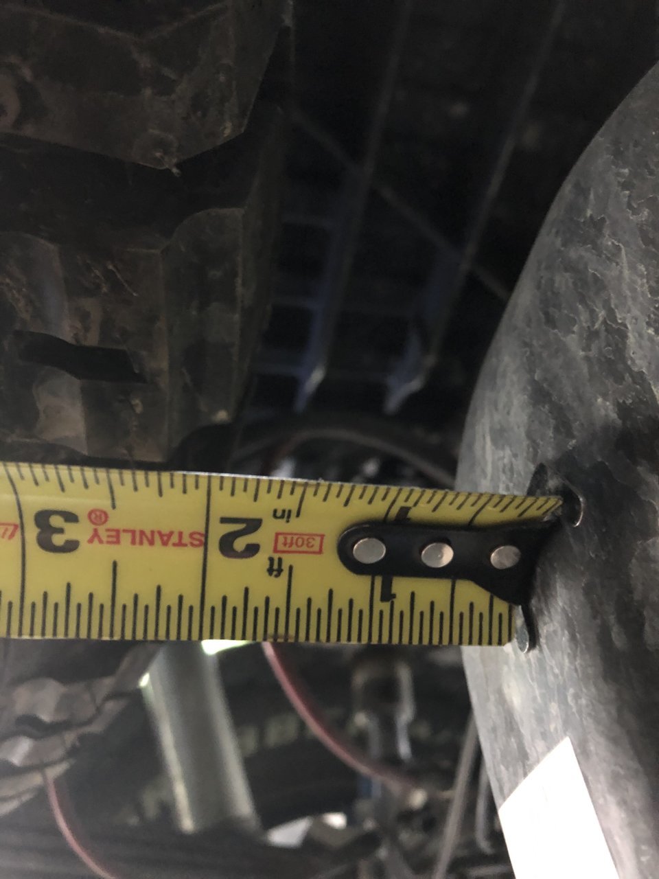

    About halfway done...
    I can fit a 285/75/16.
    I did move the tire elevator about 1,5” back and 3/4” to the passenger side.
    I clear the differential with inches to spare. Does that help?

    On our 05 Double Cab Short Bed the cable for the stock spare tire hoist is 17.25" from the hitch tube. At ride height the back side of the diff is 33.25" from the hitch tube. At ride height there would be room between the tire and the diff, at full stuff, not much at best. This is the first I've ever heard of moving the hoist and personally I wouldn't bother.

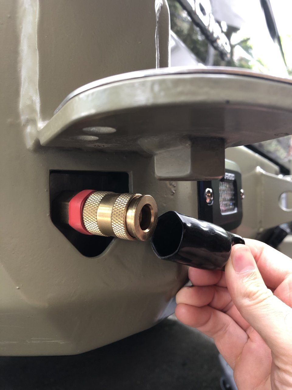

    The bumper has exceeded expectations so far. So much more protection than stock and only about 15lbs heavier. I haven’t finished modifying the swing out gates so I don’t have those mounted yet. I can’t use the hi-lift points because of the swinging bracket but I found a creative use for one of the openings.
    So I have a horizontal measurement of about 34.25” from diff to hitch. Maybe DCLB is different :notsure:
