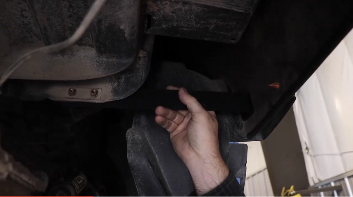

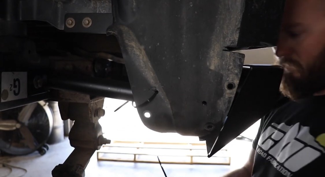

    Question for those of you with the HC bumper & @traxman25 .
    Thinking about getting one, but have a couple of questions. I’ve read through the installation instructions and didn’t see this covered there, but if it is I apologize.
    What is your solution for keeping the bedside fender stable and keep it from flapping around after cutting the bedside? Below is a picture of what CBI does. Do you supply something like this or is it up to the customer the fabricate?
    15D35157-CFBB-4FF6-ABEB-6F831C3C4BE6.jpg 83859154-6A7C-4FEF-B623-B8AD0EF1DCF6.jpg
    Alongside that question - do you cut this piece of the fender liner off or do something similar as below?
    Thanks!

    We don't have that bracket. You could zip tie the inner fender skirt or cut if off, either is fine and up to your choice.

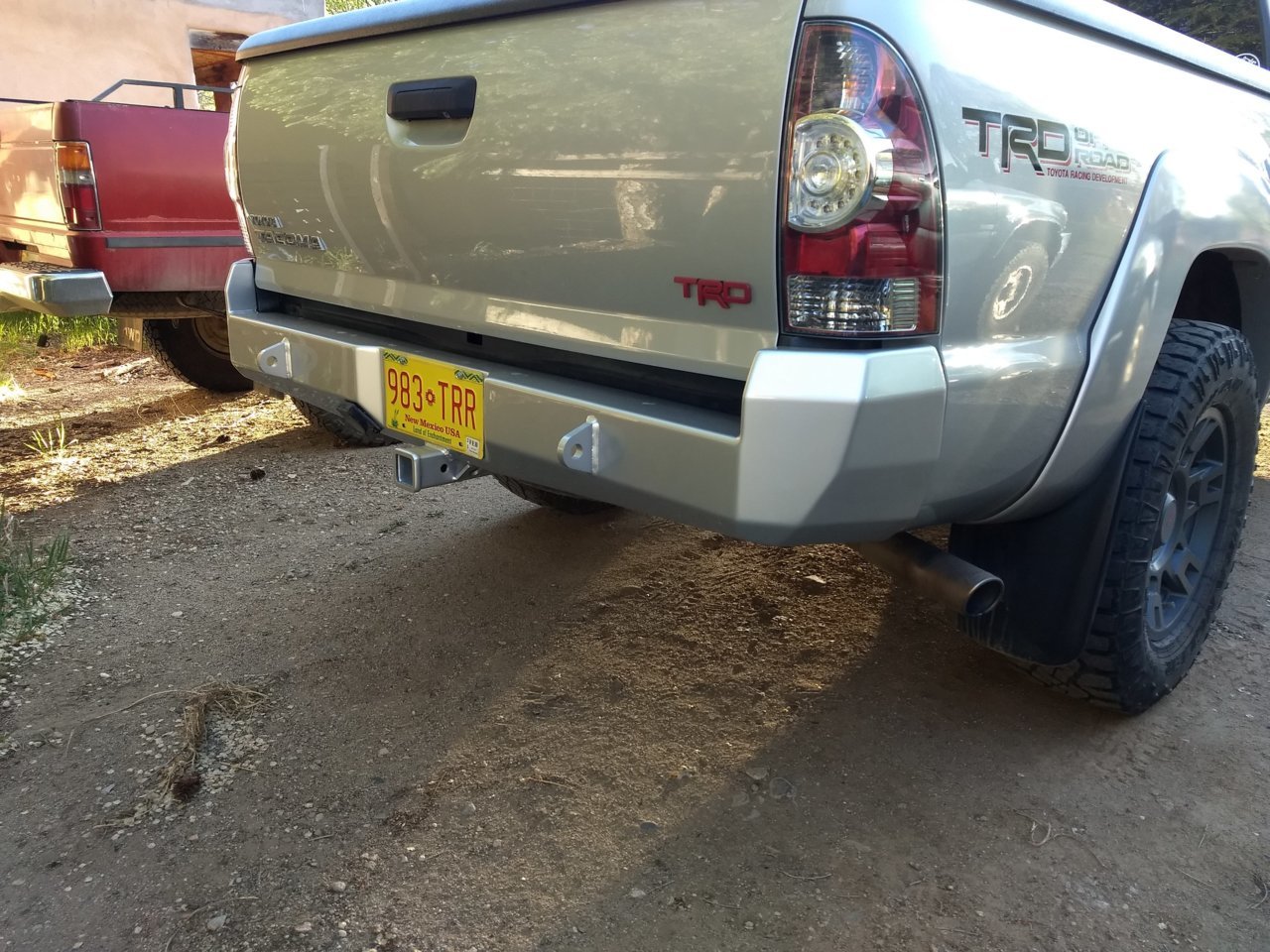

    Finally painted and installed my bumper. Excellent quality, perfect overall fit, easy install, looks great - stoked on the entire thing! The stock bumper feels so cheesy compared to this thing.
    The only issue I had was that the factory trailer wiring harness didn't quite fit... on my 2015 Taco the harness had an "L"-shaped plastic cover from plug receptacle to wiring loom, and that plastic cover interfered with the square reinforcing tube inside the bumper. I simply removed the cover, used a razor to trim the plug receptacle slightly for a better fit, mud/water-proofed the wiring with plastic and electrical tape, and bolted it in there. Completely acceptable to me, aftermarket parts are going to have differences from the factory ones.
    Definitely recommend. Thanks Adam!
