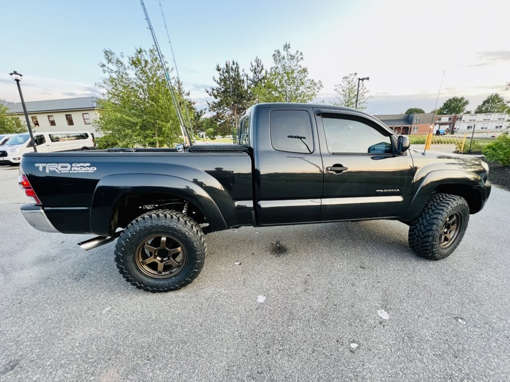

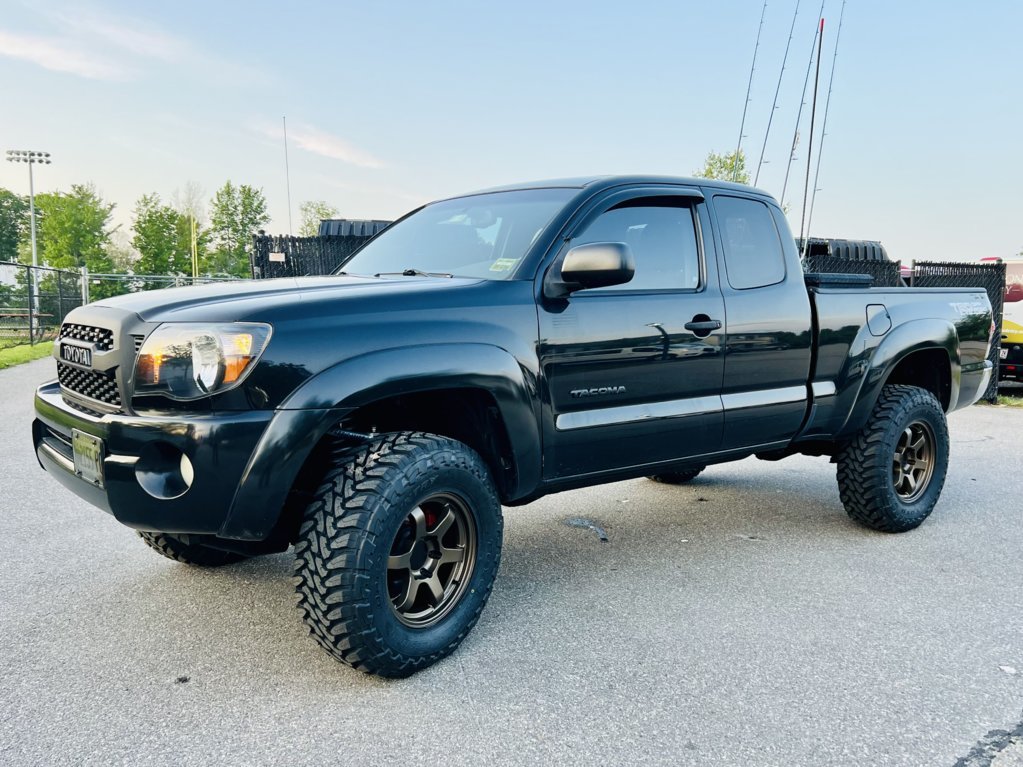

  2. Jun 17, 2025 at 11:30 AM
    TOYOTA 09
    TOYOTA 09 Kicking Ass Since 1981
    Feb 12, 2010
    #31266
    1,003
    Maine
    2009 SR5 MT 4x4 Access Cab

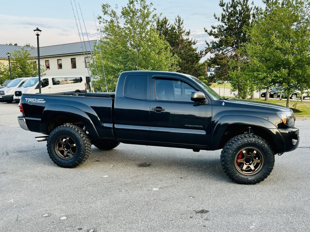

    Preview 2009 SR5 4x4 MT Black Sand Pearl (Access Cab) SUSPENSION ToyTec 5100 Billstein Coil Overs (3" Lift) Fox 2.0 Remote Res Rear Shocks Total Chaos UCAs Full Dakar Leaf Pack w/Extra AAL TIRES & WHEELS BFG AT KOs 265/75/16 load range E American Rancing AR-23 Wheels Borla CAT back exhaust AFE cold air intake w/custom TRD clear cover Satoshi grill w/Grill Craft insert Hella 500 behind grill lights Rigid Industries Backup lights Interior Custom LEDs and Bed Lights Backup Cam Anytime MOD Leather armrest and rear seat MOD Weathertech floor liners Custom rear gear/dog platform Cobra CB and Garmin GPS Bed Mat UWS low pro tool box with Custom LED lights Diff breather MOD Custom painted engine cover Wet Okole seat covers
    Just put on new tires and wheels

    thats one clean yota.. did you have to remove your mud flaps

    I didn’t have to, I wanted to ;)
    She is a 2009 with 75k miles

    Absolutely gorgeous truck! How do you like the Toyo MTs so far?

    Thanks!! So far so good but they have only seen street. Pretty quiet and good handling on the road though. Ok post a review after she goes off road

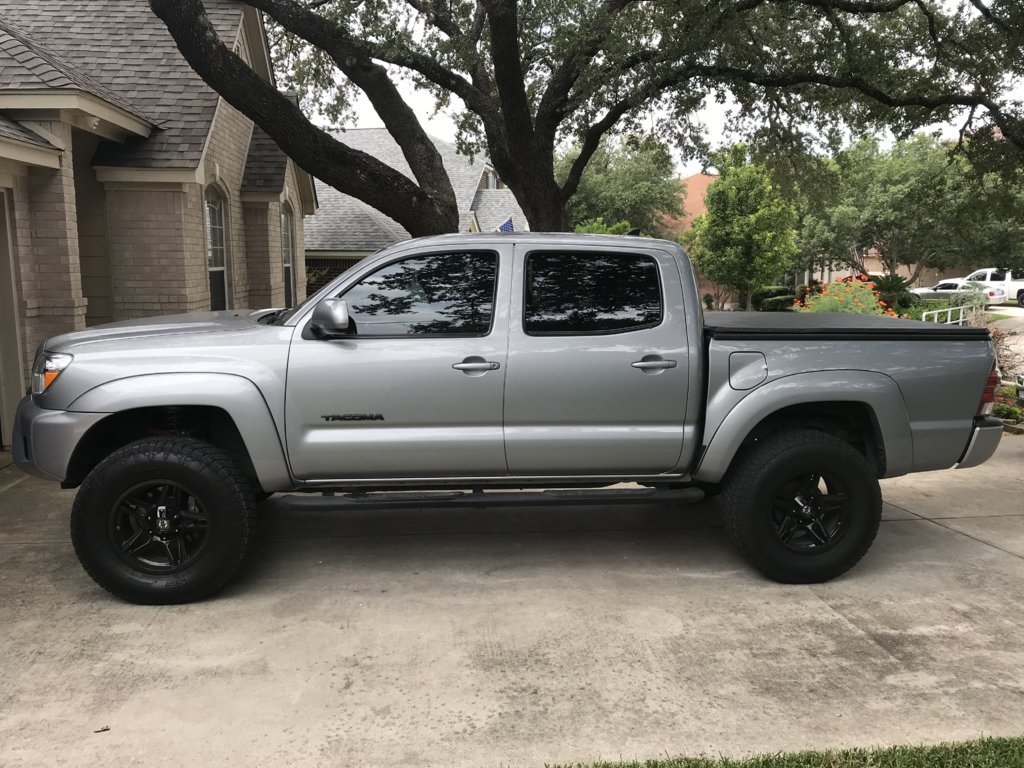

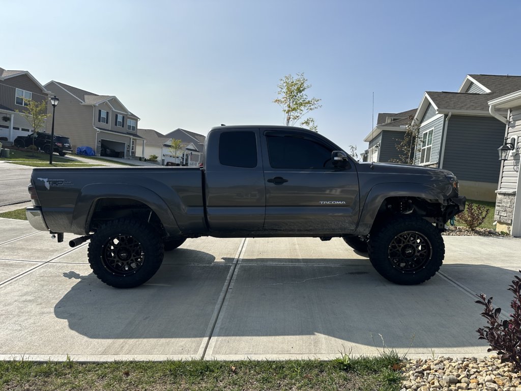

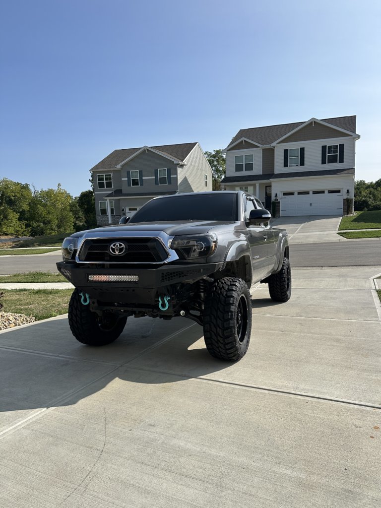

    3/2 on my prerunner with 285supload_2025-6-17_17-2-23.jpg

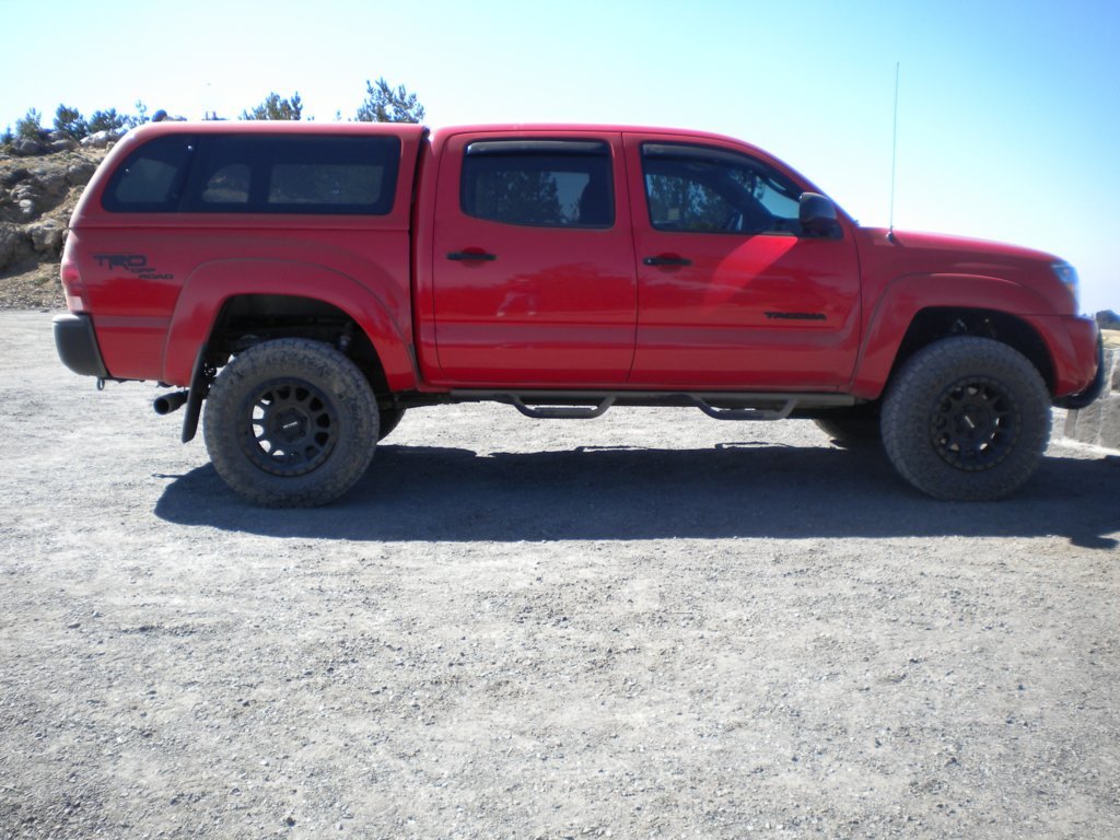

    Icon Stage 8, ECGS Bushing, Timbren ubolt flip, Crown extended brake lines, Overland Custom Design sway bar links, rear differential breather extension, oil filter drain hose, a/c drain hose extension & reroute, front windows tint, Cat Security, XPEL headlight/fog & grill protection, OEM block heater, RCBS illuminated 4X4 switch, Weathertech mats, Wet Okole seat covers, Sherpa Grand Teton/Crows Nest, Baja Designs S8 light bar, Diode Dynamics SS3 Pro fog lights, Piaa driving lights, Method 305 NV Double Black, 275/70/17 Toyo R/T Trail.
    Method 305 Double Black 17x 8.5 4.75 bs/0 offset
    275/70r17 Toyo R/T Trail
    Icon Stage 8... 2" lift front/back (coilover's at factory height setting/RXT leaf pack at option 2)
    Had to trim mud flaps (removed area in front of cab mounts and used a heat gun to tuck under.)

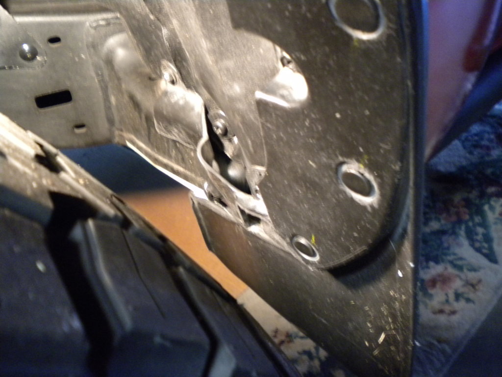

    I’m getting rubbing on the cab mount, just ordered a chop kit

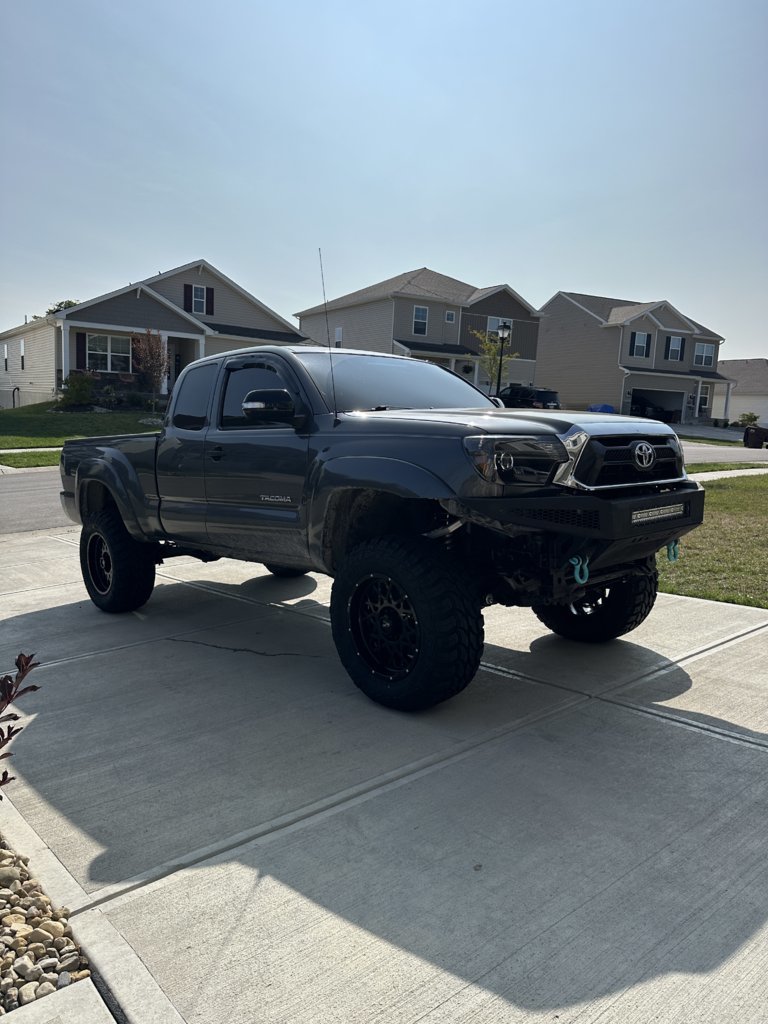

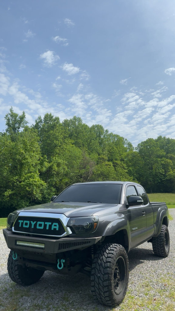

    Rough Country 3.5” lift, with 18x9 Vison Rockers -12mm offset wrapped in 33x12.50R18 Red Dirt Road MT’s. No rubbing whatsoever even at full lock and articulation with the wheels stuffed in the wheel wells. No CV angle issues/cv boot slide mod along with CVJ Extended travel Axles. And still rides better than it did when it was stock.

    I had to do chop, pinch weld, trimmed a bit of plastic.
