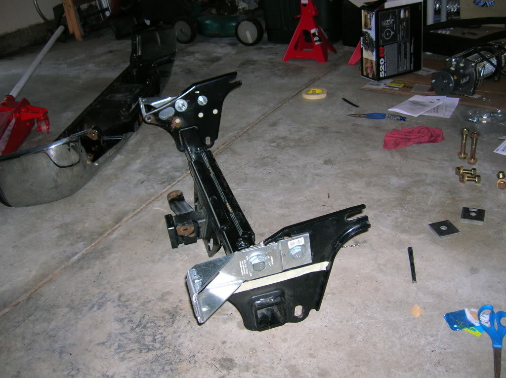

    Actually, I got a lot of SH*T over at TTORA for them, but they've worked so far . . . I have used them. I'll attach some pics and explain what I did. First, I put 4 angled steel "L" shaped pieces together--bolted together, then welded together . . . then I cut one end to round off the shape.

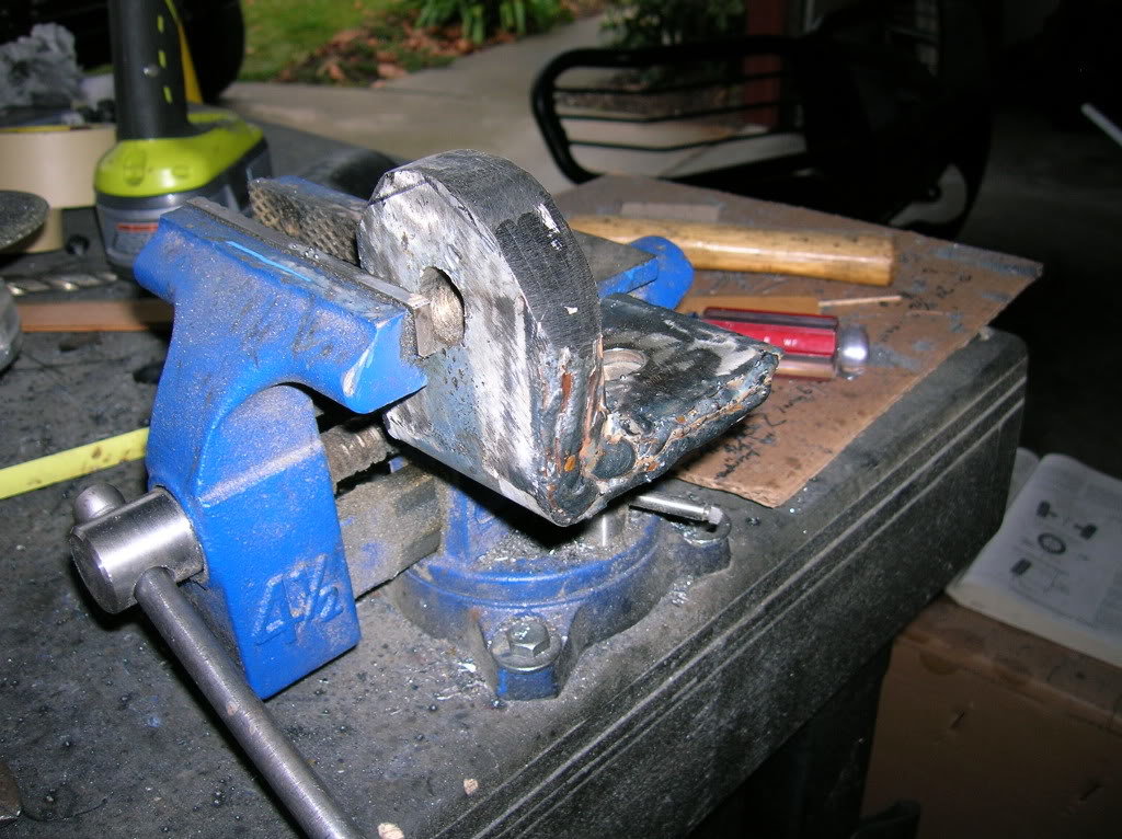

    Then I bolted, then welded the thick "L" shaped piece to a construction anchor "Strong Tie" seen here:

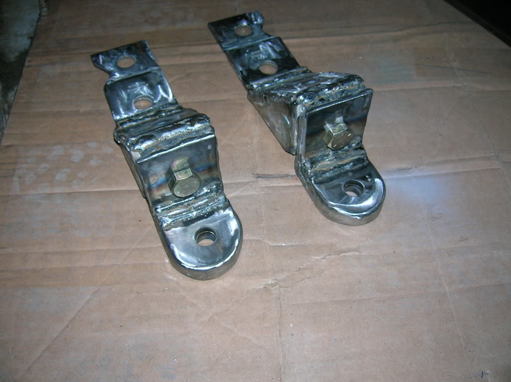

    Finished piece looked like this:

    Oh god not that death trap again

    The part that connects to the frame is a Simpson HDA 5A holddown. Probably the biggest unknown for me is the Simpson Strong-Tie. Allowable loads for HDA Holdowns have traditionally been limited by the calculated value of their stud bolts, which are going into 6" wooden beams.
    Conservatively, each one will accept over 5,000 lbs in tension with a factor of safety built in. Clearly that's not enough by itself for winching, but if I connected both to a winch, that's over 10,000 lbs with a factor of safety on top of that. As long as the winch pulling is rated less than that, the winch would give out before the anchor points. Maybe I should have used the HD7 or 9 (another 1 or 2 thousand lbs per side).
