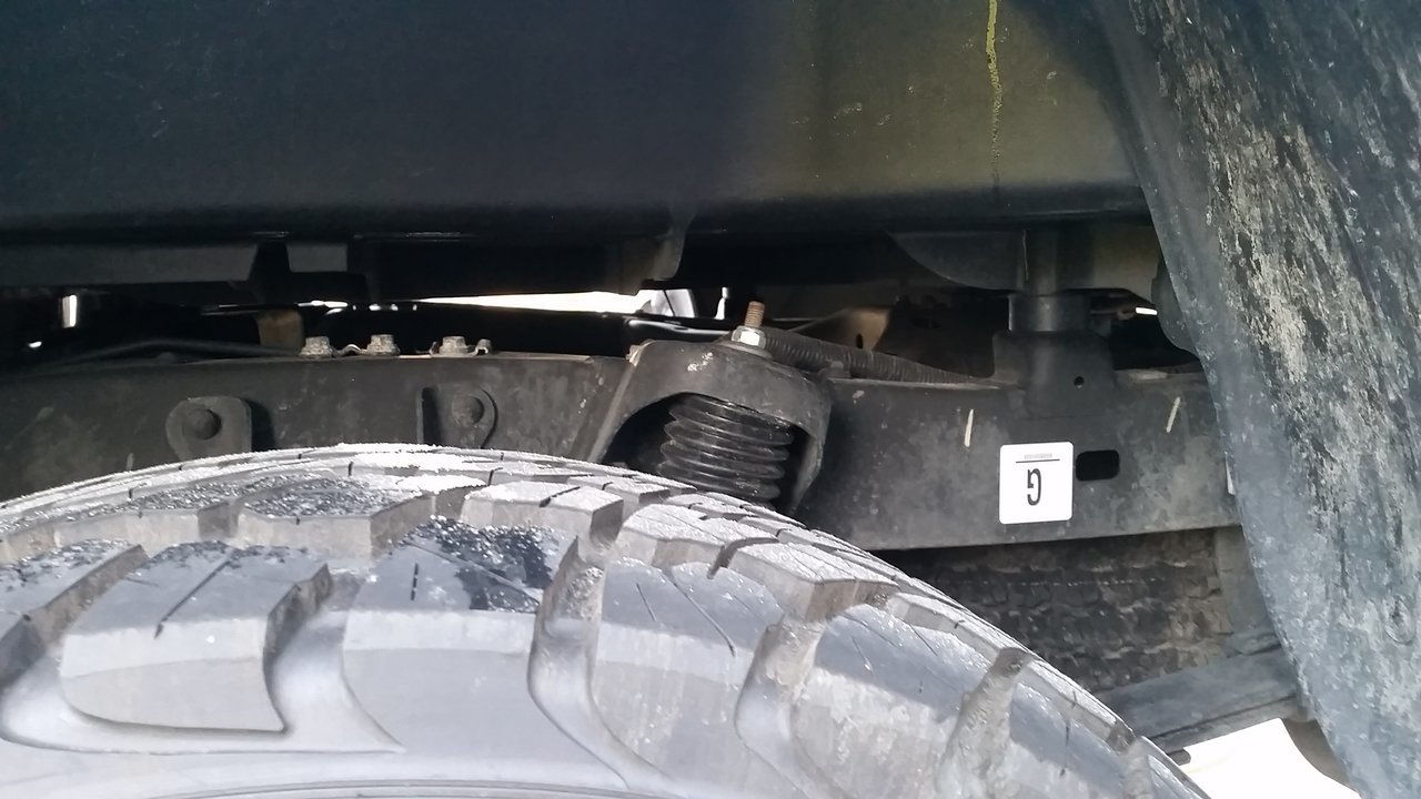

    Body lift won’t give you the extra clearance. Your cab mount will still be in the same spot.

    Ok well that clears that up, prob just do 285/85/16 than

    Yeah, 35's require CMC, your not getting around that.

    Body lift does help with tire clearance. At least it helped me. Cab mount isn't the only place 35s rub. They rub on the fire wall and even on the top where the battery is that's where body lift help.

    That is true that’ll give you clearance above the cab mount as well. But then you’re screwed if you want to put an aftermarket bumper like Pelfreybilt, etc. you’ll have a 1” gap unless you do some custom work to make it fit. I plan to run 35’s later as well but will probably just bang in the pinch welds, trim a lil bit of the plastics and get my caster to 3+. I already have a CMC. My buddy did the same thing has has no issues.
