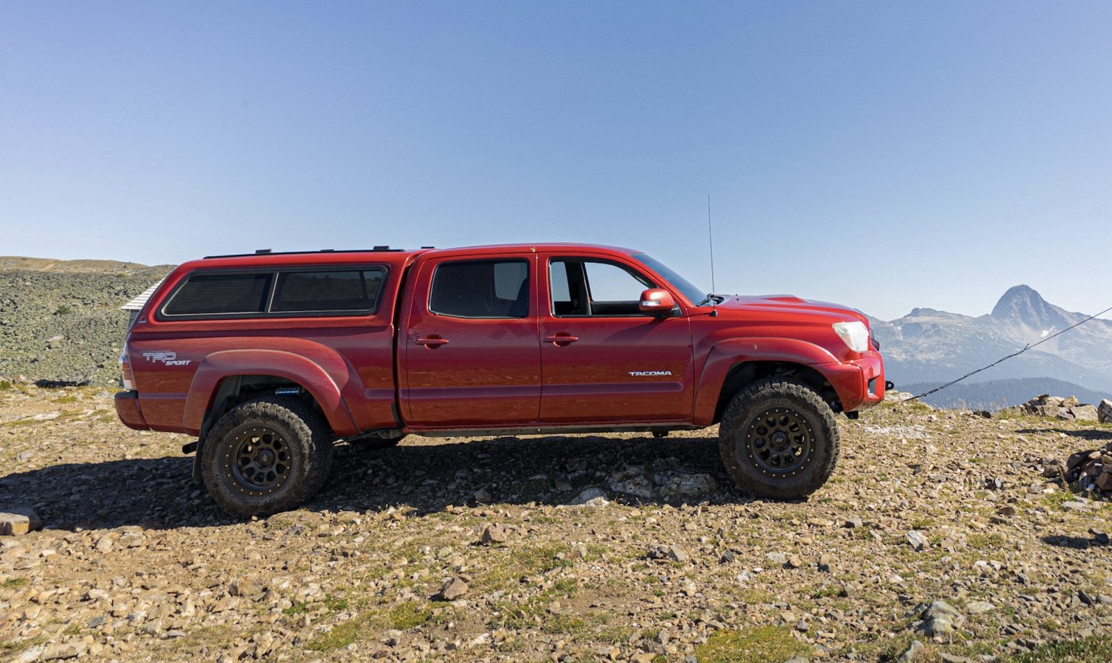

    - ICON UCAs, BP51/Kings, SCS wheels, 285s, Leer 100XR canopy. Greenlane aluminum winch bumper, Smittybilt X20 winch. Trying Falken AT3w now, Really like BF KO2s.
    I have taken the route of facebook marketplace for my lift. I picked up new Kings - 112s for the back end off a guy who changed his mind on his build, saved some cash. I have been running the Icon mini leaf pack as well for an 1 1/2" lift in the rear. I bought some used but like new OME BP51s for the front, so far they have worked great for me, been on for a couple of years now. I bought some like new ICON UCAs with the delta joint for $300 plus shipping from a guy in Oregon. For tires I buy the take offs from the Jeep guys, they pretty much get 35s or 37s off the lot - you can save a lot of cash that way. I really like the 285 70 17 KO2s in C load, around 51 lbs. 60 mph speed limit I am around 20 mpg on the hwy 17 comb. I just picked up a set of Falken Wildpeak AT3s off a guy who bought a Gladiator Rubicon. They are way heavier than the KO2, I weighed them and they are around 62lbs in my garage for the same size 285 70 17 C load. I will say they are quiet on the hwy but they are porky tires!
    With a 3 inch lift I'd go with 34s or 35s, 33s might look small once you get them mounted.

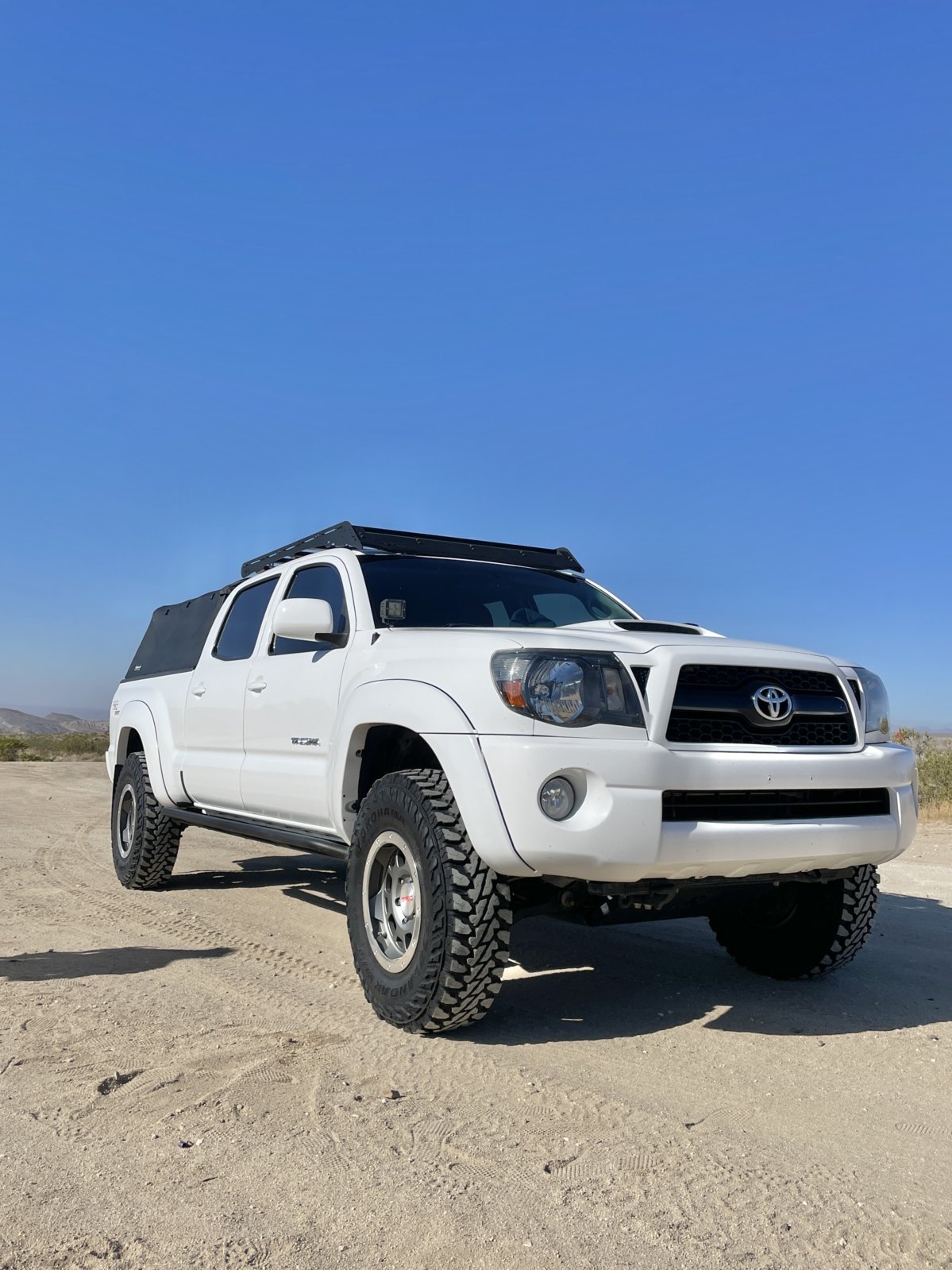

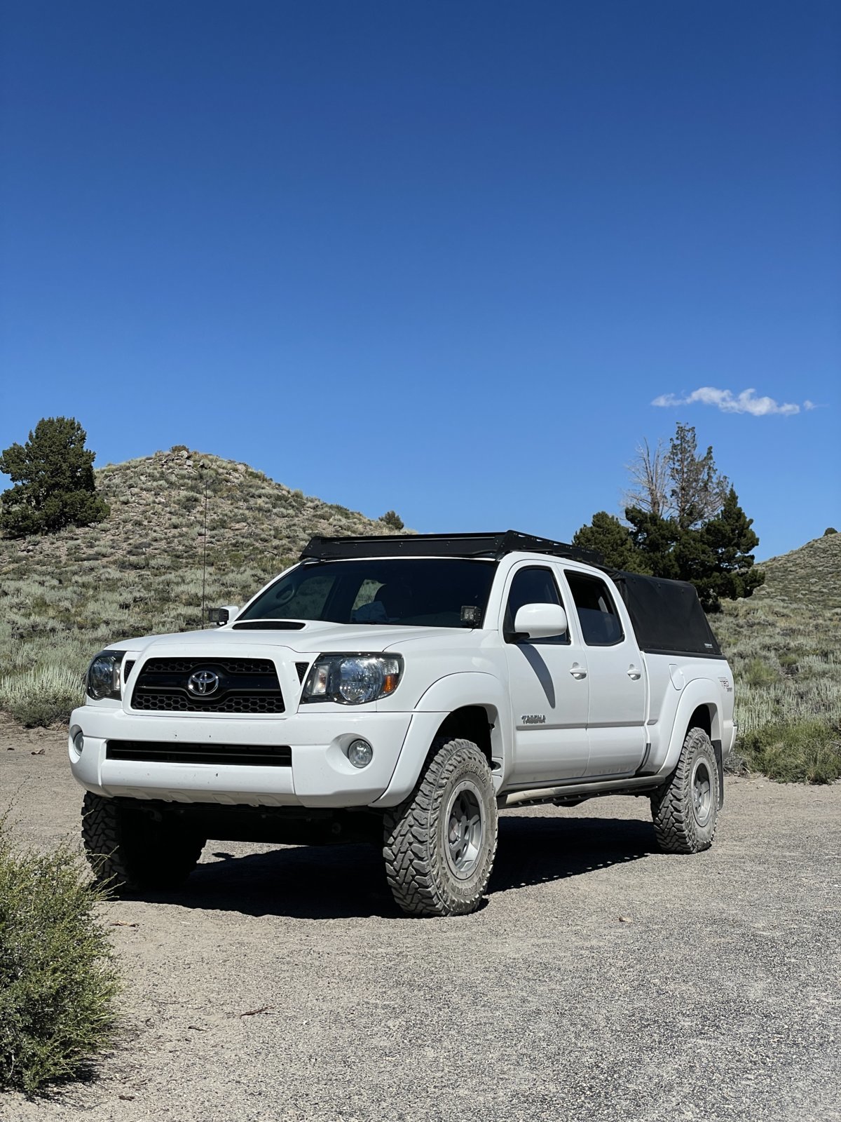

    Not sure exactly what the lift amount is since it’s been on so many setups but probably 2-2.5” in front (TRD Pro Bilstein with Toytec Baja spacer) and 2” in the rear (Headstrong AAL with overload left in). Tires are 255/85R16 on 17x7.5 +10 TRD wheels.
