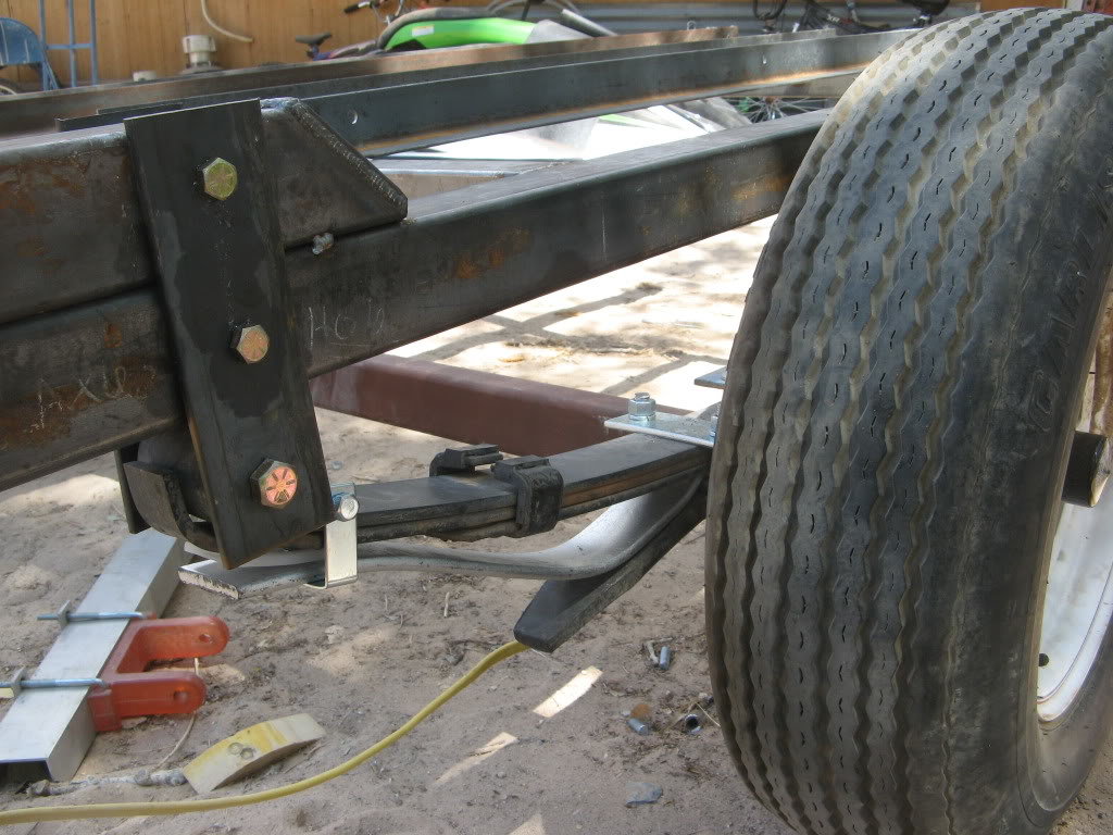

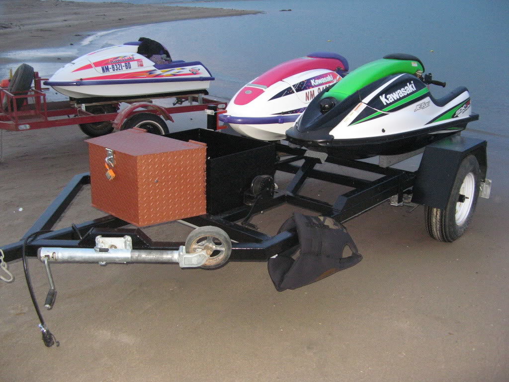

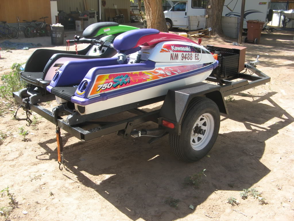

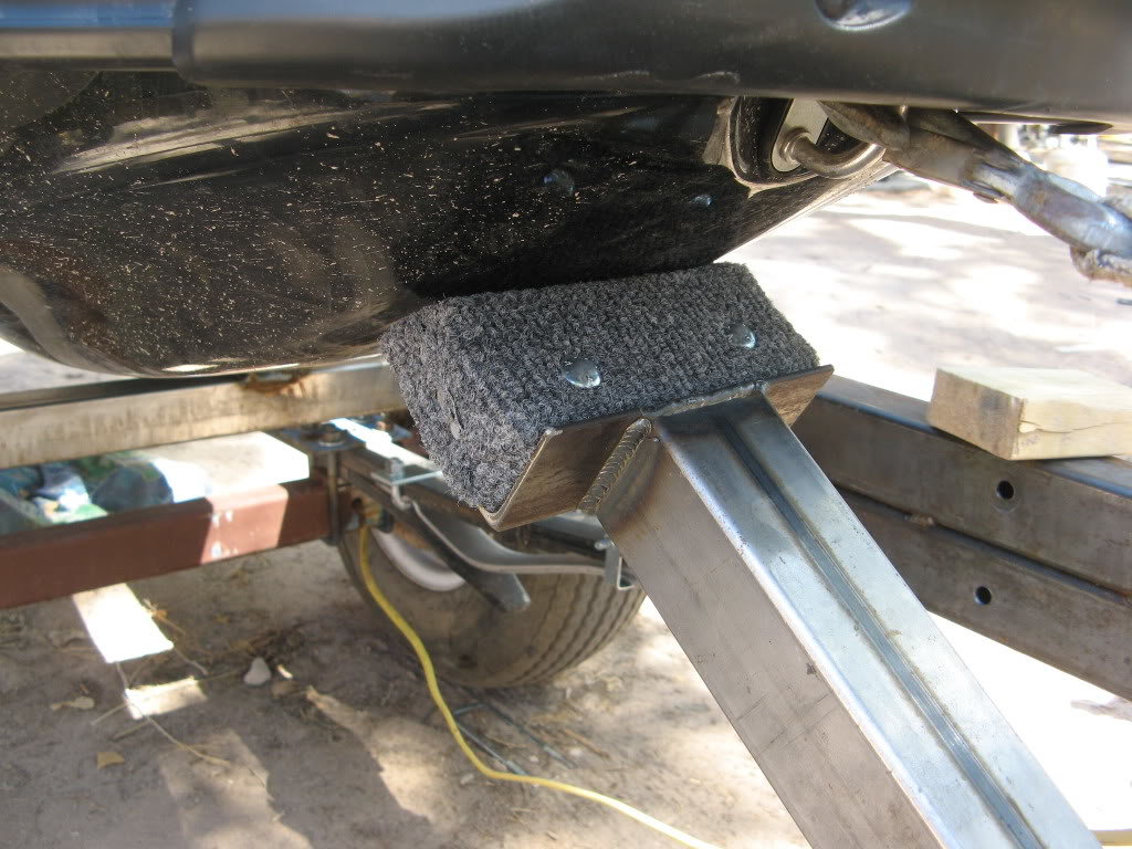

    not quite what you're looking for but I built this jetski trailer last year. 2500lb axle on my old taco leaf springs. Custom hangers and shackles and flipped overload leaf.
    I would use stiffer springs than the taco ones if I were you. This trailer when loaded is pretty spongy.
    these are all old, before I flipped the overload. Notice the helper springs that didn't help anything.
    The position of the axle is adjustable (hence the bolt on design).

    I didnt see any shocks in the pictures above.... they might help with the spongy feeling.

    yep, that is actually next on the list. My brother and I took it all the way to OKC this summer and it definitely rode nice on the freeway, but once you hit the whoop section also known as I-40 going into OKC, it wasnt so nice. There were a few marks inside the fenders where the tires made contact.

    yeah looking back I should have done that. But I was able to return the helper springs and flipping the overload actually stiffened it up a lot. Im going to throw some shocks on there (also free) and it should be good after that. Plus now my trailer is 5% taco:D
