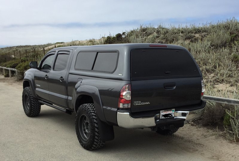

    285/75r17. No rubbing after cab mount chop and lots of fender flare and bumper trimming.

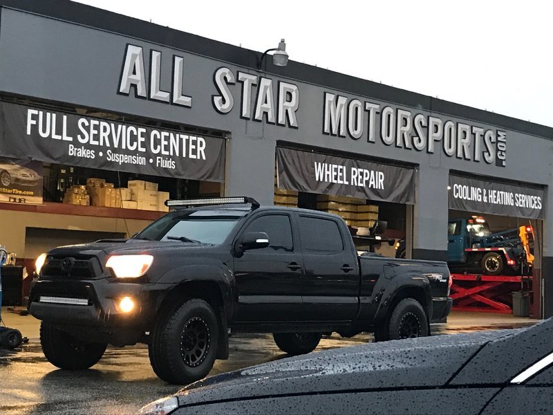

    New Tire Size bump up, from 285/75/16 to 295/75/16's.FullSizeRender.jpg Prob 2-3/4" Lift on the King Coils. OME Dakars Full Leaf Pack Prob a tad higher than 2-3/4", or maybe it settled to 2-1/2". I need to trim the front fenders for sure. some at the top, the tire hits there when i get full compression,.. and off course ill need to get the CMC and pound in that Pinch Wield. I think after i do all that,..I will be GOLDEN!

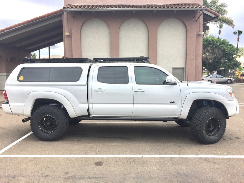

    OEM UCA'S. No diff drop. No cb drop. Rides great.
    She's filthy, but it's the most recent one I have.
