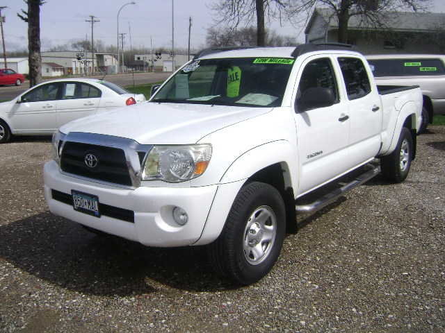

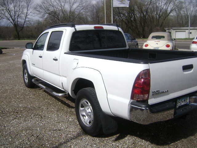

    06 white sr5 double cab long box
    Alright boys here's my new 06' sr5 double cab long box.... I'm open to any and all suggestions. Basically guys you get to pick how I should build her up. Mostly a daily driver, however live in Minnesota so lots of winter, hunting, fishing. And want to try not to lose to much mpg.
    List of what I'm thinking lift, tires, hood cowl, topper, camo wrap or graffics, different side steps, window(smoker) drip shields, front bumper, floor mats, seat covers, mud flaps, fender flares(after lift&tires.IMG_3267.jpgIMG_3265.jpg

    @HeadStrong Off-Road for the lift. 5100's with 887's and Dakar leaf pack.
    Don't go bigger than a 265/75/16 if your worried about mileage.

    ^^^thank you!

    Did you get the extended 5100s or standard for the rear? I have the standard length right now and I'm trying to make sure I'm ok with getting Dakar

    I went with BP51's all around. It's possible to go either way though. With standard they will become a limiting factor in axle droop. But you won't need to worry about longer break lines and what not.

    Thanks. So basically what your saying is my rear will end up in the air more when offroading? If I get extended I have a bit more play?

    Correct. Though its a lot more play.
