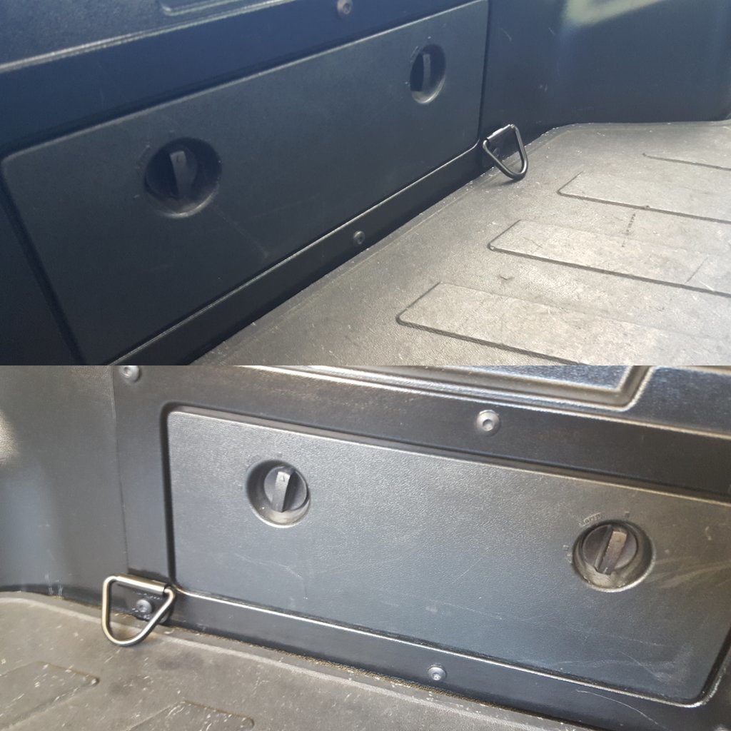

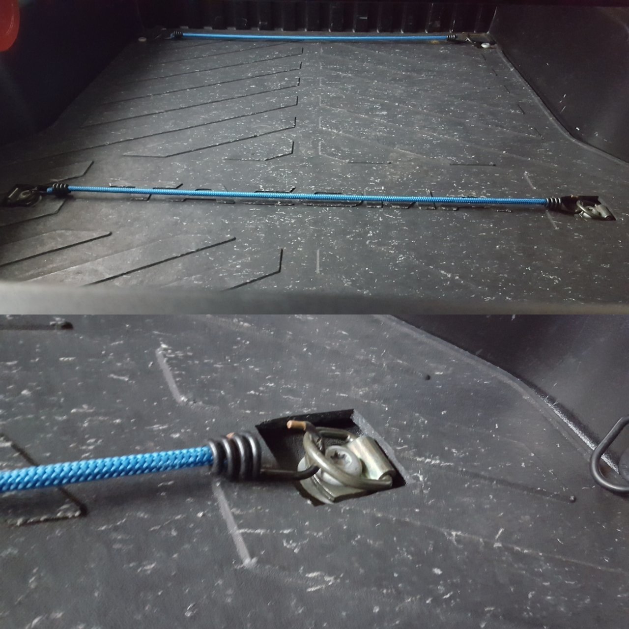

    Old pics but here's my tie down setups.

    Where'd you get the ones that the bed bolts go through?

    Let me see if I can dig it up. Was an army surplus store IIRC

    I think I remember those. Did you have to drill the hole bigger?

    No, just pressed off the washer off the bed bolt and install.

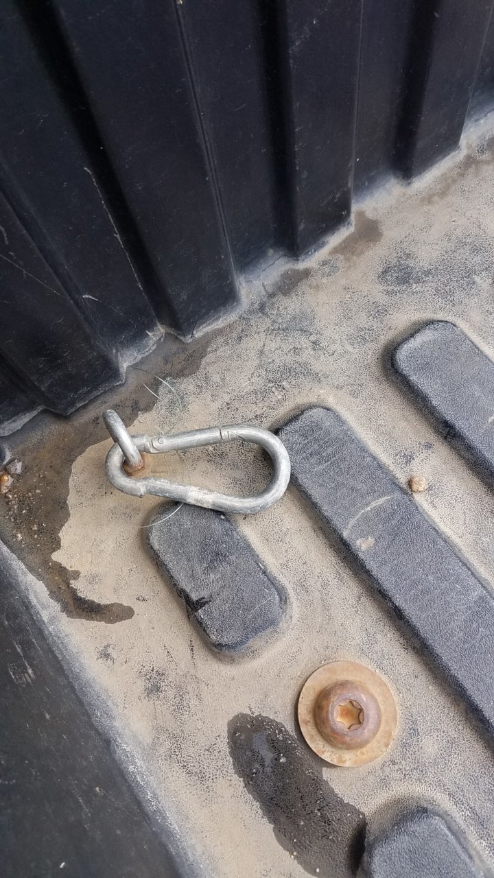

    The only thing i strap down is the front of my kayaks. If I ever start hauling heavy shit, I'll pull the bed bolt and use different rings.

    Cool, and the bed bolts fit right through the stock hole?

    Yessir. Just had to remove the factory washer on the bed bolt.
