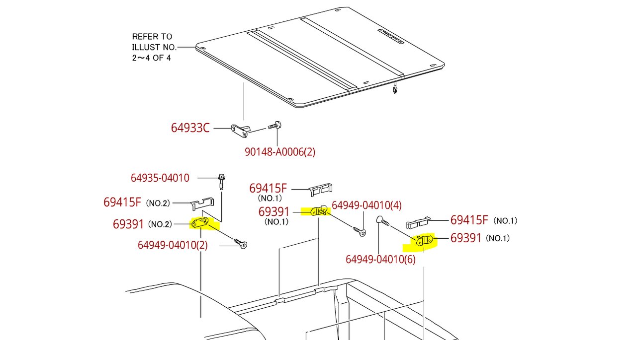

    Here is the exploded view of the parts in a kit. The highlighted items are what you need. You'll also have to cut your cap rails to accommodate the posts. I'd give the clips a wide berth. Perhaps 2" to either side of each posts and all the way to the top of the plastic cap.

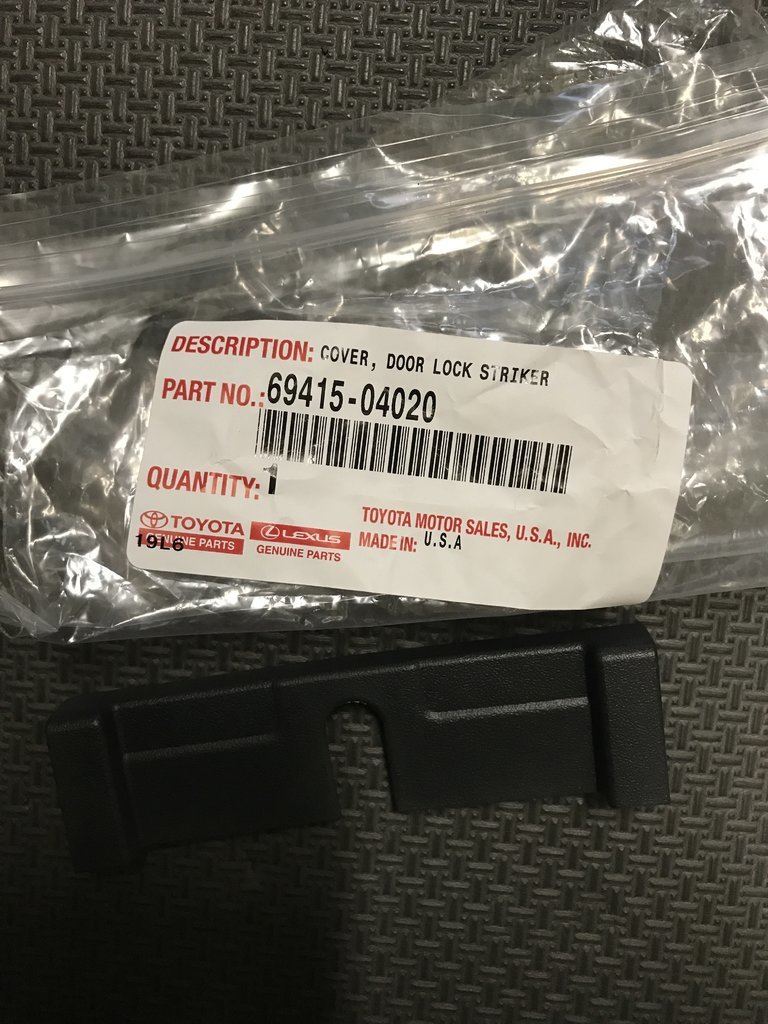

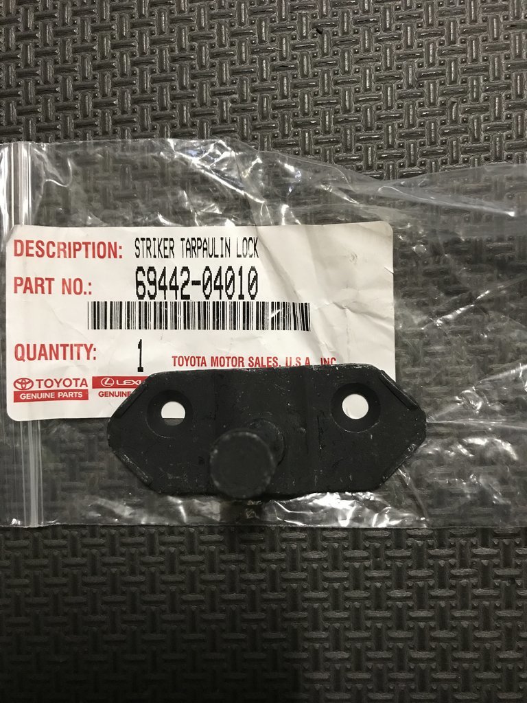

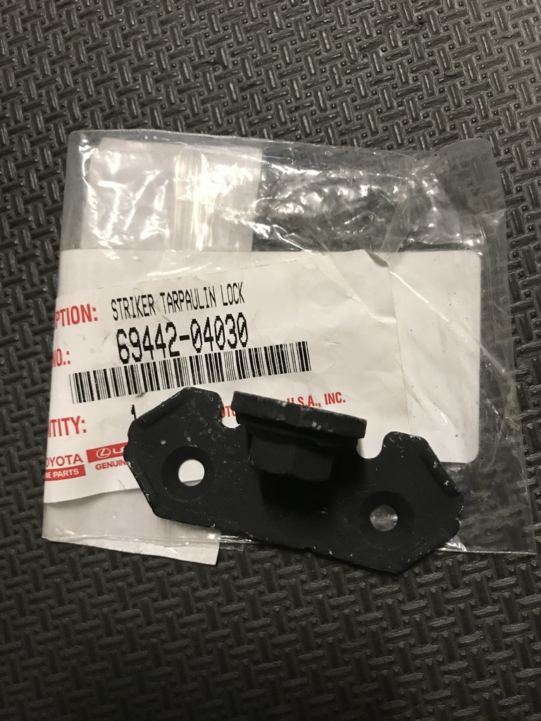

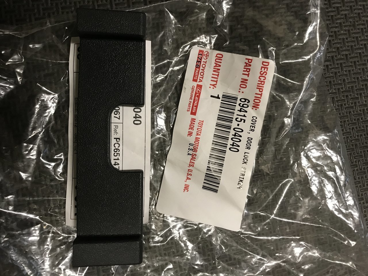

    Posts and post covers:
