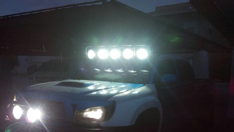

    URD TCAI Wicked Flow 18" 2 10in alpine type r 1500 watt amp MB 72 matte black Custom Bumper Debadged Glassworks fenders McNeil bedsides Helix TB Spacer Intake Manifold Spacer Custom Roof Rack 5x 55w HID SK2 projectors 55w DDM 5k Bulbs Camburg Long Travel Fox Coilovers
    Im running 55w ballasts and D2S bulbs no additional "splice" and they run perfect. If you buy the PnP it comes with a wiring harness that runs off the battery.
    I have a buddy that has 55W PnP in his FJ....holy hell they are a bright blue mess and super bright with tons of scatter.
    I have 55w in a SK2 projector so its a lot less harsh on ppl then just PnP....
