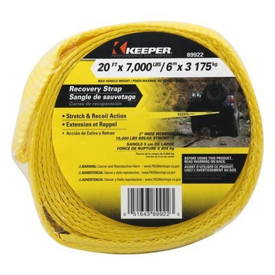

    I have a few of these in my truck:
    so even if it claims to have "stretch and recoil" they must never be yanked? honest question btw

    Only tow with a flat tow straps.(edit with non kinetic properties).
    Only yank with a kinetic rope.
    I have both. Different tools for different jobs.

    Snatch straps don't only come in the form of a rope.
    Some snatch straps are flat as shown above.
    Simply put, use straps/ropes as described by the manufacturer.

    snatch straps and kinetic rope aren’t the same thing.
    There is a lot more shock in both vehicles with a snatch strap. They’re only rated for less than 5 pulls by most manufacturers. They’re more prone to failure or breaking and bending recovery points.
    I won’t yank or let anyone yank my vehicle with a snatch strap. Technology has improved and I’ll stick with yanking with kinetic rope.
