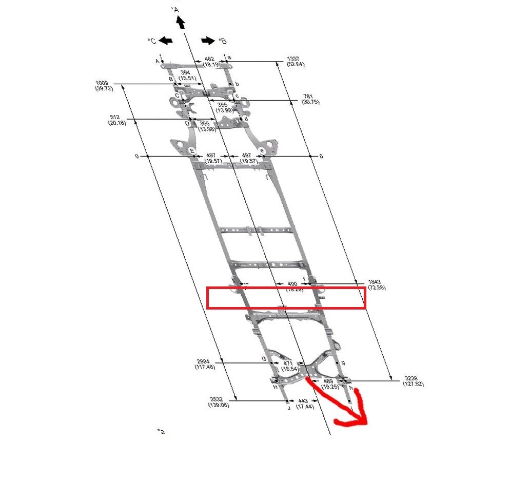

    I would think as bed gaps are notorious to be off from the plant.
    But... let's play a game alright?
    Let's say the pull bent your frame to close the bed gap by 3/10's. Let's assume that the pull happened five feet (60") back from your bed gap.
    This would give me a triangle with an x axis of 60 and a y axis of .3. Let's solve a triangle!
    The answer is around 2.5/10th's of one degree of bent frame.
    Now, lets figure out what that would do to the truck... Pretty much the only thing it could do is maybe scrub the tires, so let's calculate that!
    The contact patch for your tire is about 7.5" long and 8.3" wide, so let's apply that angle to that contact patch distance.
    Contact patch will be skewed three hundredth's of an inch lol.
    I am going with no frame damage and just a different bed gap!

    I see what youre saying with that assuming the position of the bed were to represent the position of the frame. but dismissing that I'm just speculating the frame could have done this type of deformation in the area encircled in the red box aft of the rear cab mounts and fore of the rigid "X" brace doing a rhombus-like shift:
    before anyone says chill out or whatever I am just speculating, I will take it to a frame shop eventually
