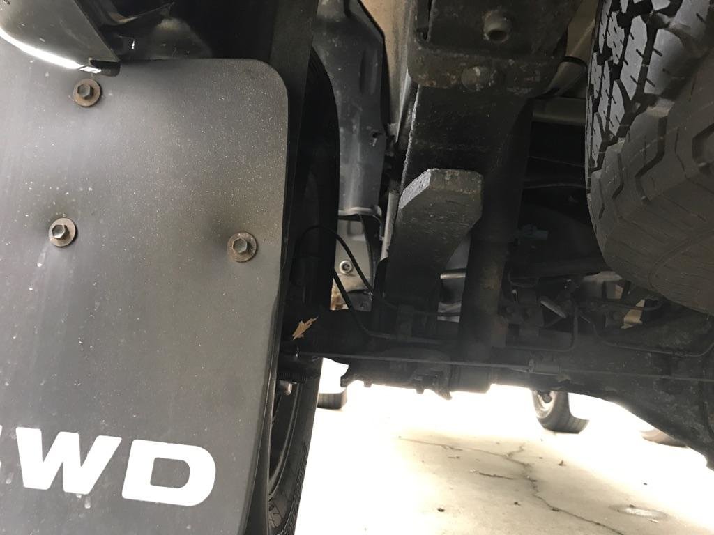

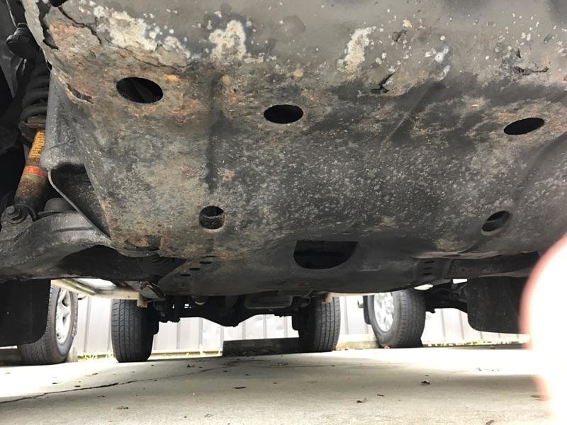

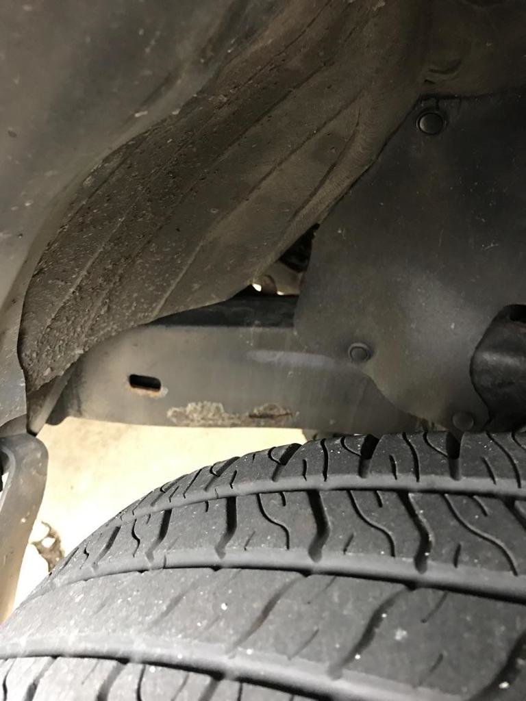

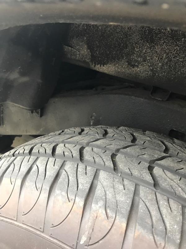

    Okay, i got some photos sent over and will have more coming hopefully.

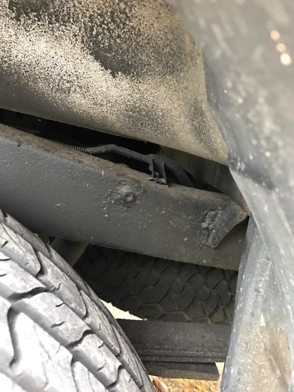

    Look at the last photo frame rail, is that rust?
    erik530195 and PROseur like this.
    That don't look good.

    You need to find out if this truck had the coating done by Toyota, if it did you may be able to get a new frame for it.

    Yikes
    Run away
    Now it makes sense why priced so low

    I'm gonna say pass this one up. If it looks that bad in pics it's gonna look worse in person.

    The last picture, near the middle, looks like bad rusting on the bottom of the frame. The front skid plate isn't trash yet but will be. It may not be worth a long trip to go see it, especially if that's rust in the last pic. Be 100% sure toyota will fix it if it is rusty before buying it, otherwise pass.
