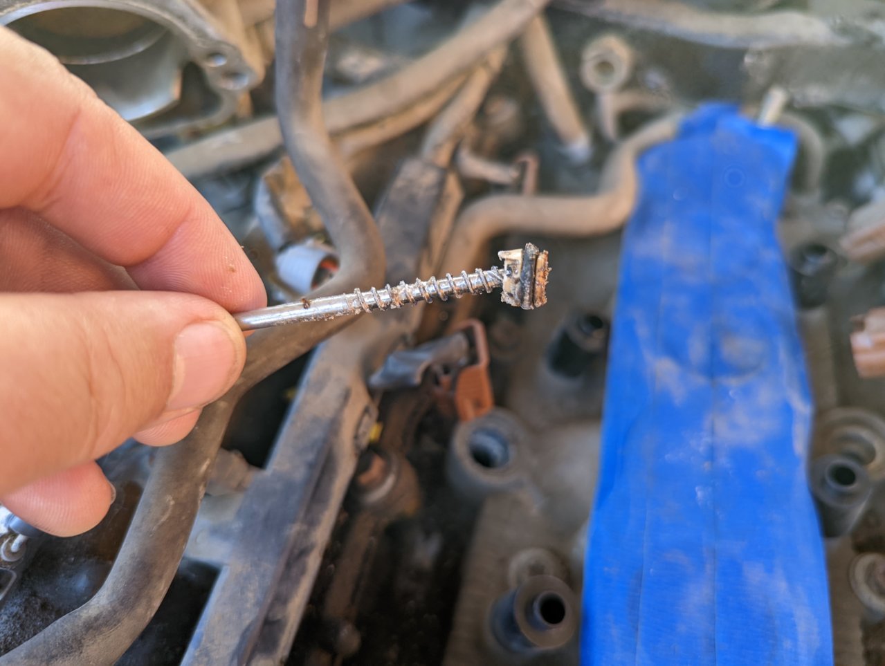

    Stuck the scope back in the hole and there are no broken bits and pieces of plastic/fuel injector. So, I'm ready to resume my fuel injector replacement job. What a relief! Looks like the preventive replacement of the timing belt is gonna have to wait.

    (and no stainless screws next time) :boink: ;)

    Or do the dental floss safety net trick. The square head in the screw saved me, as I don't know if the skewer would have stuck to the screw good enough, as it took a little fenagling to get the head through the hole. I was video taping it, but had to stop so I could grab the screw with my other hand, before I dropped it back in the hole. This is my first win so far on the adventure... granted it's one I created, but still a win! Let's hoe the reassembly goes smoothly, and she starts! That may be a day or two down the road, as I've blown off enough work today.

    The square head is called a Robertson by the way. For general purpose they beat the heck out of the Phillips head. Man, would I like to get my hands on that Phillips guy...

    Thanks! I didn't know they were call Robertson.

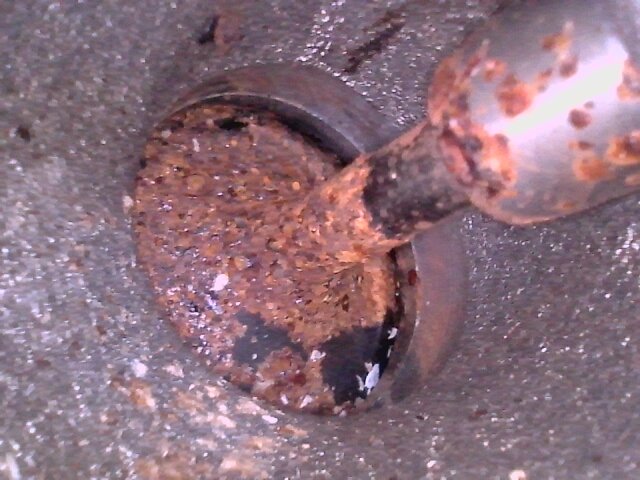

    I have not, but probably should. I have put this on the backburner, and haven't done anything in a couple of weeks. That does sound like a good test to perform. When I had the scope in there the rods looked all rusty, which I don't think is normal. I do have a couple things I want to try, like make sure there is no obstruction in the fuel line between the fuel filter and the fuel rails. So, I'm going to check for fuel and spark again, as while doubtful, maybe I didn't reconnect everything properly when I replaced the plugs and wires.

    The photo is from when you had the scope in the intake I believe -- that would be the intake valve we see.
    While not the best thing to see it probably won't prevent the engine from running.
    I believe you have cranked this over enough to know if the valves were actually stuck.
    DWero[QUOTED][OP] likes this.

    Yes, It has turned over lots, and lots, of times.

    That's a lot of foreign debris on the valves. It's possible they aren't sealing. A compression test will determine that.
