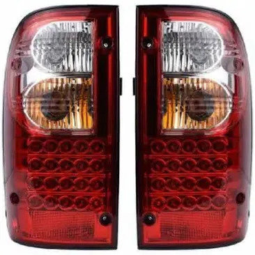

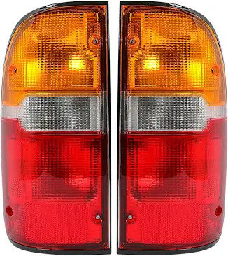

    Okay after some further digging on the hilux tail lights the bottom screw hole opposite of the side touching the tailgate is in a different spot so you would either have to make a bracket to attach to the original screw hole on the bed that has a screw hole in it for the hilux tail light or just run with 3 out of 4 screws holding it in.
  13. Dec 2, 2024 at 1:22 PM
    Double O’ Taco
    Double O’ Taco [OP] Well-Known Member
    Aug 20, 2024
    #455525
    166
    Paul
    2000 Tacoma V6 5spd 4x4 club cab sr5
    Lift, wheels, leds, grey wire mod, E150 rear springs, antennas, subs, etc…
    Hilux lights
    Tacoma lights
