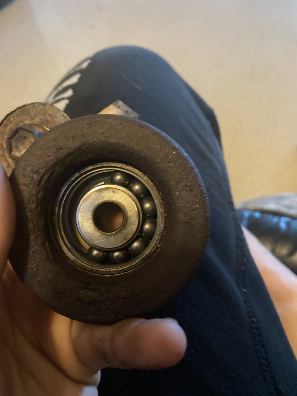

    The upper idler pulley threw a couple ball bearings and was the culprit Of the noise

    WTF, and the dealer said the engine was toast?

    Wouldn't be the first time, some "techs" are too lazy to do anything more than stick their head under the hood for a few minutes.
