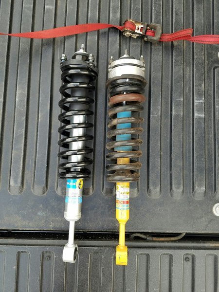

    Sorry I'm a little late to the circle jerk here but I'm a Big Island boy who grew up in Kona Town and moved to Hilo for work. I have a 2016 TRD OR DC My set up is the 2016 5100's with 2887 OME springs. I have 1.5 inch blocks in the back with Bilstein 5160s. I have 265/75r16 Kbro2s. After my suspension settled, I'm sitting at approximately 23 inches in the front (2 inch lift) and 23 inches in the back (1 inch lift). I do have a slight Tacolean but it's not to noticeable. With my set up I have done R1, R10 Skyline, Mana Road, Makalawena, and Manuka (haven't tried to get to the cliffs yet but maybe later this month), South Point (suicide rock), and Green Sands. I have done all of this without any trouble or bottoming out. Yes I can't go 100 MPH off road but it gets me where I want to go. The TRD OR suspension was ok, but I wanted more. It was too soft and the dampening wasn't good for what we deal with here on the Big Island. I'm very happy with my set up.
