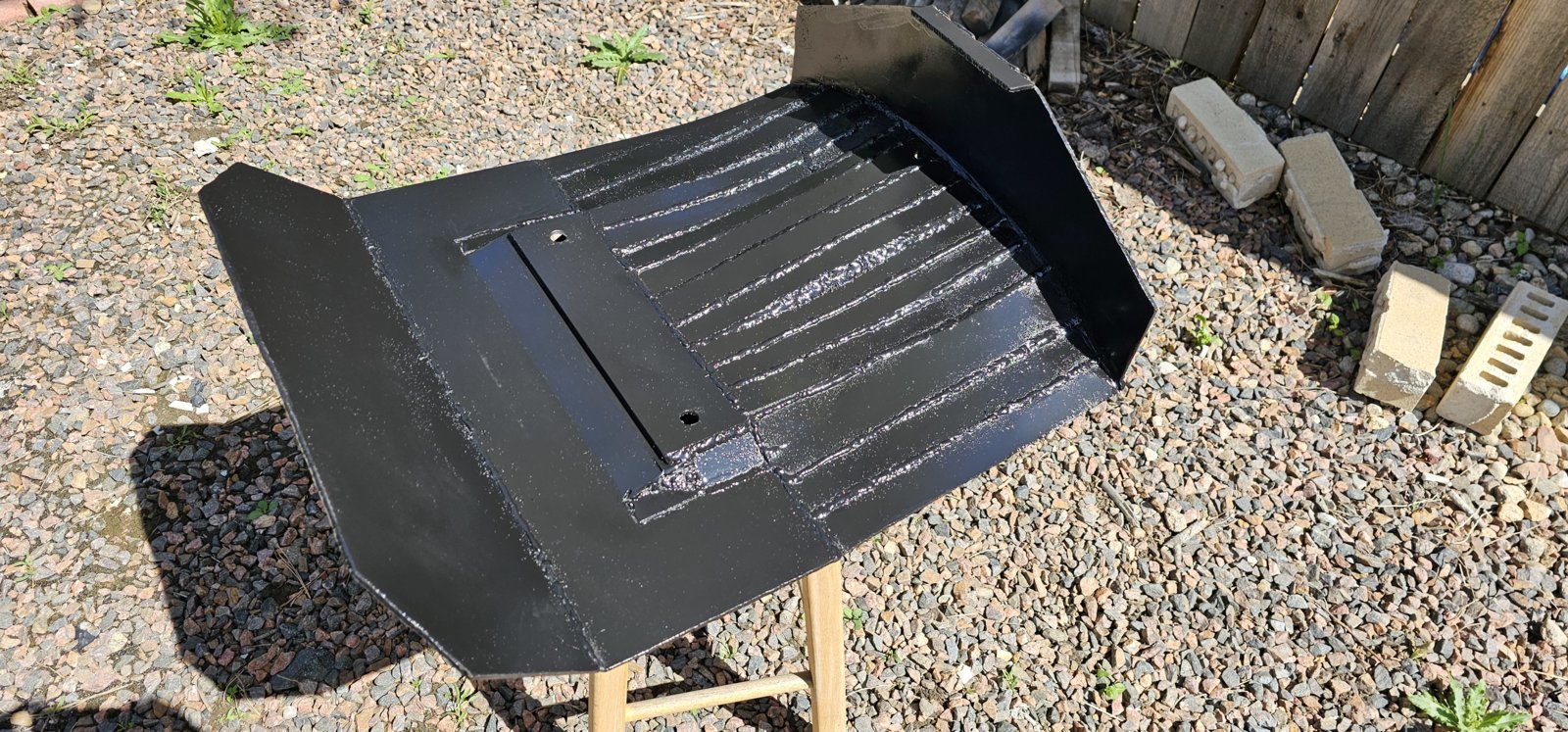

    When your skid is as pretty as mine, spray paint will do.

    Paint is the best rust proofing spray. Cheap, quick and easy. I also spray my motor and stuff down with WD-40 after a good wash.

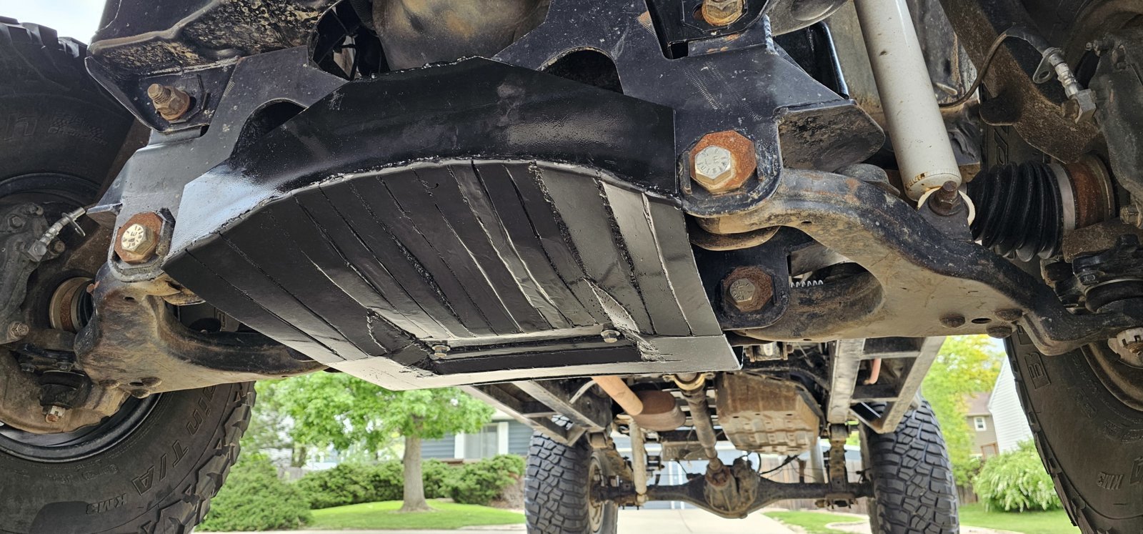

    I've been using that paint for a long time too, my go to spray paint for just about anything black. Currently on my sliders and front skid.
    In my use I have found that it chips fairly easy, and fades relatively fast. Even my front skid that doesn't see much UV has faded to nearly a flat black. To be fair, I'm not talking weeks or a few months, but it does fade.
