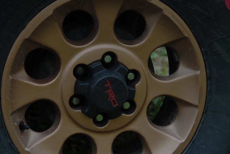

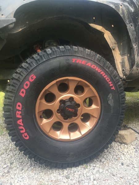

    This is my 4th set of painted wheels and the ability to touch up is why I keep doing it.
    To touch up powdercoat you have to remove the tire from the wheel and remove your wheel weights and get the tire mounted and balanced all over again with the possibility of the installer scratching the lip
    I toss some index cards between the lip and tire and wrap my brakes and lugs to prevent over spray and give it a couple coats

    What color is your truck ? and what color paint is that on the wheels ?
  19. Apr 26, 2017 at 10:15 AM
    #19
    Boogyman
    Boogyman Well-Known Member
    Aug 17, 2012
    #84975
    13,328
    Phoenix
    Corpus Christi, TX
    2022 Lunar Rock Trail Edition
    Black sand pearl Tacoma and "aged copper" wheels
