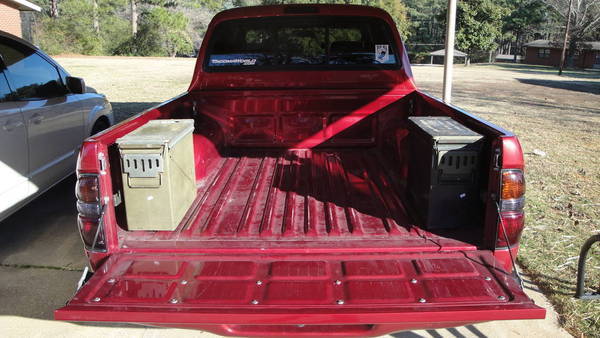

    I purchased (2) 20mm Ammo cans for storage in the bed of my truck. I was leaning towards buying a toolbox for the back; however I felt this method was cheaper and more practical for the amount of things I wanted to store. I plan to use "U" bolts on both sides to with locks to secure them.
    I've been quoted $50 a piece to have them Powder coated, which would entail me somehow removing the rubber gaskets under the lid(I'd like to keep them in for water protection) during the curing process (oven) of the Powder coat. Is it possible to remove the rubber gasket and reinstall after the powder coat has been done? I've also looked at line-x again $50 a pop and I'm not sure how the hinges/handles would be affected. Yes, I know I can simply sand,prime and rattle can them but I really don't want to have to unbolt them from the bed to reapply additional layers of paint. What do you guys think? Yes... long post, I know. Thanks. :cheers:

    I've considered doing ammo drybox bed storage for a while too. I would honestly recommend doing rattle can RustOleum Enamel. If you are patient and spray 1-2 coats per day for about 4 days, it will put a heck of a finish on them. Good luck with whatever route you choose!

    In my experience you can remove the gasket with a flat screwdriver or putty knife then simply peen the metal back to pinch the gasket. I Have done that numerous timed painting these cans and it works.

    The OP wants to take the cans apart then paint and reinstall gasket..yes it can be done

    I left mine as is but I would probably put rattle can bedliner on the boxes that way you can touch it up if they get damaged and it's more durable than regular spray paint.
