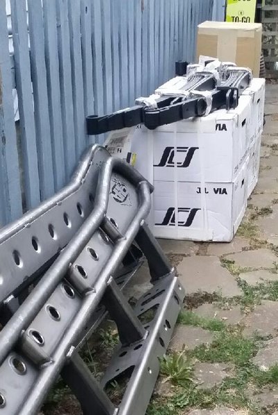

    I have a new set of rock sliders sitting at home waiting to be installed. My problem is I work on the road, have limited time at home and I'm starting to think I may not have enough time to get the coated before next weekend. Should I wait and be patient? Or are there any other products that I should diy at home that are comparable?image.jpg

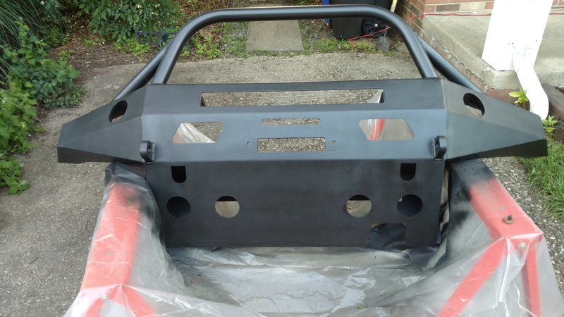

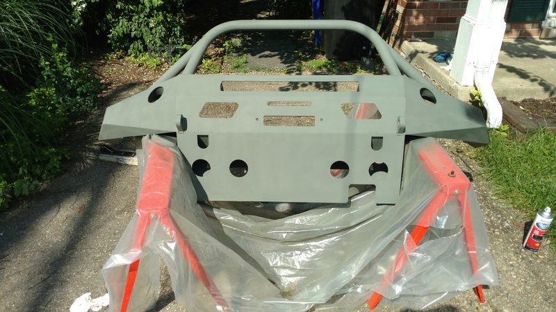

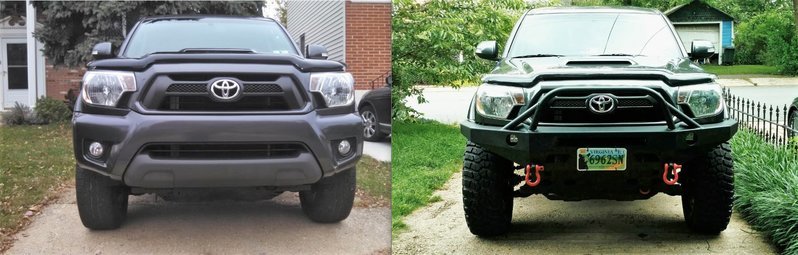

    I refinished a rusty used Pelfreybilt front bumper. Sanded it down, primed with rattle can Rustoleum steel primer, then painted it with Rustoleum bed liner. It's been super durable and came out great. Also, the sanding was by far the hardest part, and you won't have to do that in this case. That said, I don't step on it regularly, which you might want to do with the pretty fill plates on those sliders.

    I ended up using rustoleum primer and then rustoleum spray on bed liner and they turned out amazing.
