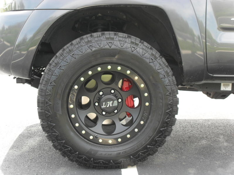

    carbon fiber blacked out grill ddm tuning hid kit 35w/55w bi-xenon kit ddm tuning hid fog light kit 35w m/t classic lock blacks fierce attitudes 285/70/17 5100's installed on front 2.5" rear TSB done masterlock tailgate lock 35% front window tint scangaugeII duplicolor red caliper paint
    I was going to get mine powder coated as well but didn't want to go through all the extra work with bleeding and having to take them off. I just got some duplicolor red and painted them a few coats. they're shiny and look good but you're not going to mistake them for a set of red brembos off of a 911 carrera.

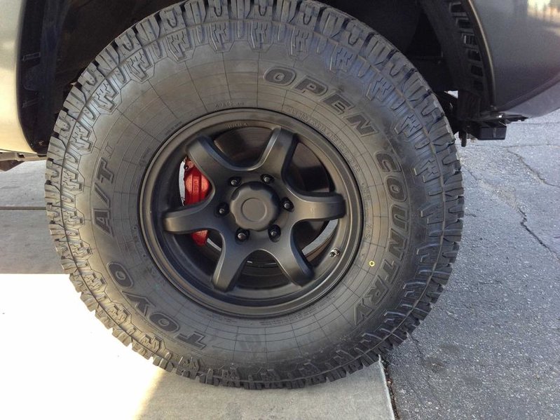

    Katzkins, Redline hood struts, Pop & Lock,285/75/16 Toyo Open County ATll, 16X8 Konig Countersteer, Icon extended coilovers, Icon rear shocks, Icon progressive leaf pack, LR UCA's, extended brake lines,
    I just painted mine. It turned out great.
