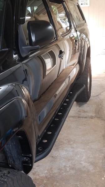

    I went to .... to have my slidders done. Skid's I would have rattle canned, but when I ordered them locally powder coating was included. A great surface to spray on if you want more than a black flat. So yes, I found out the price difference was because the skids came with a powder coating. I needed to do some small touch up on each skid. Still alot easier and consistent then my painting ability, and I saved time.

    Jumping in Pelfreybilt GB and ordering sliders and skids, I'll texture/rattle can the sliders and rust oleum the skids but if I was doing bumpers I would totally powdercoat them.
