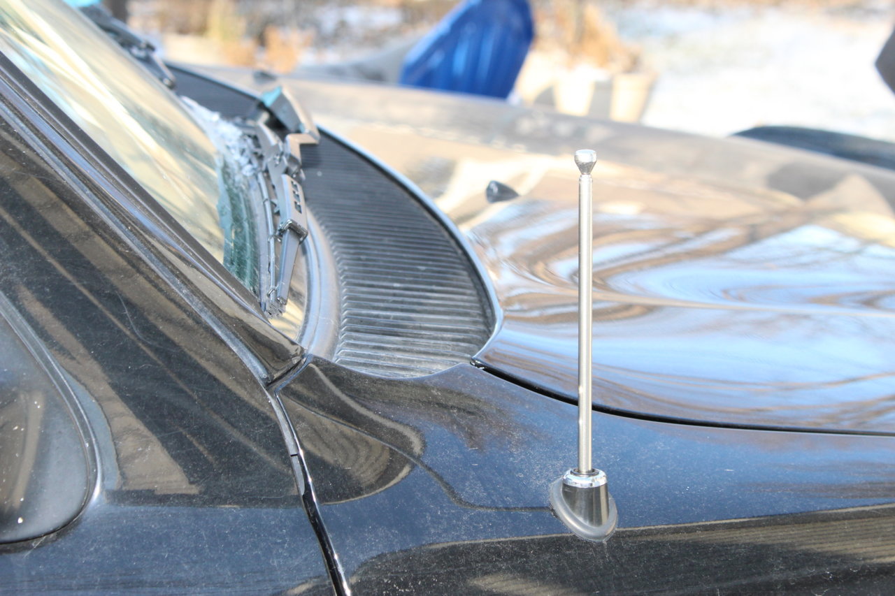

    ... have a little stubby the past couple of days when the weather got colder, it has been doing this haphazardly over the years, but usually has been from ice buildup as far as i know
    took about a dozen times to get it to fully retract turning this morning with radio off on off on repeatedly
    perhaps the mast is slightly bent :notsure:
    occasionally i do not have the garage door up far enough and catch it on the top backing out or going in over the decades which may have put wear and tear onit
